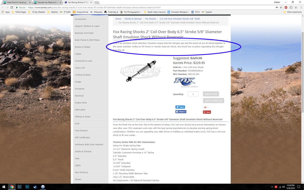

    There are slight differences in the shocks, the link and descriptions show the emulsion shocks you're referencing and the Monotube/twintube seperate shocks he's referencing.

    The difference is he said emulsion monotubes don't exist when they do.
    I never said internal reservoir shocks don't exist.

    Sandman614's post from shocksurplus.com nails it down. No one refers to monotube shocks as emulsion.
    https://en.wikipedia.org/wiki/Shock_absorber#Mono-tube
    I cant think of a single vendor selling direct fit emulsion shocks for a tacoma. Some of Icon's shocks are listed as emulsion on third party sites but icon's site says they arent.
