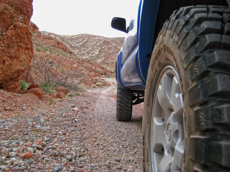

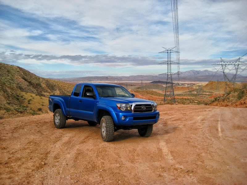

    Of course, everyone likes pictures, so here's some obligatory shots of my commute on the way from my house to Lake Mead (POND Mead, rather.) And yeah, this is still in Las Vegas. Some locals might recognize the route. I could drive on the roads to get there, but wth is the fun in that? Right?
