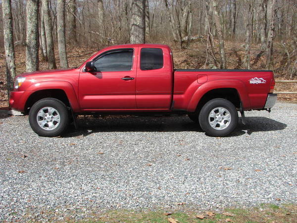

    Eibach coils, Bilstein 5100's at "0", 1/4" leveling spacer on drivers side and rear TSB.

    Judy, I got the coils and spacer from Toytec on this site. If you go to the vender section you can send a PM and get a forum discount. 5% I think. It's funny you say your following my lead, I think I'm going to get the gunmetal FJ rims before I change the tires. Just waiting to see a picture of yours when you install them! The trucks are close to twins.:woot:

    Looks great!:thumbsup:
