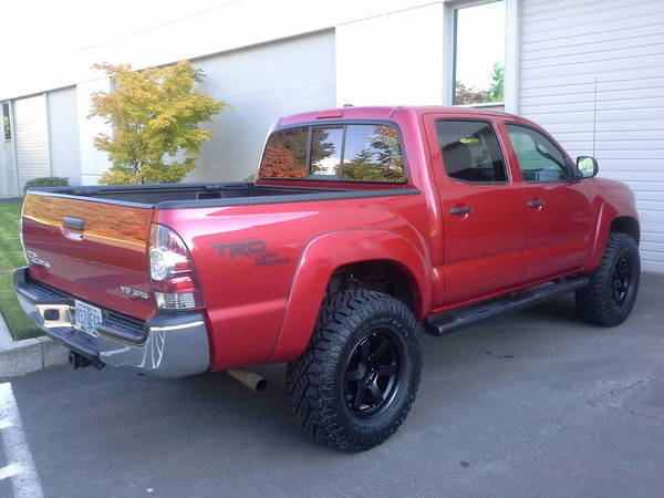

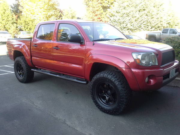

    I am running the exact same set up. Rides great, no complaints

    Brochacho- nice truck that's the stance I'm looking for
    Canazes9-- thanks for the input ..and i agree with you but I'm on a college kid budget...just keepin it simple for now....would the ride be smoother with the spacers and bilsteins at 0 rather than no spacers and bilsteins at .85???
