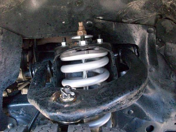

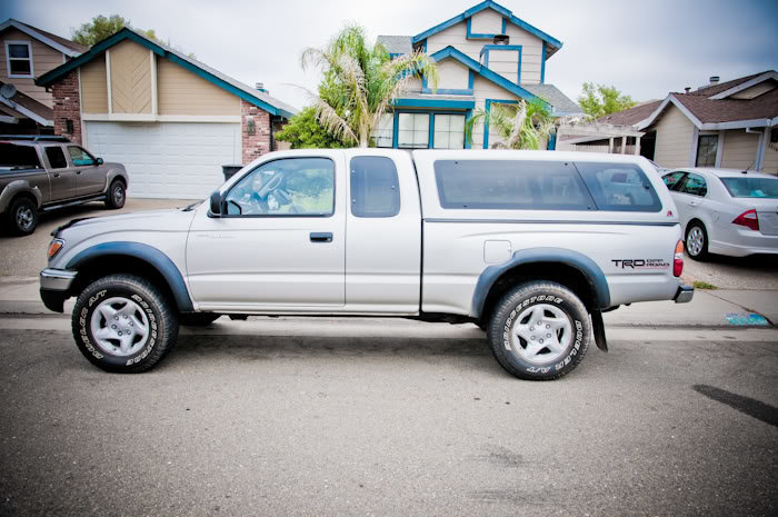

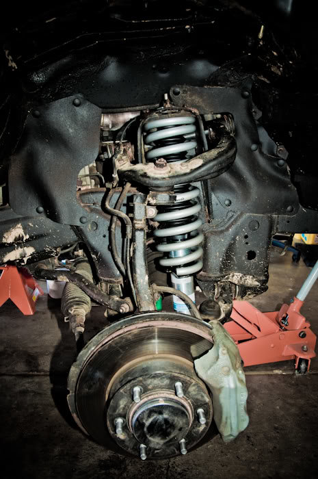

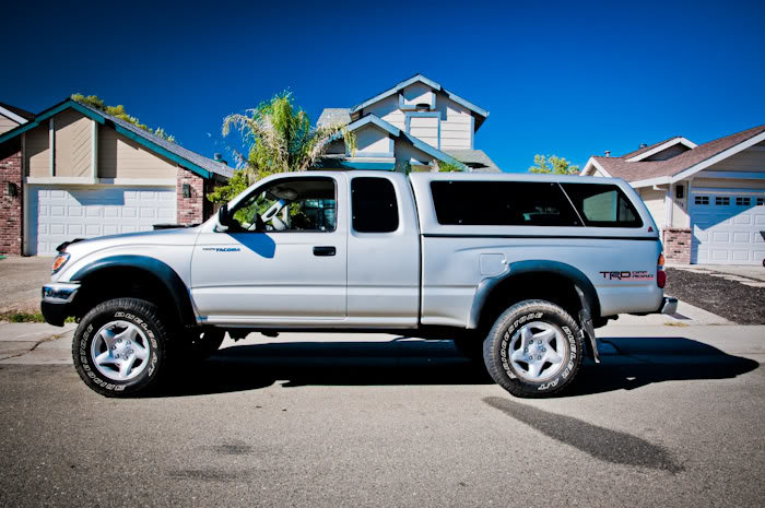

    Well here's the day I installed the 5100's and Eibachs and My AAL.
    Before
    After

    Looks good jerry! Have you noticed any wear or parts breaking because of the lift?

    No breaking but I have noticed marks on my upper CV boots from the fins touching. I don't thinks it's that big of a issue it's just a clean ring on the boot where rubber has contacted rubber. If I do ware out a boot I don't think it's going to be anytime soon.

    Nice !!!;) So what was the end result ? Was it the 3" lift that Eibach/Toytech claim to provide ? (this is the route I'm prolly gonna take);)
