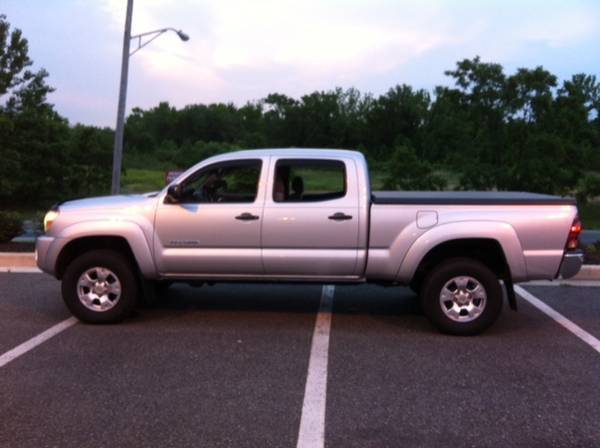

    I have Eibachs on 5100's set at 0". I added a 1/4 Toytec spacer and ended up with about 2" of lift on the front. I have a Wheeler's 3 leaf AAL in the rear. Tires are 265/70/16
