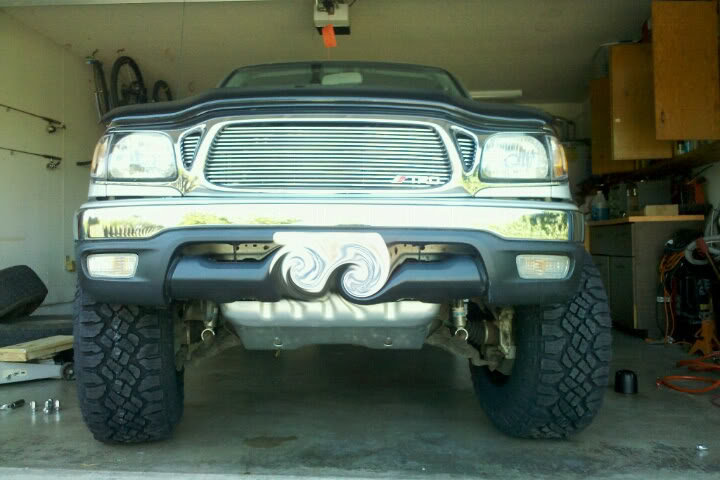

    I got them on 1st gen.
    The shocks are set at 0

    I lost track thousands of dollars ago.
    Yeah your right I got 3 1/4" of lift the Eibach's and the 5100's set at 0 on my 02

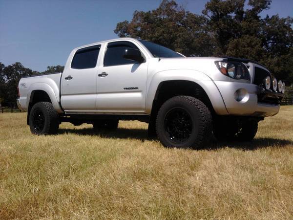

    285/75-16 BFG KM1's, AVS vent visors, AVS hood shield, pioneer avic F900BT, pac steering wheel control adapter, Boyo rearview camera, pac ipod interface, tinted windows, Toytec 1.5 AAL, Bistein 5100s (front set to .85) Eibach coils, Black headlights, grillcraft black billet insert, N-fab light bar, 4 Hella FF700 lights & color matched grille, Sockmonkey bedside decals. 16x8 MT sidebiters, Weathertechs, Fabtech spare carrier.
    I have 5100s at .85 with eibach coils and 1/4" drivers side spacer with 1.5" non tsb aal. Pics to come. Got 3" lift in front. Double Cab Prerunner.
