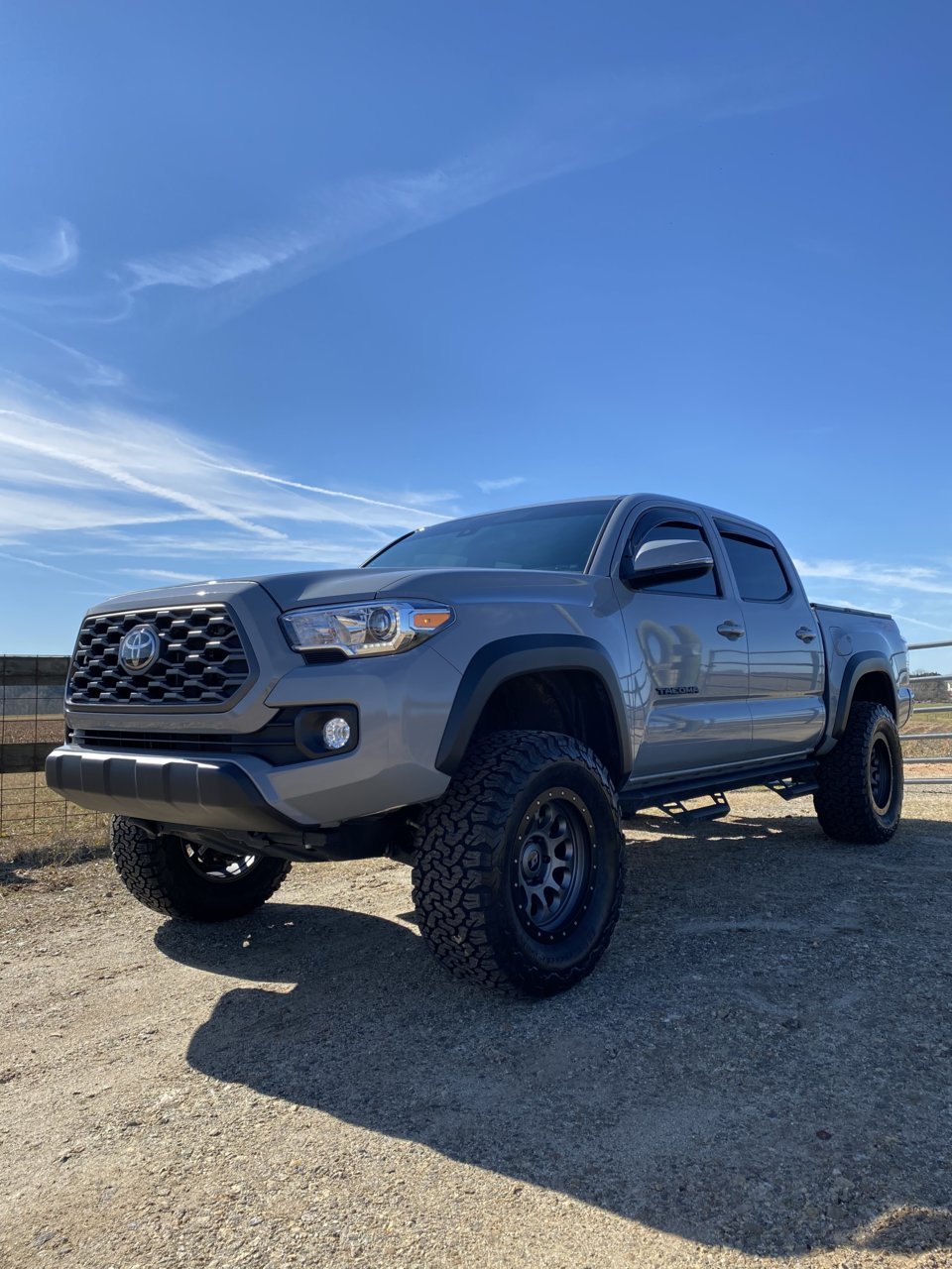

    Eibach Pro-Truck Lift, 1" Eibach rear lift blocks
    Little bit of both. The angle of the pic and the tires and wheels in the bed gave it a squat. It leveled out a once I removed them.

    I will say though... I don't recommend setting it to the top notch without weight on the front. It's pretty damn stiff right now! But, I plan on either getting a Ranchhand or going down to the second notch pretty soon. Other than that, there is plenty of clearance for 33s with this kit and I'm super happy with it!

    Are you running stock UCAs? Good to hear there's plenty of clearance w/ the -10mm offset wheels and the more aggressive KO2s :thumbsup:

    Yep. Stock UCAs! Aligned just fine.

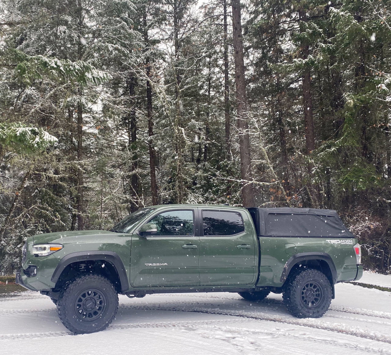

    Totally satisfied with the Eibach kit. Great value in my opinion.
    STT 285's on 0 offset Methods - that's it, stock UCA's for now, but no rub whatsoever as it sits. Add a leaf in the rear.

    I'm on the middle notch. I imagine I would have been fine on the lowest, but my next move is bumpers so just figured that'd be where I want to be, but that said - I'm fine with how it drives on the 2nd notch - maybe I'm not as picky as some, but in any case, I dig it. Also, if I were doing it all again, I would skip the AAL and get some better springs...Newb move, live and learn... luckily they are cheap so not a huge loss, but will upgrade at bumper time as I have some weight back there with the Decked and a bunch of crap in the drawers, and I think I'll go with swing arms on the bumper so...:benchpress:
