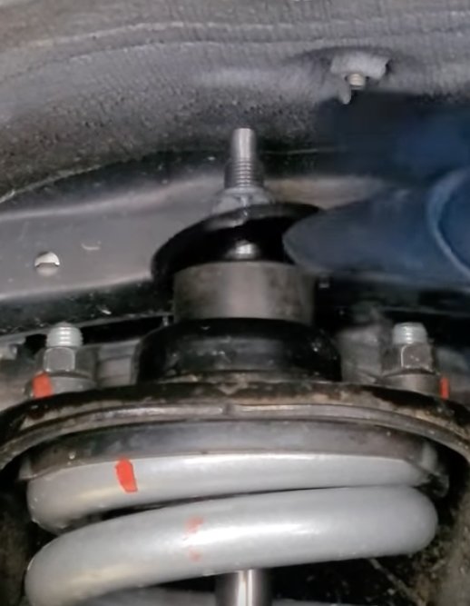

    Has anyone had bushing failure where the strut goes right through the top?
  2. Apr 10, 2023 at 6:27 PM
    #5642
    Halloween
    Halloween Well-Known Member
    Nov 8, 2022
    #410220
    522
    Steve
    Toyotas a plenty
    Can’t tell what has failed in yours. Was top part loose? Did bushing push up and out? Here’s mine

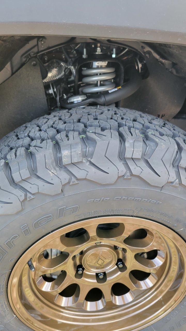

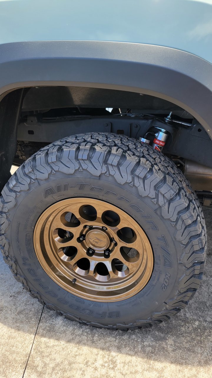

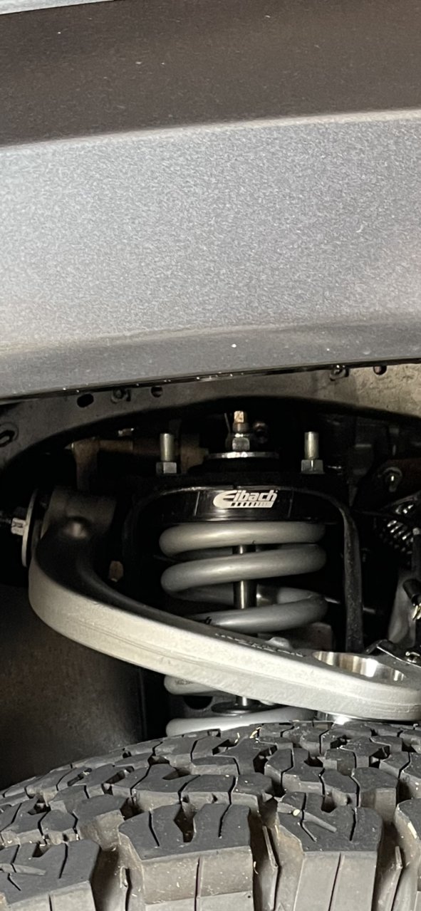

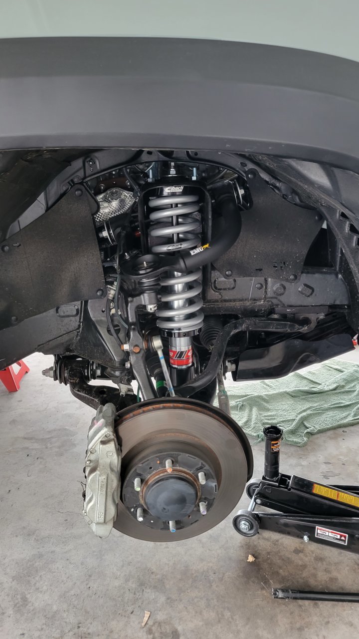

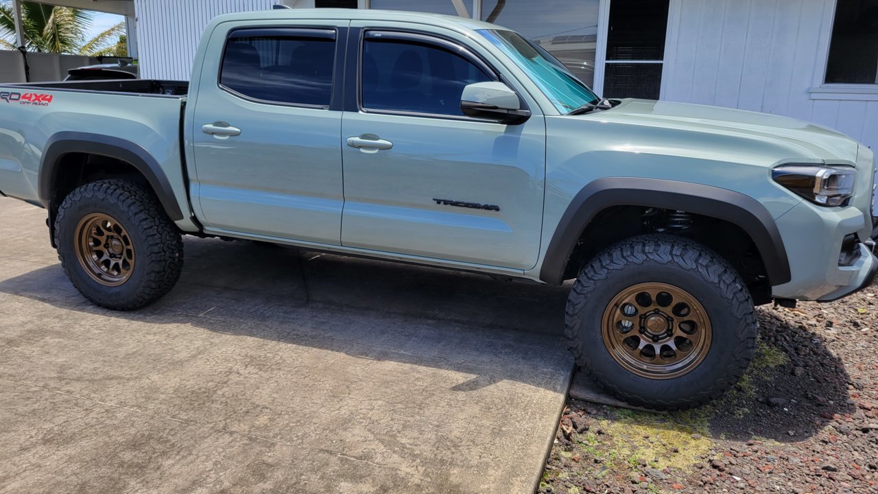

    Eibach pro truck 2.0/2R lift kit 1.5" AAL OME/ARB UCA BFG KO2, 285/70-17 SCS Blaze 10, 17-8.5, -10 offset ECGS bushing needle bearing replacement Clutch accumulator disk delete Poor mans TRD intake, K&N 57 series intake tube, K&N high flow filter, TRD flow accelerator
    Just installed the pro truck 2.0 kit with the 2R shocks in the rear. I added the 4runner front lower shock bolts while i was at it to make sure i dont get the clunk that others have had possibly due to the stock lower shock bolt. The kit rides really nice, so far really happy, got around 3" of lift out of the box up front, i also added a 1.5" aal in the rear20230601_162036.jpg 20230603_122827.jpg 20230603_122817.jpg 20230603_122807.jpg

    I have same kit. Rides really good. Yours looks great.
    could you post of all the part numbers I need to do the lower bolts. I want to avoid the clunk too. Thanks.

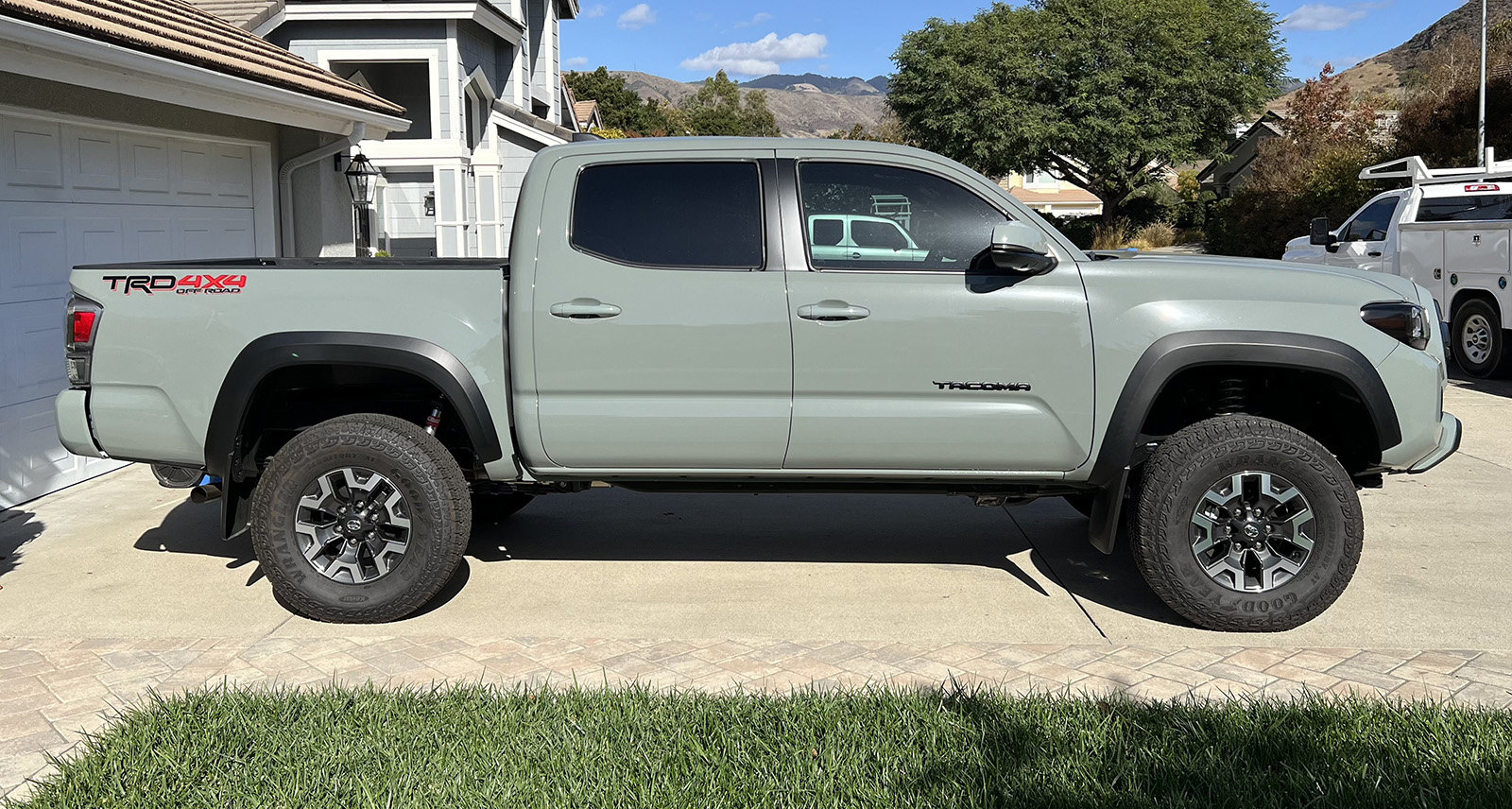

    I finally got around to installing my Eibach Stage 1 lift as an early Christmas gift to myself.
    Front: 2nd notch
    Rear: Icon AAL and 1/2" block (overload spring removed)
    Initial thoughts...
    1. Somehow, the truck is sitting almost perfectly level front to rear (fender gap) with the Icon AAL + 1/2" block... So, either the front lifted more than expected, or the Icon AAL pack is not providing the 1.5" advertised lift. I'm considering swapping out the 1/2" block for a 1" block to get back to a raked stance.
    2. The ride on OEM wheels and tires is great. It's not much stiffer than stock on the 2nd notch, there is less body roll during turns, and I no longer notice the nose dive during braking. For those who say the ride is too stiff, my guess is they are installing new tires at the same time and then assuming the lift causing the stiffness, when it's actually their tires.
    3. After a week on the OEM wheels and tires, I installed a set of SSW Raptor wheels and 285/70/17 Toyo RT Trail (Load C), and the ride became noticeably more rough. The rough ride is definitely caused by tires, in my case.... but they look so good, I can't be bothered :)
