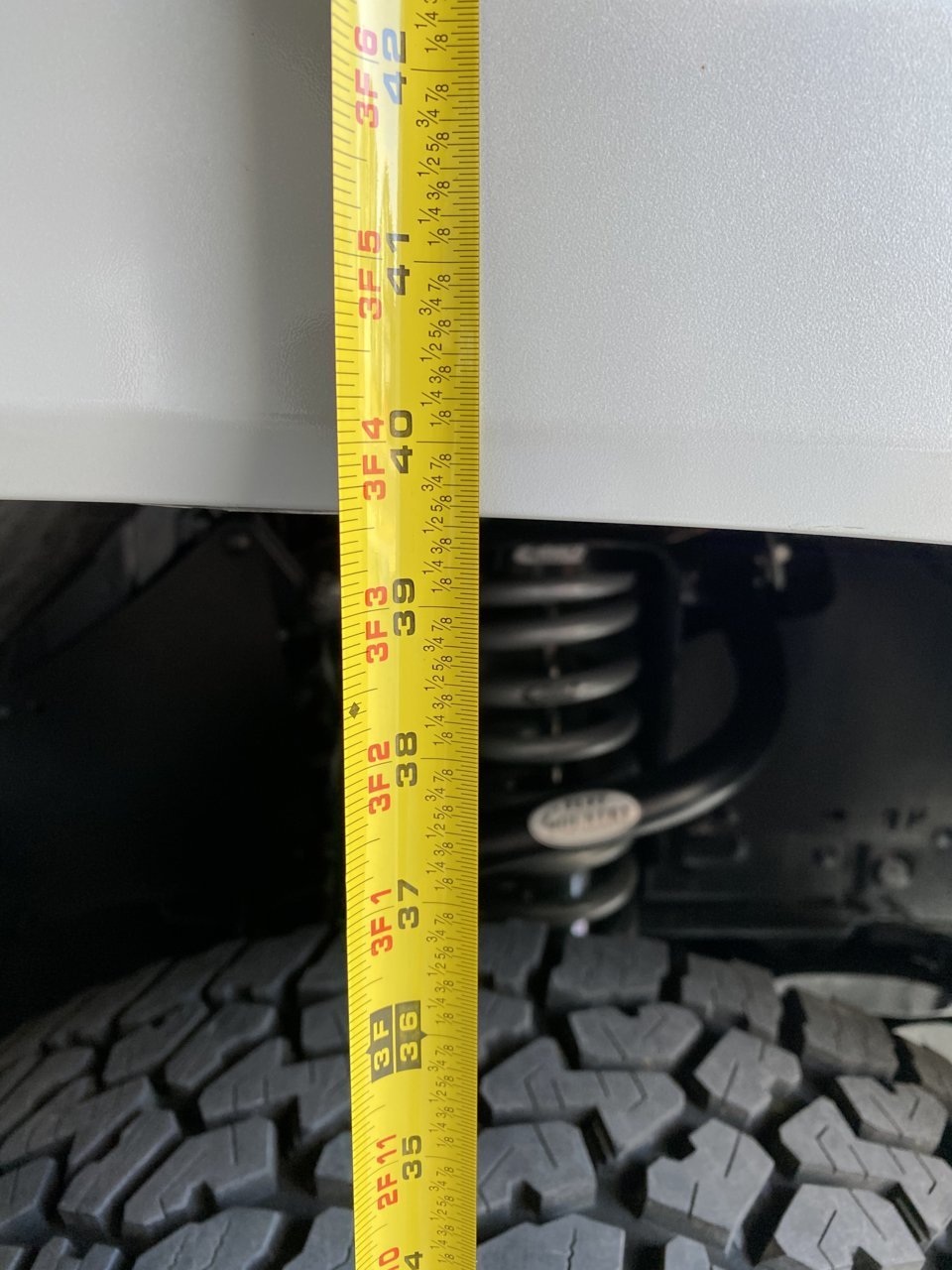

    Dude, that looks awesome man. Now you're really making me think about going up the full 2"! What size tires are you running?

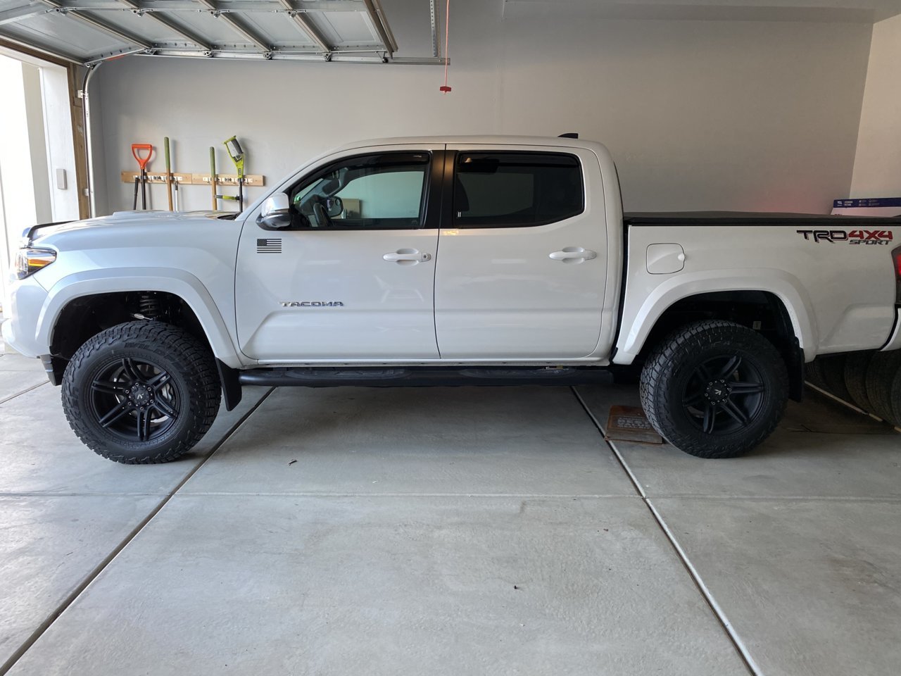

    Looks great, hows the ride at that height?

    Just a size up the stock size. Wildpeaks at3w at 265/70/17. Got these before the lift, and literally have 700 miles on them. Wish I waited so I could have gotten a bigger size but it’s all good. I did install aftermarket UCA though and started to rub on the left side at full lock which was weird. Although I still haven’t gotten an alignment yet.
    And yeah! You should totally do it! I believe I have about .25-.5” of threads left from maxing out

    took it on a 20 mile drive last night. And it didn’t feel as stiff as I thought. Ride was still awesome. It did get just a tad stiffer but nothing too out of the ordinary, my wife didn’t even notice it. It still took bumps like a champ with good recoil. I also did put aftermarket UCAs last week which did help absorb bumps to the ride as well. I do like the ride of it, I can’t really fully experience this eibach suspension yet since the rears are still not here lol.

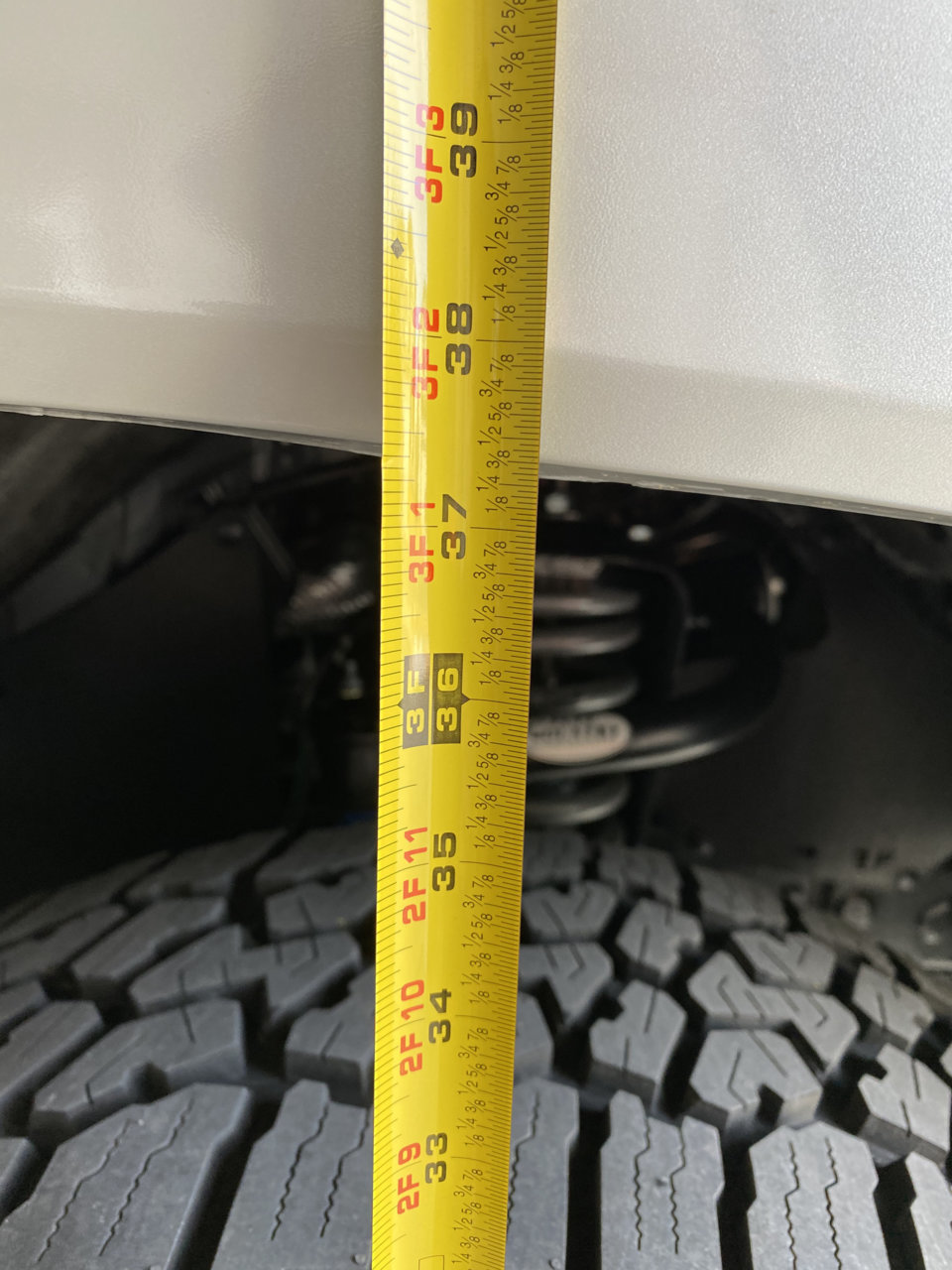

    what is your center of hub to fender measurement? Subtract 21” from that and that gives you the true lift height.

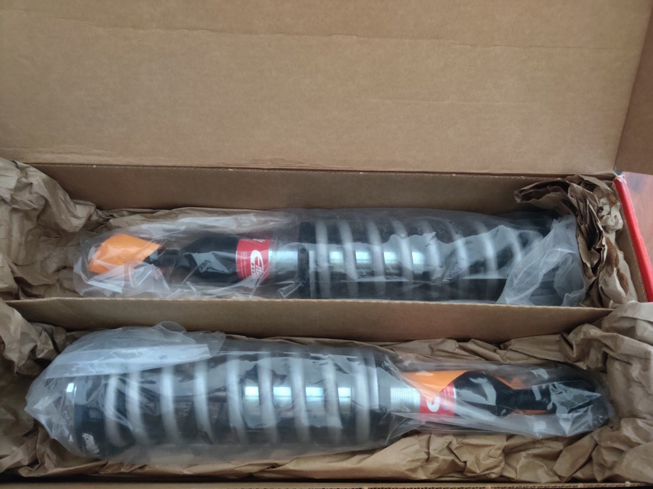

    I heard from Eibach they are BO until July. That is why I went with the JBAs (plus the cool look factor). I should be getting my UCA soon.

    Tirerack indicates estimated delivery Feb 2nd @ $492.15 /free shipping....

    Yes they are. Ordered mine last month. Currently on back order until February.

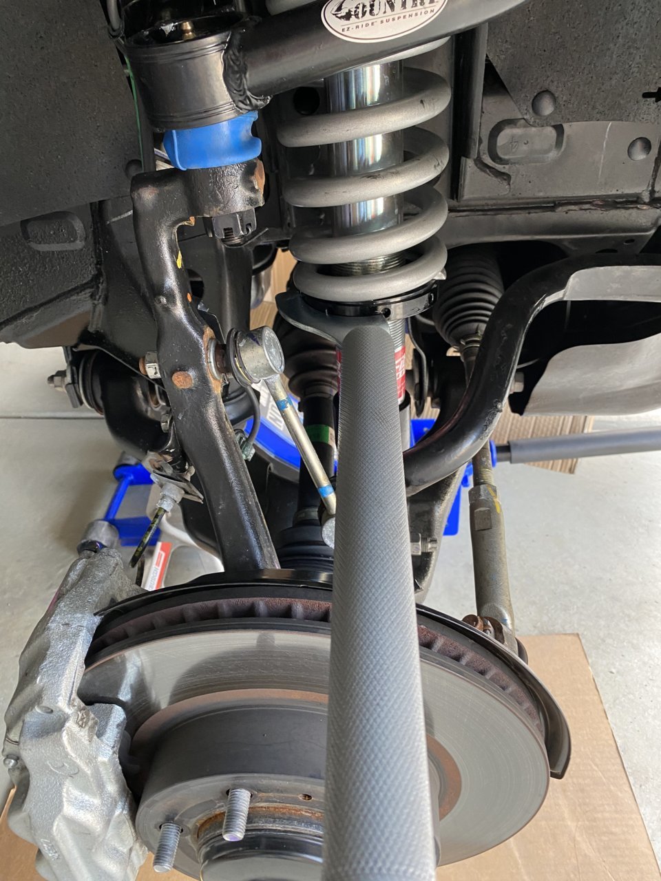

    And yes you can adjust height with them on the truck. Just need the weight to be off the wheels. Eibach has a YouTube video on it.

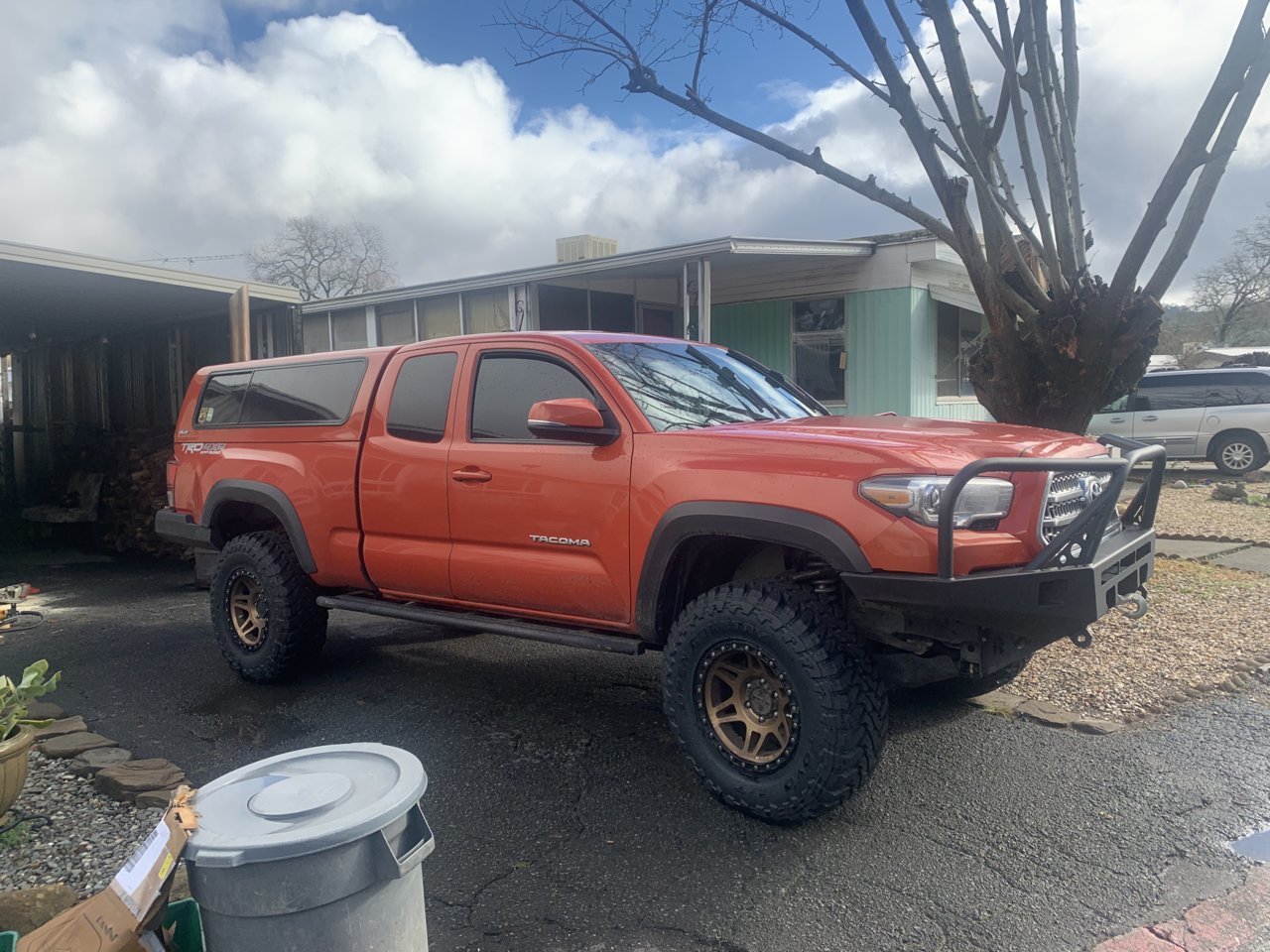

    Hello all.... first time posting here...
    I do have the eibach pro stage one...
    super happy with them...
    and buy reading the last, but first 3-4 pages, I wouldn’t do the stage two. I have front and rear steel bumpers and sliders, and a winch...
    My question is....
    I’ve bought 295x70x17’s
    And now need a cab chop done...

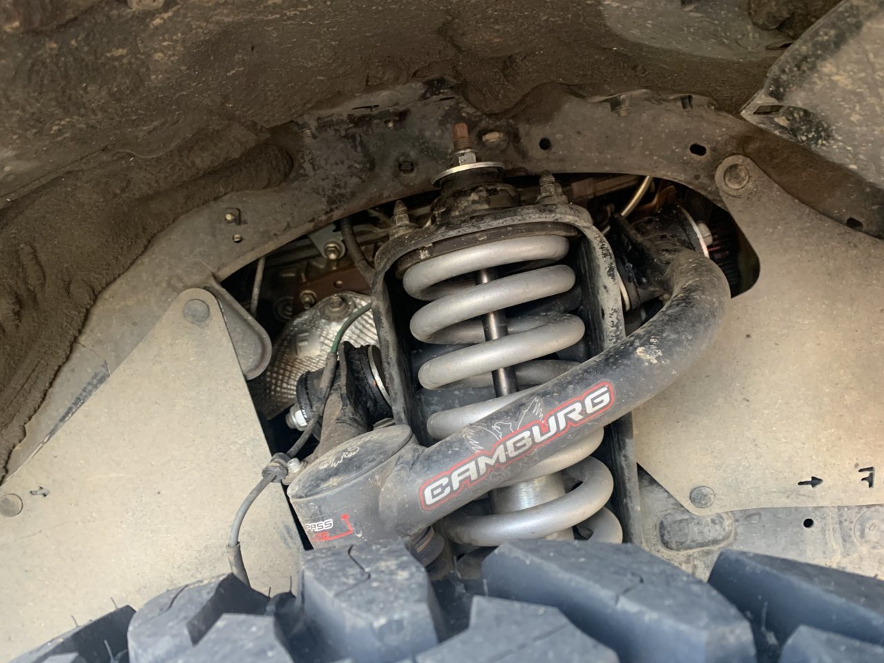

    But can I add a 1” spacer to the top of the struts for a little bump of clearance?

    Video posted by Mark shows Tanner adjusting while on the vehicle, although I still haven’t had a chance to adjust mine yet
