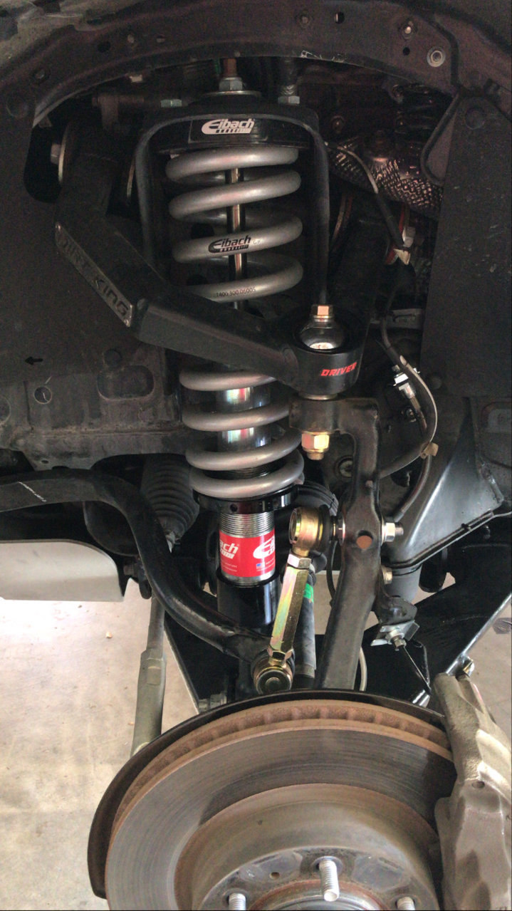

  10. Feb 25, 2021 at 9:55 PM
    #270
    patdeezy
    patdeezy [OP] Well-Known Member
    Jun 19, 2016
    #190028
    1,342
    souLcaL
    '19 OR 4x4 SuperWhite DCSB
    I think I officially got my front end dialed in :)
  11. Feb 26, 2021 at 12:35 PM
    #271
    Giusejuice
    Giusejuice Well-Known Member
    Aug 12, 2020
    #337488
    63
    South Florida / Boulder
    2020 MGM 6Spd OffRoad DCSB
    Eibach Lift | 33s
    Look quit a bit beefier than my stage 1s! good looks
