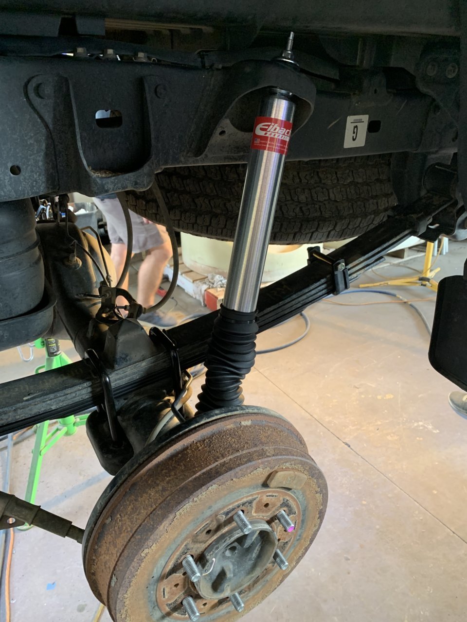

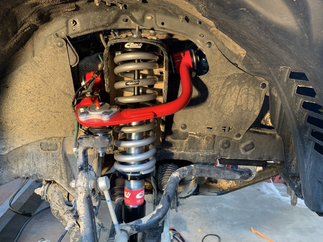

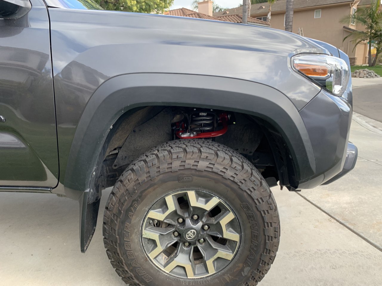

    Woohoo! I installed my lift kit today! So excited. I also took off the stock side steps (they are rock magnets anyway). Looks so much cleaner IMHO!
    Front
    Eibach 2.0 coilovers
    JBA UCAs
    Rear
    Eibach Pro truck sport shock
    ICON add-a-lead
    Before and after measurements center hub to bottom of fender flare
    Stock
    FD 20 3/4”
    FP 20 5/8”
    RD 21 1/2”
    RP 21 1/8”
    After lift
    FD 22 1/2”
    FP 23”
    RD 22 3/4”
    RP 23”
    Next step is to crank up the front driver’s side to match front passenger side and she’ll be golden, then off to the alignment shop.

    Actually about 2.3” (23”-20.625”) on the front which is what I wanted/expected. A little over an inch in the back which is what I wanted/expected.

    Ride home @ 25-75 mph it felt good. It felt like it was a little easier to steer which I’m not sure why (maybe because the front end is closer in ride height to the rear??). I can definitely feel the road a little better which is expected with a little bit stiffer springs and shocks. Haven’t had it off-road yet or hit any speed bumps to try the higher speed bumpy stuff yet but after alignment I will do that.
    My stock OR suspension was actually not bad (for sale if anyone wants it) it just was a little soft for my taste. I want to be able to take the whoops and washboards a little faster than with the stock setup.
    Talk about nervous though on the ride home. I kept going over in my head..did I torque this bolt, that bolt? Will my wheels fall off? Every little bump I was thinking is that my driveline/suspension falling off or just a bump in the road?, eye-yi-yi.

    Sorry Hooper, didn’t mean to impune your math. I plan to crank the driver’s side front up to match the passenger side so it will ultimately be around 2.3” lift on average in the front.
