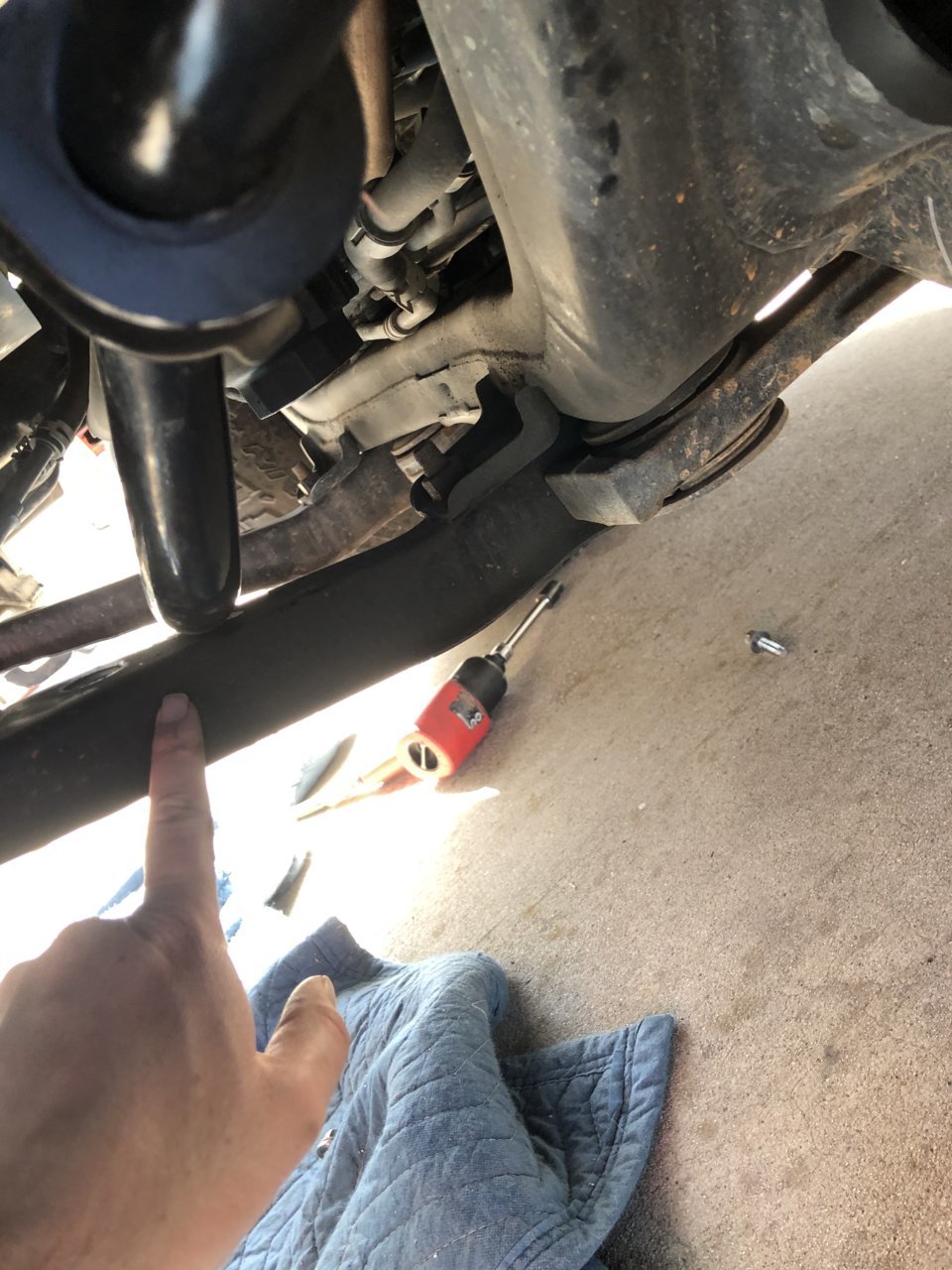

    The sway bar rubs the truck frame or the skid plate? How much lift do you have?

    I have it set to level there’s no lift in the rear. 1-1.25” probably
    And the a piece of shit wrench broke so I can’t change it right now LOL

    Is the sway bar rubbing the truck frame or the skid plate with the spacers installed? I used these coilovers to level my truck also (no rear lift) & the sway bar is not rubbing the frame. It is extremely close to the skid plate though with the spacers installed.

    There’s two pieces of metal that go from the crossmember up underneath the radiator. It’s rubbing those. The skid plate part that you take off to get to the oil filter is not being rubbed

    Your best bet is to re-install the spacers, remove the skid plate supports & install some washers between the frame & skid plate supports to gain clearance.

    That fixed it. Hats off to the wizard who first suggested it.
