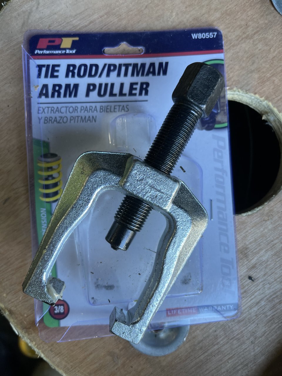

    Finally got the 2.0 coilovers put in this weekend as well as the SCS wheels I picked up. :D I got together with a couple of my marines that love working on rigs and was able to get all 4 corners done pretty quick. I will say that you DO NOT have to disconnect the upper control arm like most people end up doing. We got the tie rod out of the way as well as the sway bar and were able to wiggle out the stock coils and put in the new coils. After the instal I did adjust the coilovers down about a half inch since I don’t have anything in the rear yet. Super easy to adjust too, I just took a little PB blaster to help lube the threads and after a little convincing, the spring perch started turning.
    I will reiterate what 99% of people on this thread have said. The ride is much firmer than stock but in a positive way. They absorb all the pot holes and curbs without being jarring and there is no more “bouncing” after hitting something. I love them so far and will definitely crank them back up once I have an inch in the rear. I will get an alignment this week. (Tracks perfect but I know the camber is still off a little bit.)

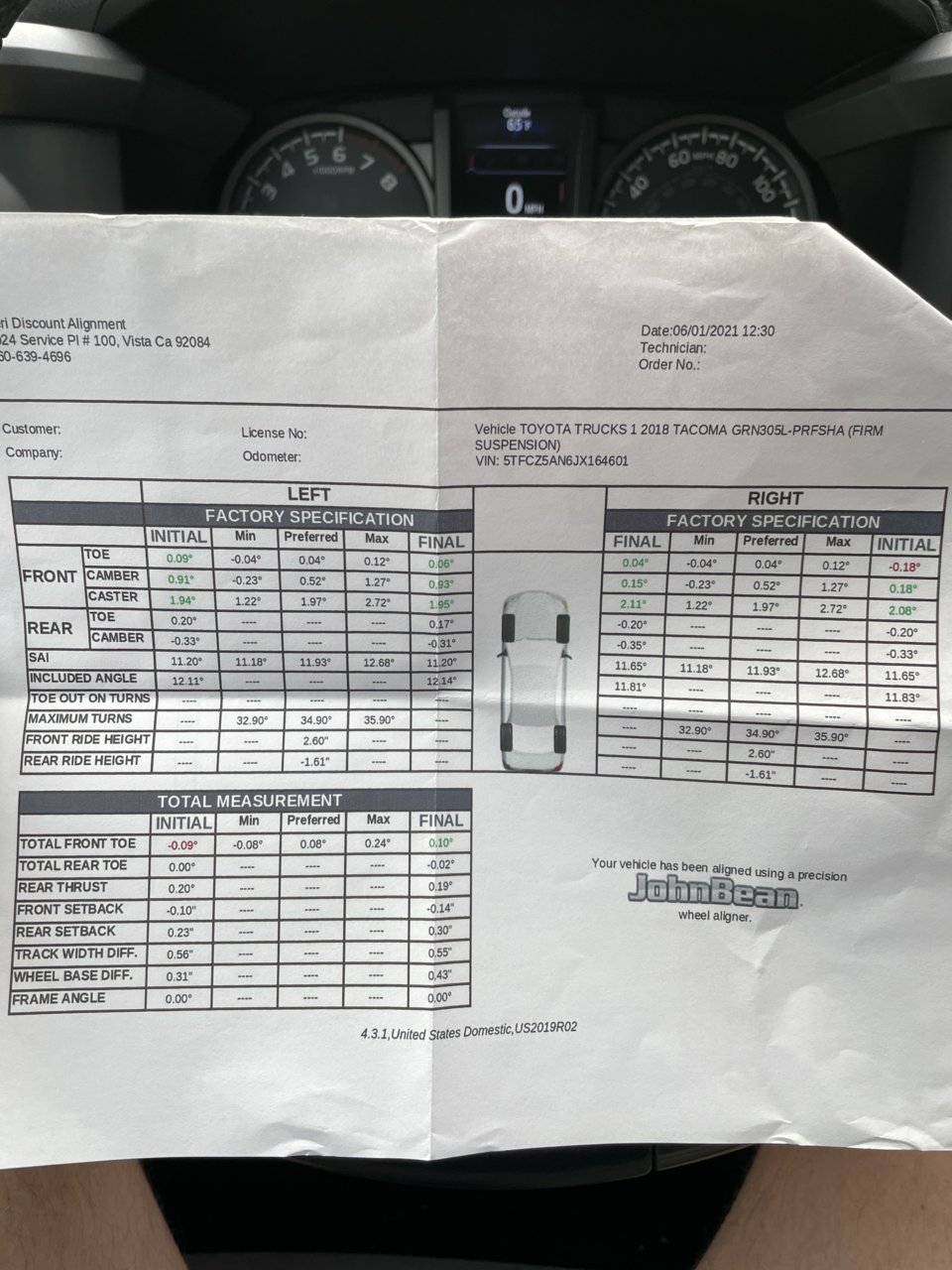

    I know this is kinda outside this threads scope but it’s worth a shot seeing what y’all have to say or if y’all could give me an alignment thread that’s active.
    I know a lot of people try to get as much caster as they can but I’m not trying to squish massive tires in my wheel well. I just have 32s.
    These are the specs an alignment shop got mine too but I feel like they could be better. I put the eibach coilovers in and right now it’s about 1.5” up in the front.
    The Toe isn’t bad and the caster isn’t horrible but I feel like having .15 camber on one side and .93 on the other is kind of drastic. What do y’all think? Should I just ride it out and get another alignment when I lift the rear in a couple weeks?

    Caster adjustment is more dependent on UCAs. Those numbers would bother my OCD though lol
    These are the specs an alignment shop got mine too but I feel like they could be better. I put some coilovers in and right now it’s about 1.5” up in the front.
    Goal would try and get Toe : 0, Camber : 0 and Caster to 2-2.5.
    Yeah the camber is what is bothering me. Even if it’s “within spec” I want them closer lol. Anyone know of a good place in SOCal in the Carlsbad/Oceanside area so I don’t waste my time on another “EH” alignment??

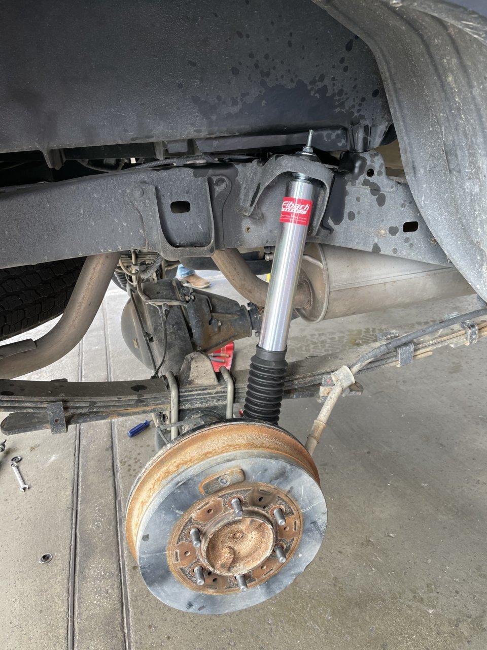

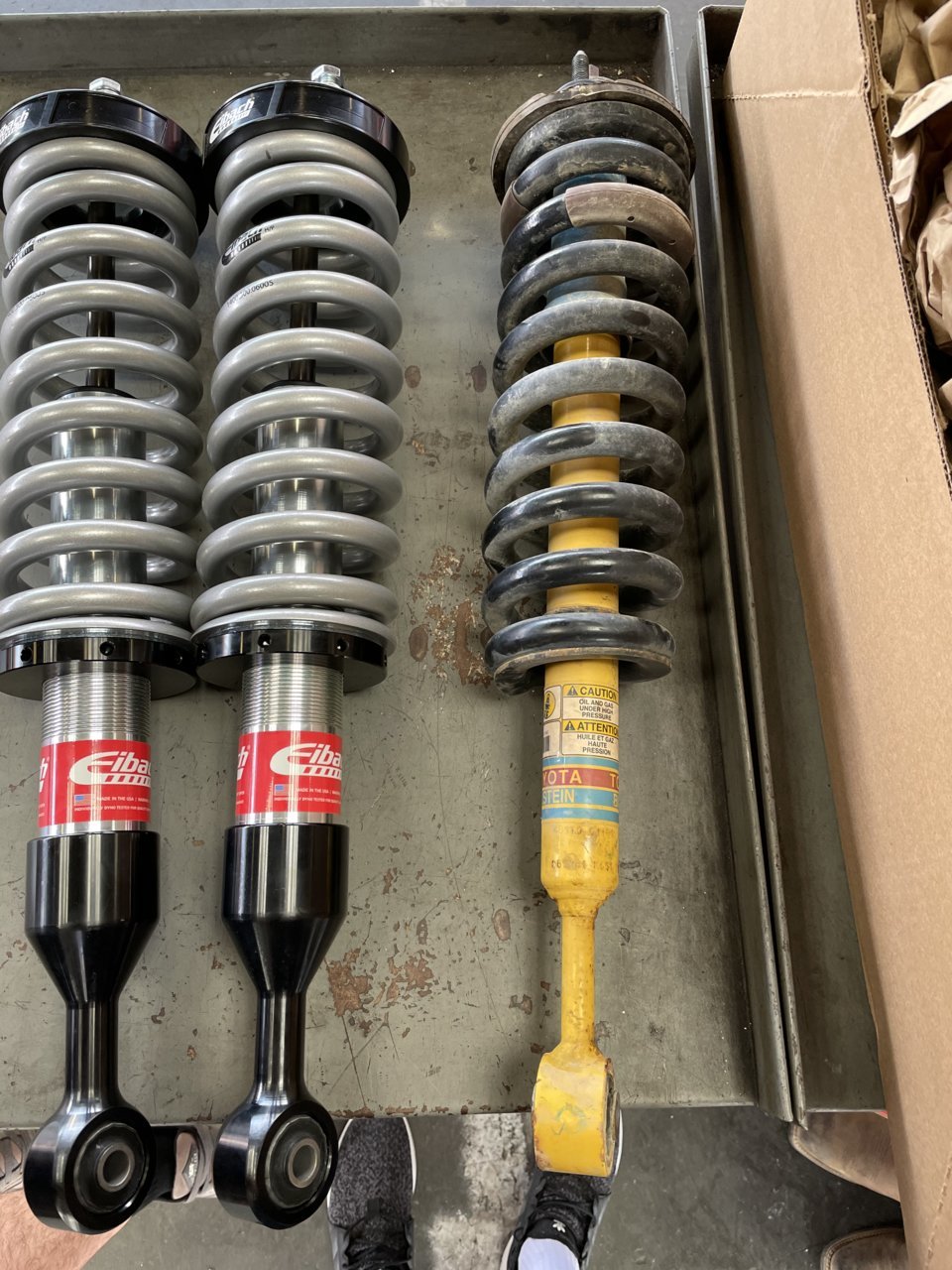

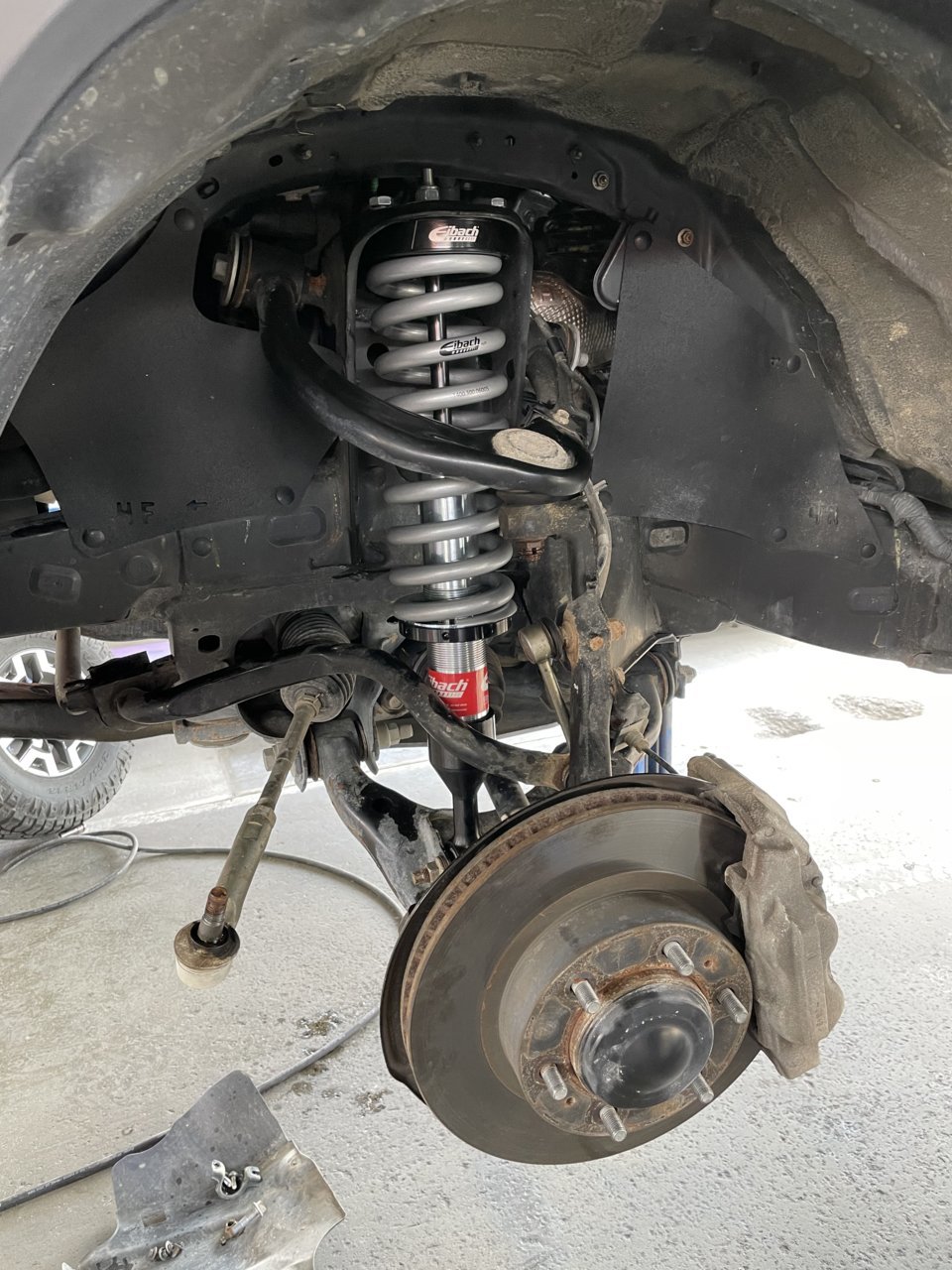

    Got my front coils done last night. Probably wait to do the rear tomorrow when my blocks get here. Very easy install. I did begin to cross thread a sway bar bracket but I was able to retap it and it worked out. I may get some flack for this but I STRONGLY SUGGEST BUYING A TIE ROD END PULLER, I banged on that thing from every direction for over an hour and used every cuss word in my vocabulary. I finally broke down and bought one, $15.99 and it worked like butter. Ended up going with a block in the rear for easy install reasons considering they are temporary with the end goal of a full leaf pack in the near future. Exactly 2” up front but my plans only requires 1.5” up front.
    How much did your coils settle after install before you made any final adjustments?
