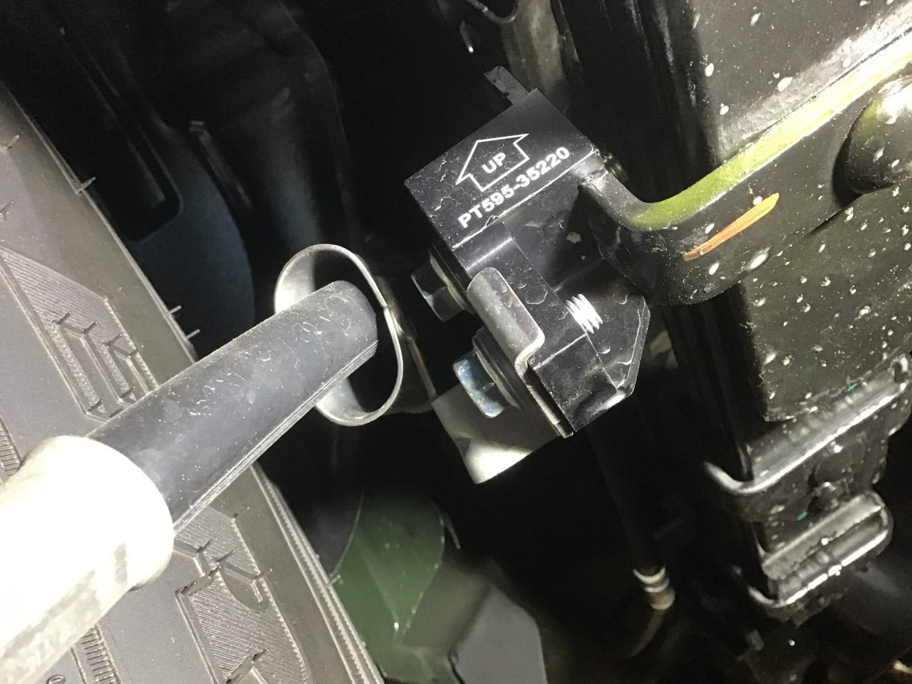

    I called eibach yesterday and ask if a spacer was needed to relocate the e brake cable mounted at the leaf springs and I was told no. I personally feel like there is a slight amount of tension when remounted in the original location. Toyota offers this part with their new lift kit. 96BEE233-ED68-4062-BE37-CB0F1D992A0E.jpg003D5A0A-4347-4CF0-B885-525E1DEF2E99.jpg Being a big fan of Toyota design I’m choosing to follow there direction and add this part. https://www.oemgenuineparts.com/oem-parts/toyota-taco-suskt-spc-prk-b-pt59535220
    After talking to customer service at this online retailer and my local dealership we have not been able to confirm if both side are included but I will report back when I receive my package.

    I was wondering about this myself, I was going to just make a drop bracket but I like engineered parts better if available. Thanks for options.

    Yeah I saw in another thread a guy just made a 1x3 ish bracket out of flat steel that lowered the mounting point and it worked but if this kit gives me both sides for about $29 shipped then it seems like a good deal. Although the diy flat bracket does keep the brake line closer to the leaf which might be of a benefit if tire chains unexpectedly loosened up.
