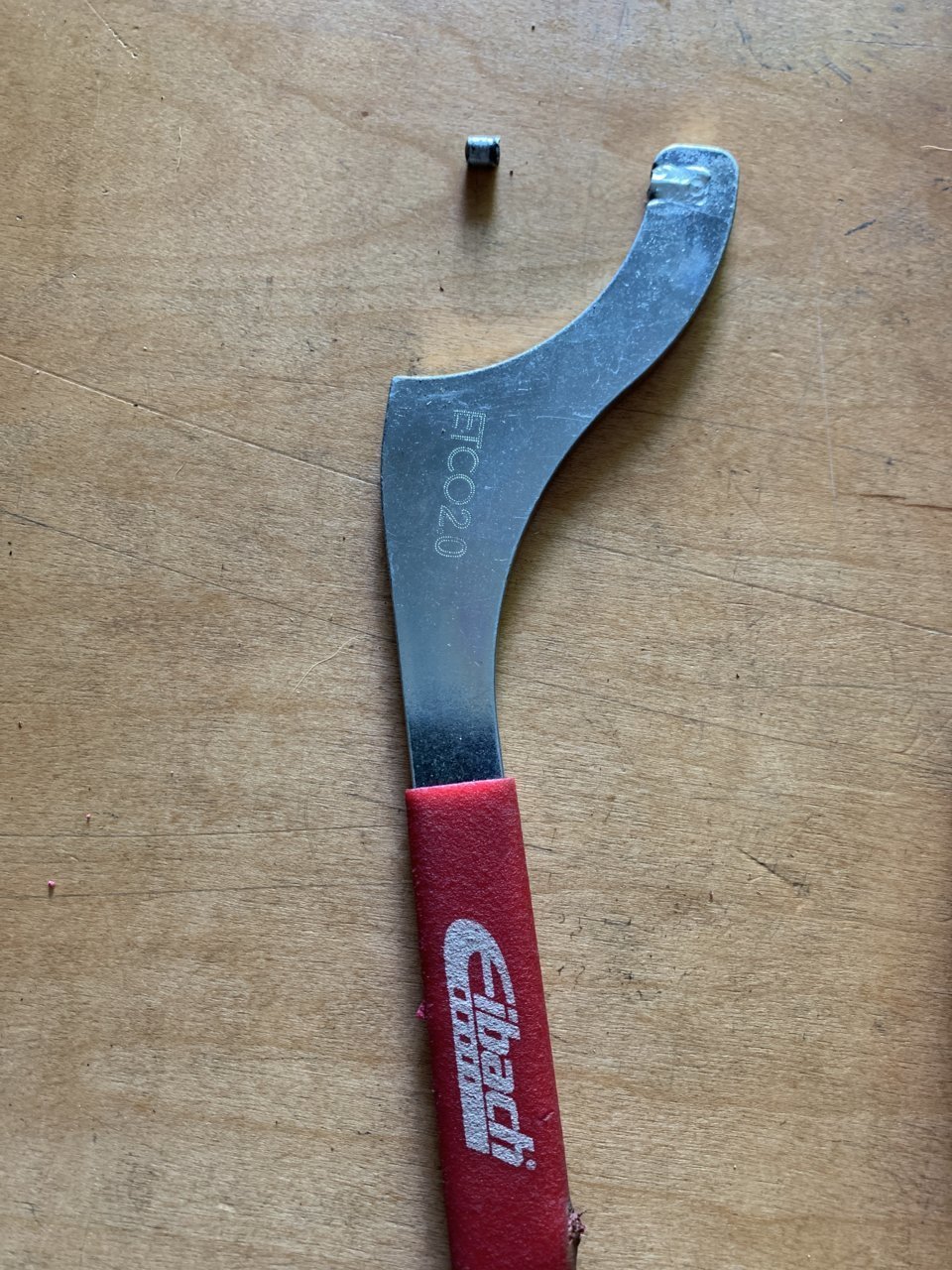

    Anyone know where i can get a new spanner wrench? Cant find it on eibach’s website. 29AF83CF-AB00-4D7A-B77B-51889EE73540.jpg

    call them on Monday and they will help

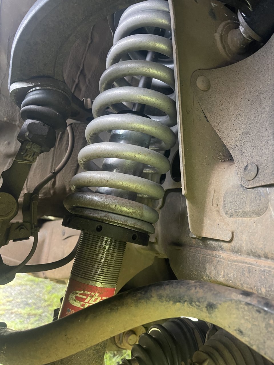

    Is it maxed out or are there still threads left?
  6. Jul 21, 2021 at 10:49 AM
    #506
    kauai cement taco
    kauai cement taco Member
    Jun 25, 2020
    #332554
    22
    Aaron
    2019 TRD off-road
    Not much left, I’d take a pic but it’s hard at that angle. I wouldn’t go more then what I set it at anyway. This is how much is showing on the bottom of the coilover. C17C4283-89A4-40BD-8C42-11D9FAD06F3B.jpg

  7. Jul 21, 2021 at 11:01 AM
    #507
    YouKnowNB
    YouKnowNB Well-Known Member
    Sep 19, 2020
    #341275
    72
    Nick
    Black TRD Offroad 4x4
    Thanks bud, i was gonna set it a little lower but close to what you have it.
