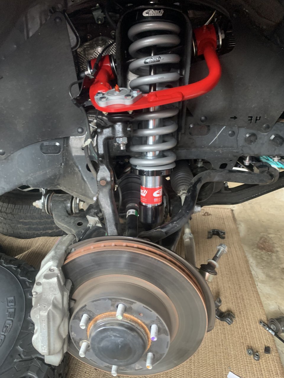

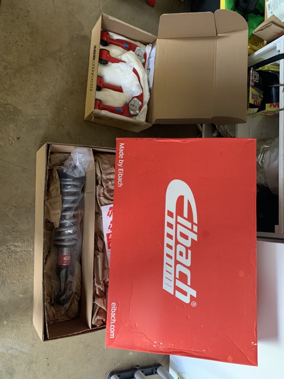

    Finally got a chance to install mine and get it aligned. Pretty happy with hownit turned out, the uca install on driver’s side was a damn chore though.

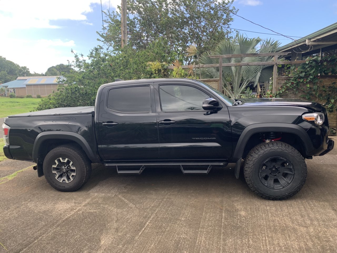

    Looks baller! What's the lift front and back? Rear looks to be stock height?
  5. Aug 4, 2021 at 8:00 AM
    #525
    YouKnowNB
    YouKnowNB Well-Known Member
    Sep 19, 2020
    #341275
    63
    Nick
    Black TRD Offroad 4x4
    In the stupid squat pic I took it was stock height. The driveway is sloped, I’ll take some flat pics today. Its the 2.0’s up front with jba ucas and a deaver aal and the eibach stage1’s for the back.

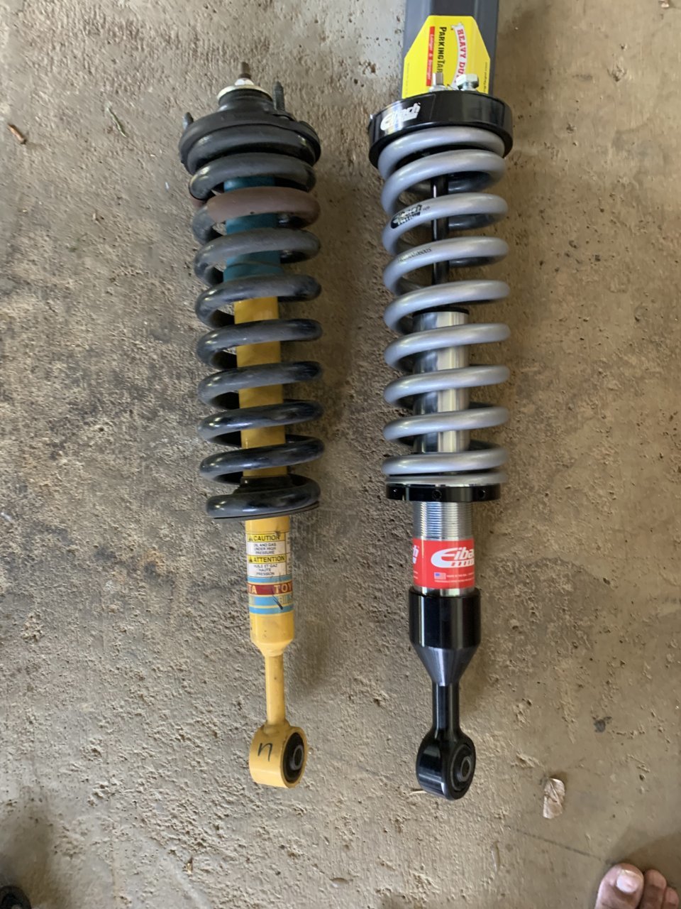

    Does anybody have any pics of the stage 2.0 coilovers and shocks side by comparison with kings? Was just curious if anyone upgraded from eibach to kings and how much of a difference of the shock body wise. Thanks

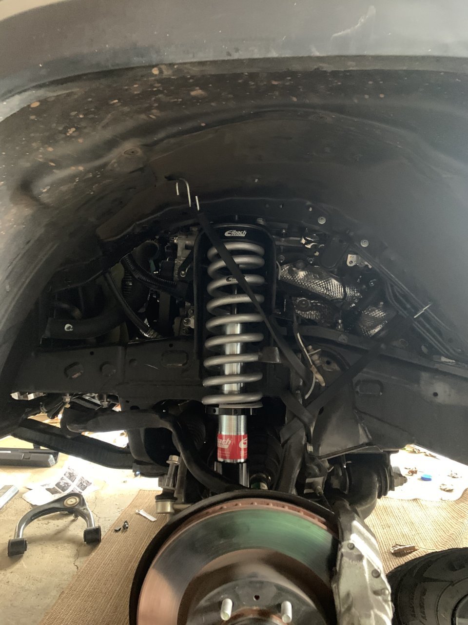

    I put my lift on yesterday and I'm getting the same noise over speed bumps and pulling into my uphill driveway, so slower compression. I did need to use the sway bar relocation bracket supplied with the lift. I can look in at inside of the skid plate and see what looks like a rub mark on the inside. I'm going to take if off this weekend and see if the noise goes away. Do you remember how thick the washers were that you used to shim it?
  12. Aug 6, 2021 at 6:31 AM
    #532
    Hooper89
    Hooper89 Well-Known Member
    Sep 13, 2019
    #305186
    1,144
    2016 White TRD Sport
    just regular old washers underneath one part of that radiator bracket ot whatever it is. Maybe 2-3 of them it didn’t take much.

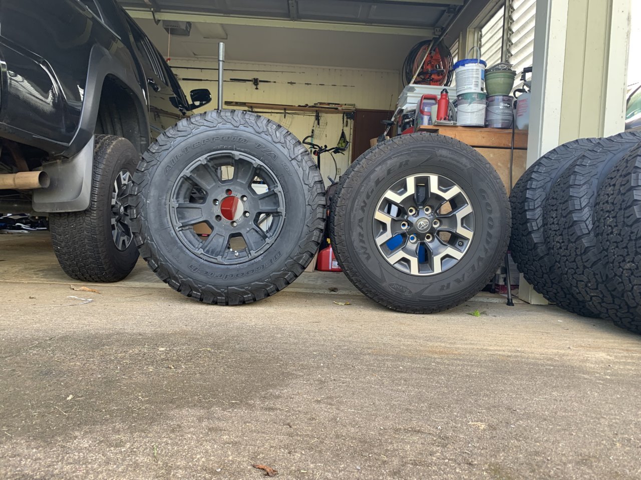

    What size tires you have
  15. Aug 10, 2021 at 10:13 PM
    #535
    YouKnowNB
    Sep 19, 2020
    #341275
    63
    Nick
    285/70/17. 17x9 with 4.5 backspacing and a -12 offset.
    Caster is set at 4.1 and 4.2 degrees
