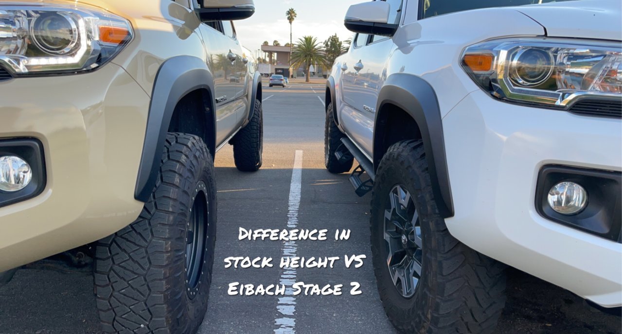

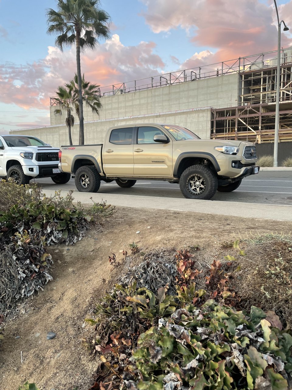

    Stealth Custom Series BR6 16x8 -12 265/75r16 Ridge Grapplers Eibach 2.0 coilovers, pro-truck shocks and Eibach 1” block Cali Raised Mid-Height bed rack Roam Adventure Co. RTT
    I posted in this thread when I initially put the coilovers in. Here are my thoughts after a few thousand miles.
    1) They eliminate most body roll and nose diving and do feel much more stable even with highway driving. Given the stiffer springs, you will feel much more of the road but big bumps get absorbed nicely with no “bounciness).
    2) Being a steel body shock, it’s super nice when I want to adjust to get the perfect ride hight. I adjusted the driver side ever so slightly higher to account for the lean (Eibach even recommends this vs putting a spacer on top”.
    3) For the $1100 for the stage 2 kit, you really get a lot of bang for your buck. It’s obviously not a king R/R coilover but it does exactly what it is supposed to do as a mid level coilover set up.
    I just recently put the Eibach 1” block in the rear which makes it look much better. I will eventually get a full leaf pack once I decide to overland it but for now the 1” does the job I need it too. I have not noticed any vibration out of the ordinary.
    I have attached two pictures, 1 of the side view and 1 next to a stock Tacoma. I adjusted the coilovers down just a bit so that there is no “bro lean”. I can get exact measurements later if anyone wants them but I’d say it’s about 1.5 up front and 1 in the rear.

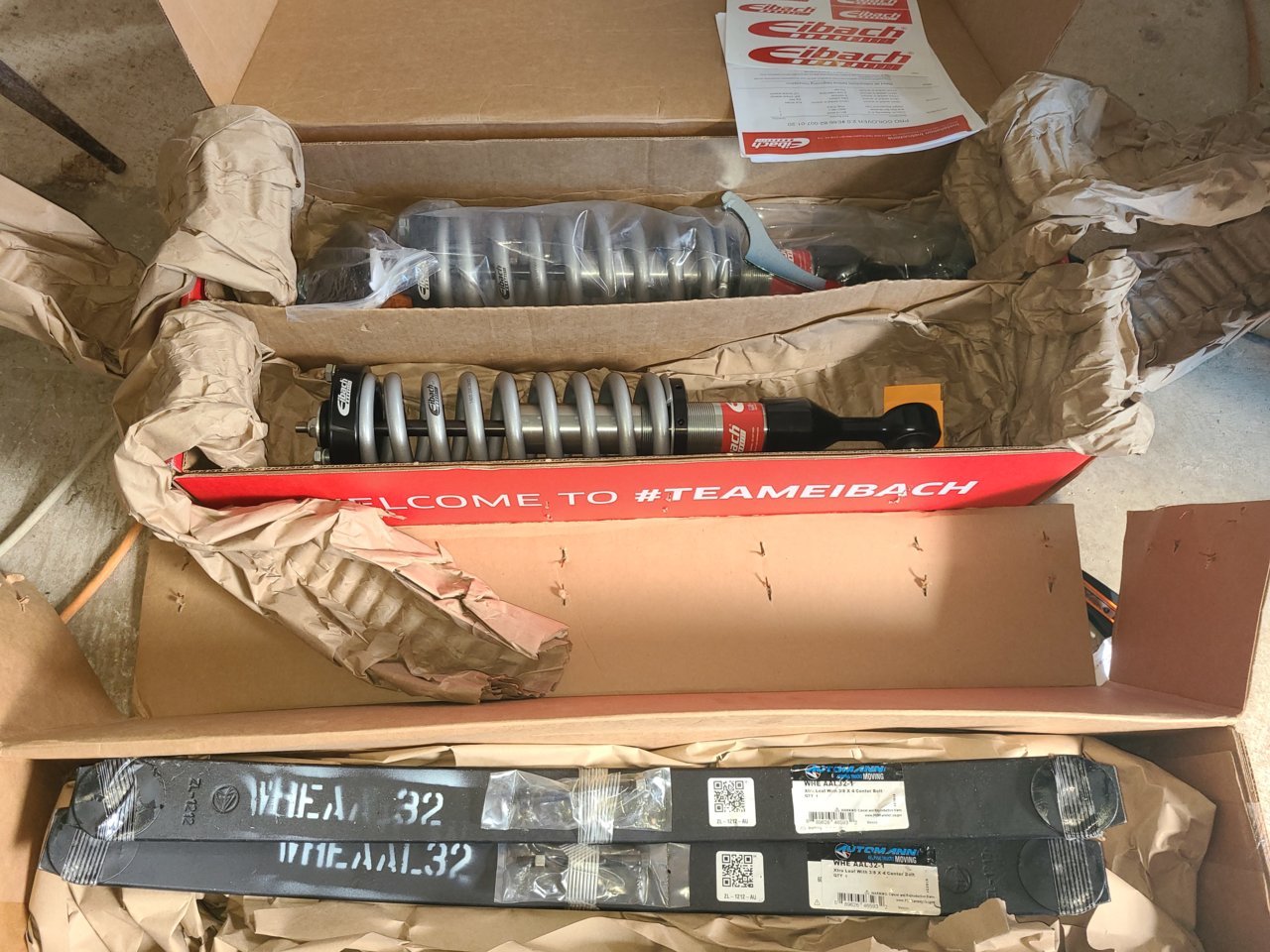

    #560
    Chief_CNMI
    Chief_CNMI Well-Known Member
    Sep 27, 2020
    #342052
    172
    Bryan
    Saipan, Northern Mariana Islands
    2020 4x4 V6 SR5 White
    All lighting are led, wheels, tires, 5100 lift, pro grill, bed light, seat covers, door sill protectors.
    Looks what just came in the mail!
    I already had the rear eibach installed a couple months ago. So hense why it's just this. I also have spidertrax 1.25" wheel spacers
    YouKnowNB, AMarkham40 and overhauler6 like this.
