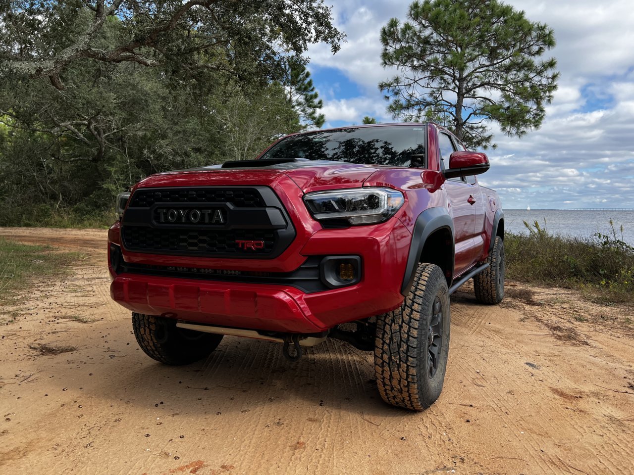

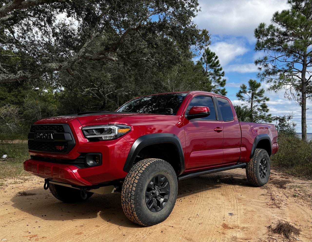

    Finally got them installed along with dirt king ball joint UCAs
    Along with fox 2.0 resi w/adjuster and wheelers aal in the rear
    It’s so smooth compared to stock sport suspension
    I adjusted these up to 2.5 inches of lift came out of the box at 1.25 inches of lift
    These are my measurements as I adjusted them but mind them as i am an access cab so I’m alittle lighter then most Double cab short beds
    I marked the the threaded ring with a paint marker straight out toward the spindle and just counted each time i went around
    Before lift-------------Final lift measurement----------Difference=Amount of lift
    DF 21.5" --------------24"-------------------------------2.5"
    PF 21.75"--------------24.25"---------------------------2.5"
    DR 22 5/8"--------------24.75"---------------------------2.125" - this number is probably low because I have a PVC water tank in the bed on that side that was holding about 8.5ish gallons of water
    PR 22.75-------------25"------------------------------2.25"
    After lift
    DF 22.75"
    Pf 23.25"
    Dr 24.75"
    Pr 25"
    After 1 full turn driver side front
    DF 23"
    Pf 23.25"
    Dr 24.75"
    Pr 25"
    After 3 turn driver front
    DF 23.25" 1.5 thread showing
    Pf 23.25"1.25 thread showing
    Dr 24.75"
    Pr 24 7/8"
    After 6 turns driver front
    DF 23.5" 1.75 threads
    Pf 23.5" 1.25 threads
    Dr 24.75"
    Pr 25"
    9 turns driver front
    DF 23.75" 2 threads
    Pf 23.75" 1.25 threads
    Dr 24.75"
    Pr 25"
    Final height
    9 turns driver 6 turns pass
    DF 24"
    Pf 24.25"
    Dr 24.75"
    Pr 25"

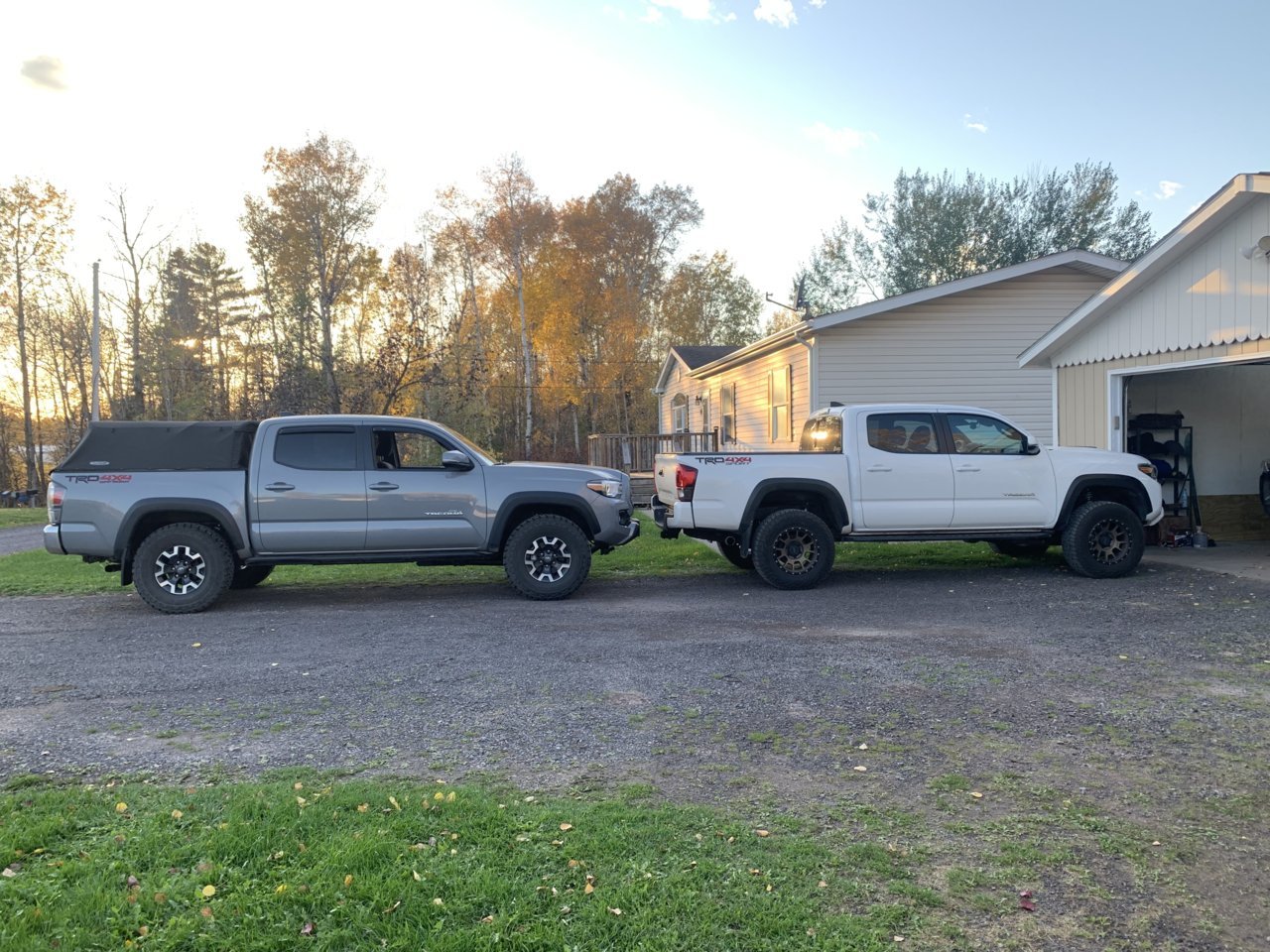

    TRD Pro Skid RRW RR5-V 255/80/17 RCI Trans/tansfer case Skid Custom Sliders Eibach 2.0 lift Icon RXT soft topper
    I recently installed the Eibach Coilover kit with SPC upper control arms, egcs bushing, and Icon RXT leaf pack set to stage 1 on my 2019 TRD sport. I was looking for a more capable suspension that rode in between the sport and offroad and I think I found it. The ride is stiff (over the offroad) but not jarring and definitely softer than the stock sport suspension, have had this setup for about a month so far and am really happy with it and everything seems to be working fine together (was worried about the rxt leafs and eibach shocks maxing out)
    My sport vs stock height off-road on tall skinny’s
