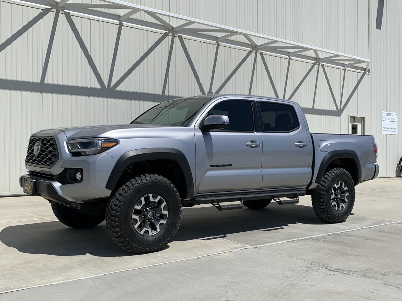

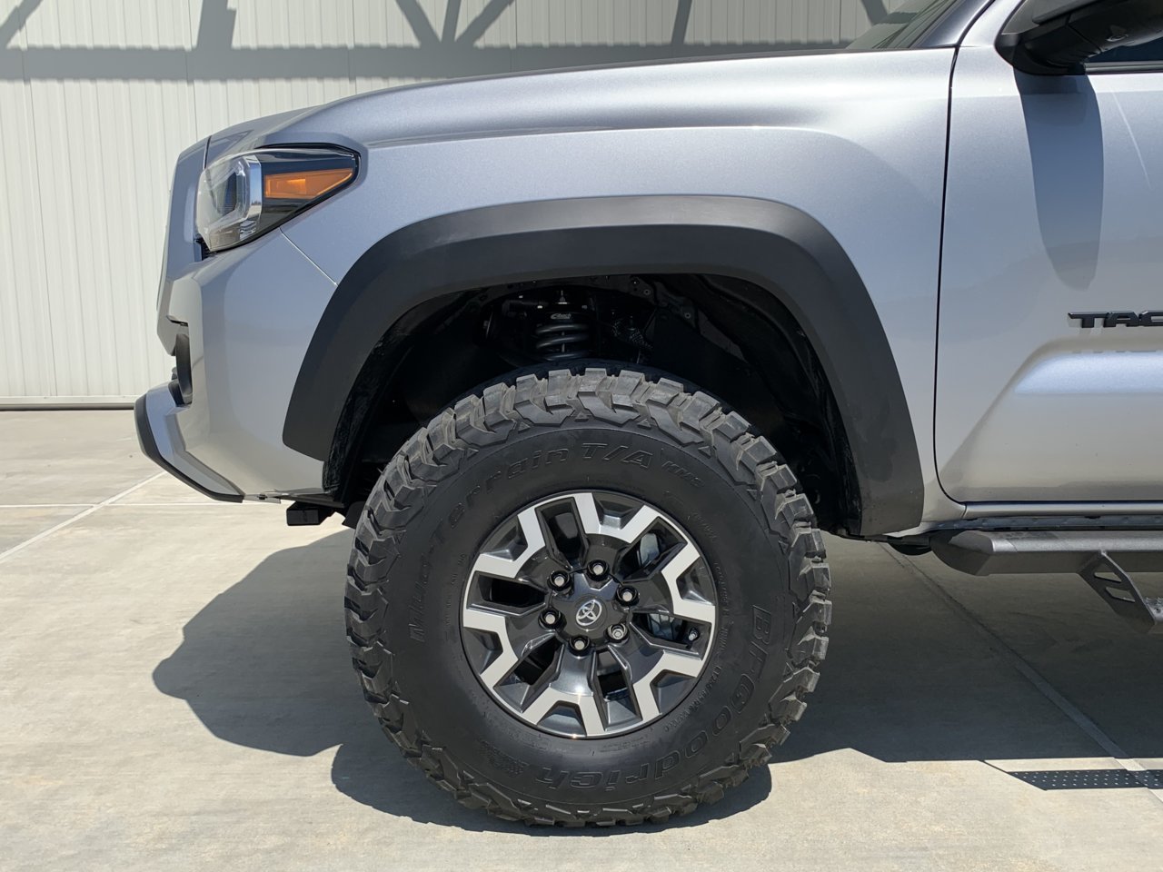

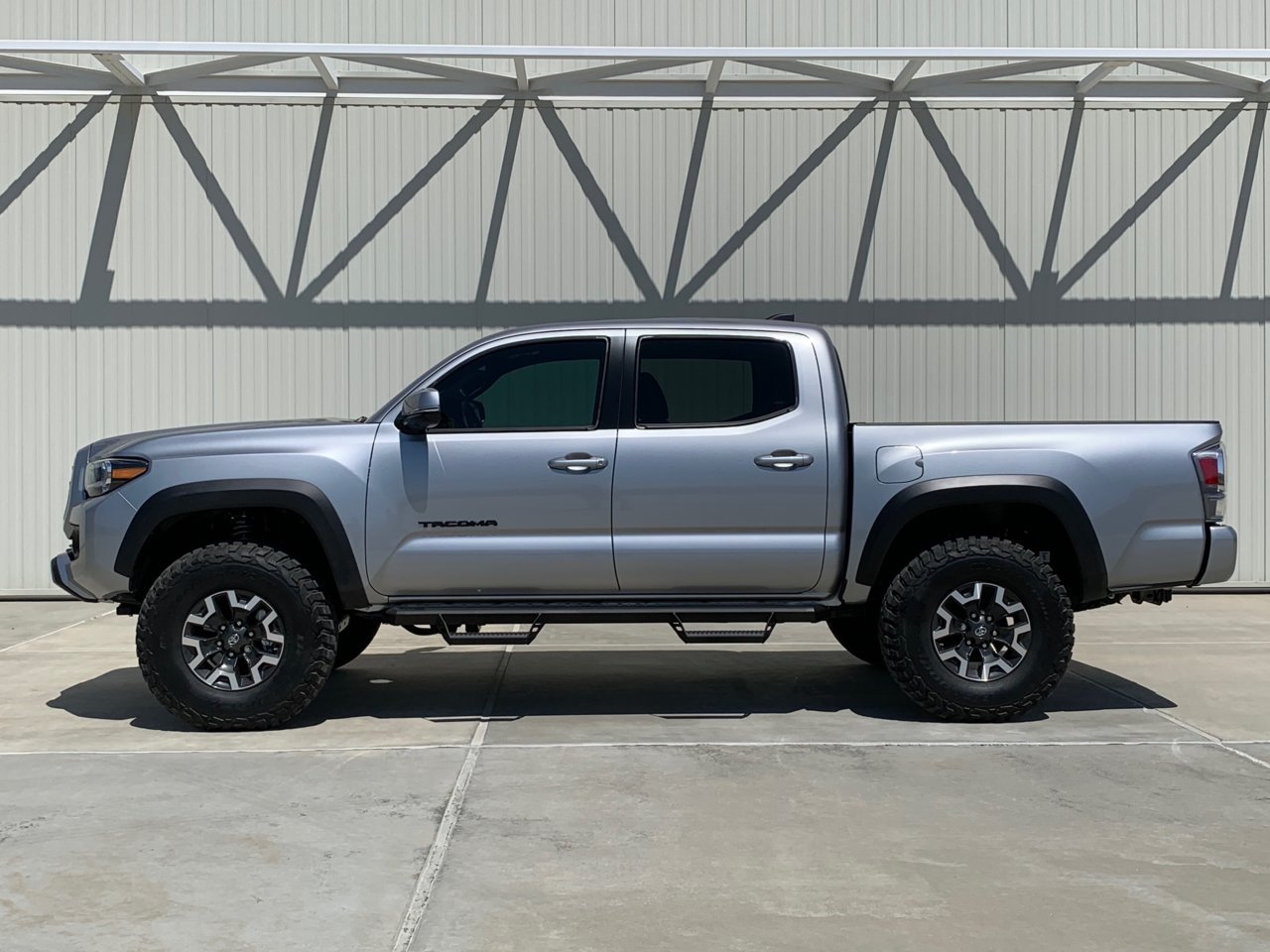

    Installed the Eibach Pro Truck Coil Over 2.0 Stage 2 kit this morning. In the rear I added a 1" block (edit: have since chucked the blocks, added Icon 1.5" 3 leaf AAL) with Eibach Pro Truck Sport Shocks. Tires are 255/85 R16 BFG M/T KM3s. Truck is stock other than a VF Tune. Ride is smooth and feels planted on the road. Alignment schedule for tomorrow morning.

    that looks great man!
