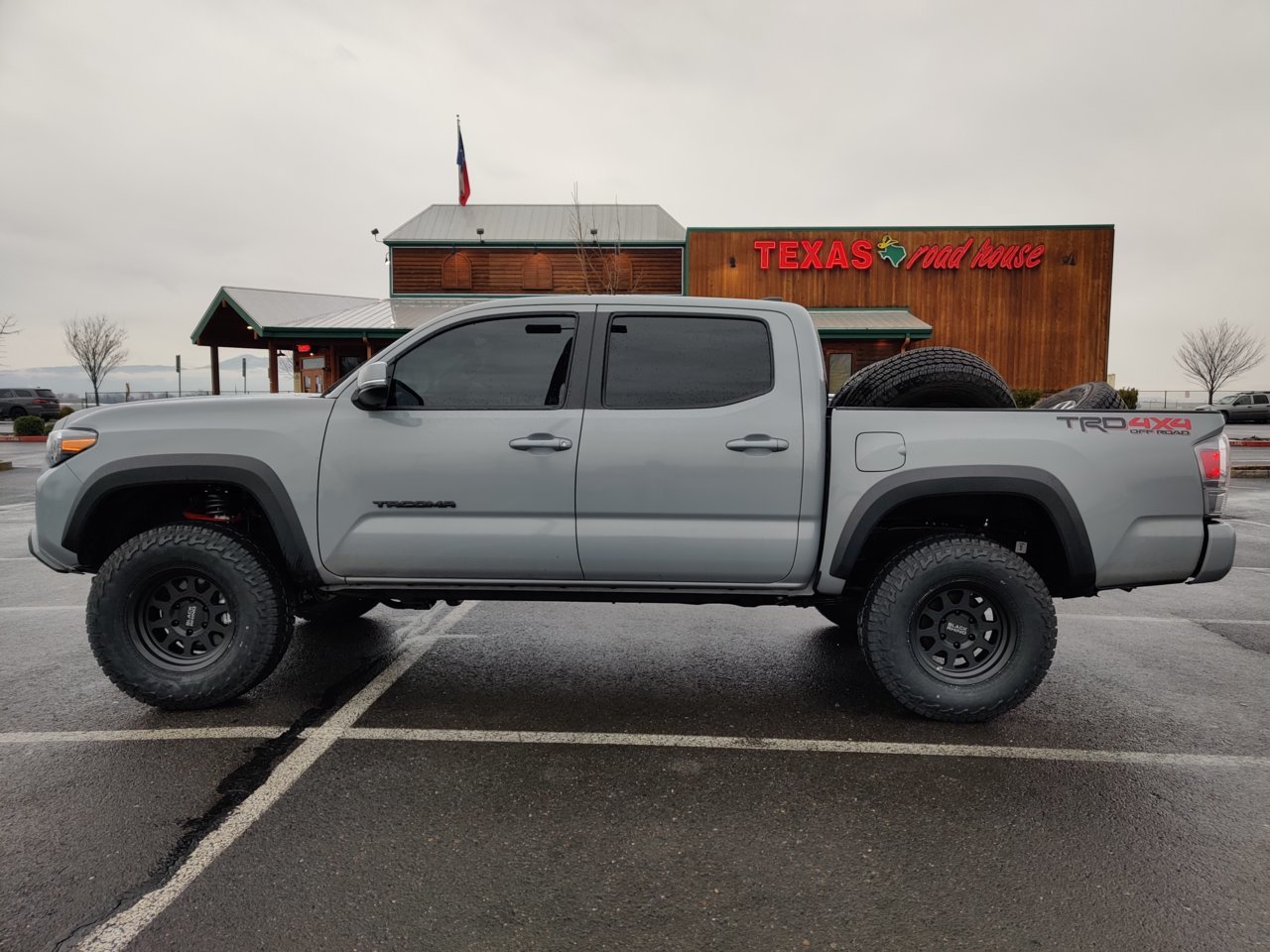

    Eibach 2.0,SPC UCA,ECGS,ATS 4/1 rear leaf,5.29
    That picture I have the 2.0 coilovers in the front and a headstrong AAL pack in the rear. Is that what you are asking?
    I ditched the AAL pack and replaced my leaf packs since then.
