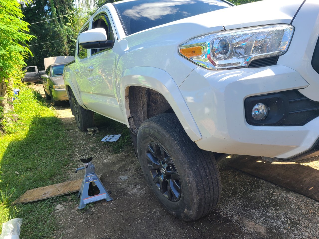

    All lighting are led, wheels, tires, 5100 lift, pro grill, bed light, seat covers, door sill protectors.
    Ribach rear shocks are actually good for up to 2.5" of lift. Mind you, I've installed my rears first before purchasing the fronts. So I drove on eibach rear shocks in the rear without any lift and they did fine, all though, I'm sure they are rated for up to 2.5" because when u ran them at stock height. The shock was atleast 2.5" collapsed before being fully collapsed to 14" or so, if that makes sense

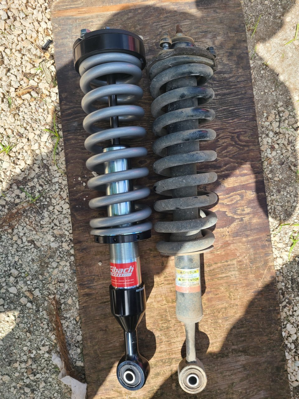

    The stage 2, is actually about 1.5" longer than factory. Tho you get most of your lift from the coils. The more the coil compress, the less lift, the less the coil compress, the more lift you gain from sitting on top of the spring. It does not over extend/travel, like spacer lifts (bc you increase the shock body length with spacer) these suspension upgrade keeps you in range of motion without over extending and binding

    I measured mine vs. my stock Sport struts. (Now my strut is still installed but the front suspension was at full droop.) The Eibach measured out about 5/8 to 3/4 of an inch longer. Unfortunately until I have the factory one out it is tough to measure accurately. If this is accurate then, yes these would have extended travel.

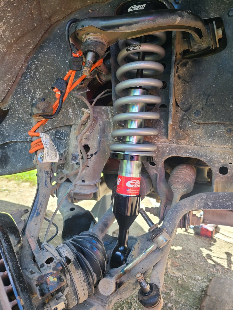

    Question? Why did you put the 1/4 spacer if you just adjust the driver side higher than the passenger for the driver side lean? Just asking due to doing that myself.

    Just to make adjusting height evenly a little easier most likely, thats why I did it.

    Yup and yup! To adjust both my sides equally, and hopefully not sacrifice ride comfort.
    But also, I mainly was trying to gain that full 3".
