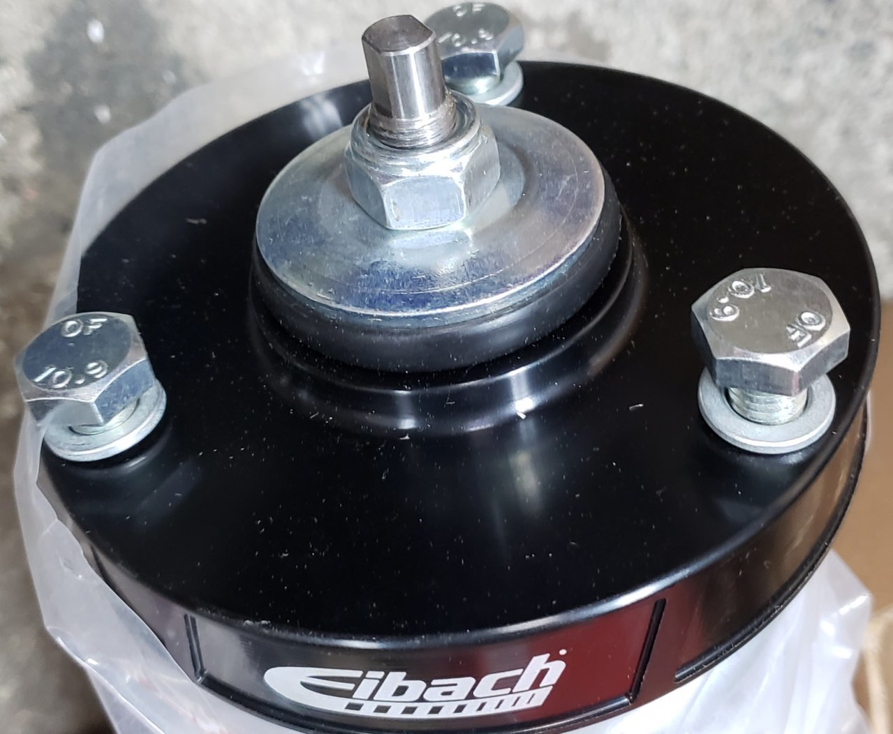

    No you don't needa touch the top hat or whatever what you do need is to buy longer bolts, atleaat 1/4 longer, anything past that you might dig into the top hat too much, or strip the threads. The bolts eibach provide is all though the right size, but too short to use with the 1/4" top plate spacer. Hope this helps

    I've forgot the size, but I brought the bolt from my kit to my local ace hardware, someone there should help you find exactly what bolt you need. At my ace they had a chart of bolts and nuts where you can screw then on and find the exact measurement of the bolt you're looking for

    M10×1.5, 20mm Grade 10.9.

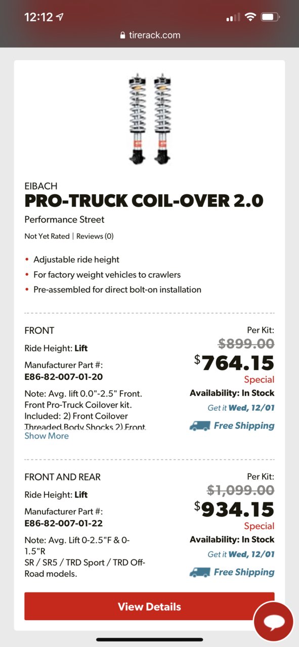

    Congrats! Installed pics soon, please!
    They are oos apparently for the pro 2.0 on the eibach site posted on the first page.
    managed to buy the fronts on another site
    $765 on tacoma beast and $80 a piece for the rears on extreme terrain

    Nice!! I got mine on their Black Friday special for $935 for both front and rear!
