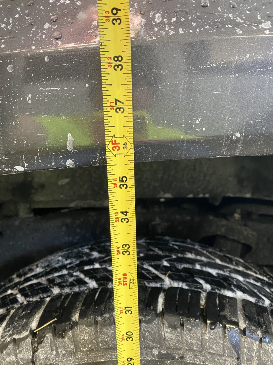

    I measured from the fender to the top of the tire. I actually dropped the right side to match the left. If I would have raised the right I think it would have made the front taller than the rear.

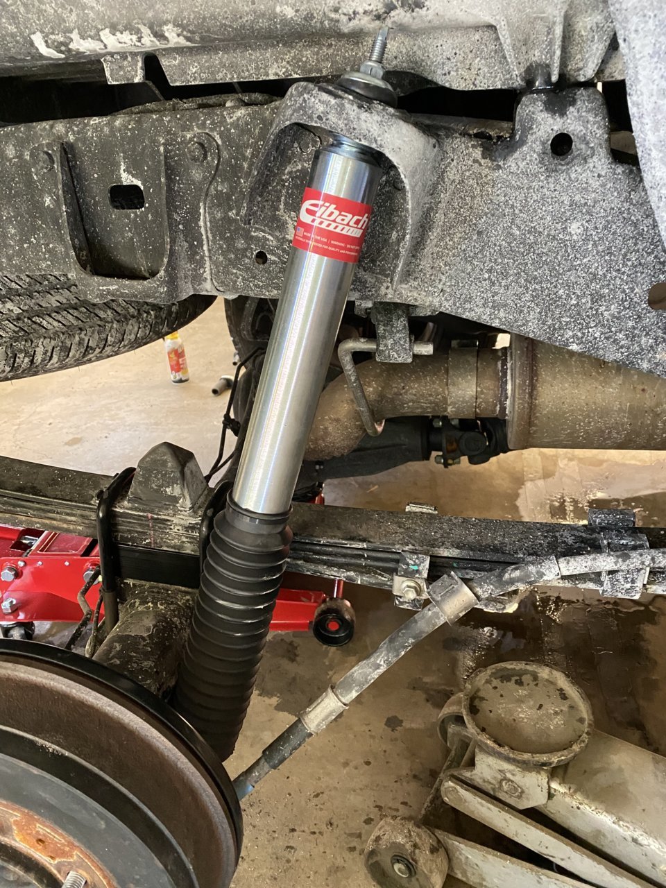

    7B29FBFC-7761-4441-A063-778731DD48FB.jpg 28C38979-5400-4617-A663-E8D2CFA2AFC1.jpg 931446F7-0E34-433D-B476-FF1C567BCC0F.jpg 7B29FBFC-7761-4441-A063-778731DD48FB.jpg Today, I put on the Eibach Stage 2 suspension kit with the Headstrong Off-road 3 leaf AAL.
    The single best modification I have done to the truck so far. I have a bump leaving my neighborhood that used to shake my bones from my toes through my teeth with the stock Sport suspension. Feels like nothing now. Haven’t tested off-road yet, but I’m very pleased that I purchased the Eibach Stage 2 suspension kit.
    I was heavily debating this set and TRD PRO Fox take-offs. I called around to nearly every shop within a 100 mile radius and no one rebuilds Fox shocks here. That was ultimately the deciding factor for me, and I think I made the right decision.

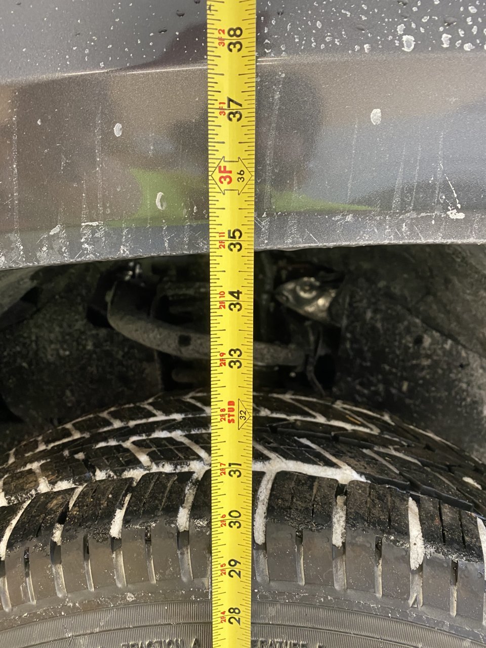

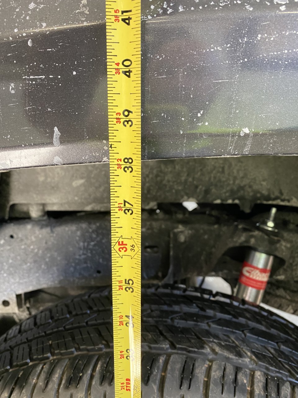

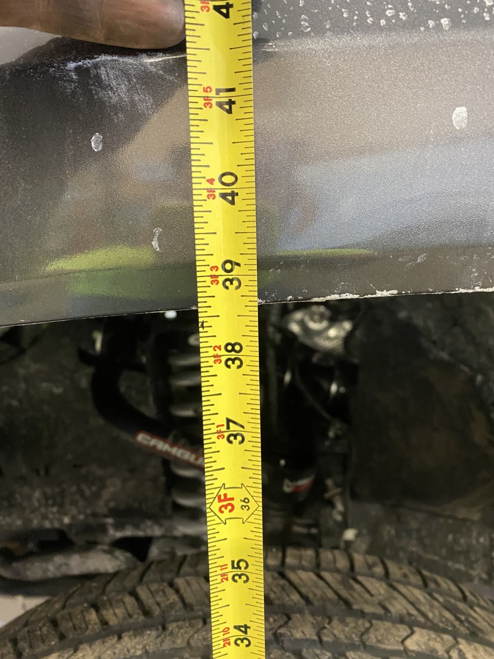

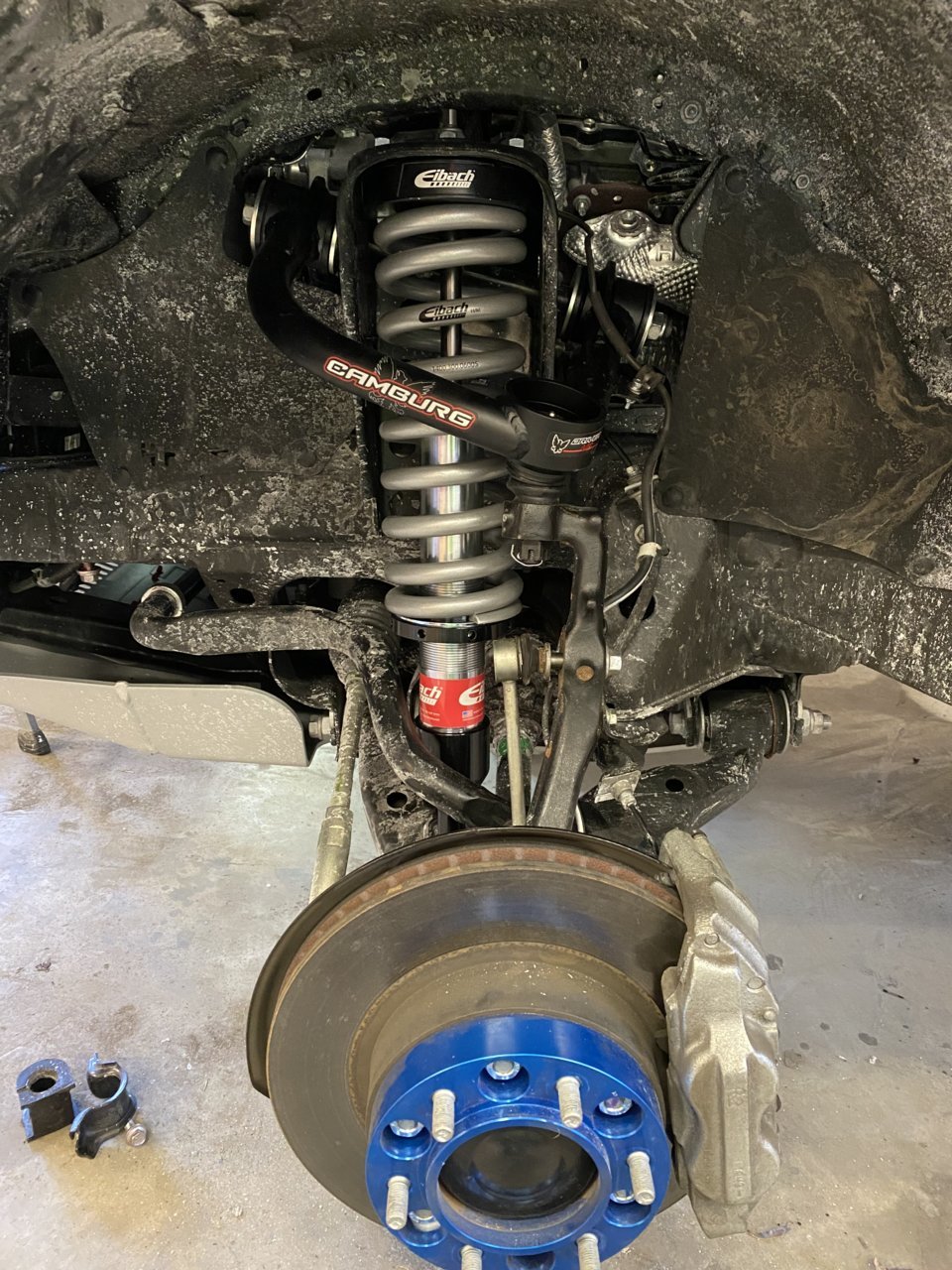

    Got my kit on this past Saturday… super easy to install. Only problem we had was while replacing the UCA’s. The driver side through bolt was a bit of a pain in the ass due to the ribbing under the battery tray around the pinch weld. I left the factory spanner collar settings where they were. I was told it was set to give 2” of lift. I also installed 1/4” HS spacers. I wanted to get around 2.5” of lift total, but did not want to compress the springs any more and sacrifice ride quality. Paired the front with Eibach’s rear shocks and Supreme Suspension’s 1.5” billet aluminum blocks. I know, I know, should have done a leaf-pack, but it’s mostly a pavement queen that may see the occasional fire trail… so this’ll do for my application for now. And just to be safe, I added a set of Camburg UCA’s.
    21CFFED7-DBEA-41A0-8F81-E10783E2F0EB.jpg 669B2B6C-EEBB-4235-A3DA-0E11FA38F4BE.jpg
    I gained more than I was expecting… in the front (measuring from the ground to bottom of fender) I gained roughly 3.75”!! Now this has yet to “settle” and is way more than I was expecting! As for the rear (same measuring as front) I gained 2.5”!! Again, a lot more than I was expecting and hoping over next month or so it settles down a bit.
    C0008B44-2813-4221-B5B9-6C64642F5ABE.jpg BDF5E61D-E8D9-4DEA-9FA4-6C592722D0F7.jpg 254861AC-76BD-44D0-A92E-48CB70F93FBB.jpg C8600858-2BBC-4E8E-95AC-FB54E3A1947C.jpg
    I am having a somewhat major concern though… my CV boot angles. Again, I got a lot more lift than I was expecting and now my fins on boots are touching. I have been looking into hi-angle CV boots to fix this problem… but before I go yanking the axles out and doing all this again, I think I’m going to try the “boot slide” method. Seems like a lot of members on here have had great results with this mod and I’m looking to get the same results.

    I'm not sure how you could have got that much lift. Are yiu sure everything is assembled correctly? Correct part numbers from Eibach?
    Taco1004 likes this.

    All part numbers are correct. As you can see via the pictures, the spanner collar is just about in the middle of the threads. Kind of hard to assemble it incorrectly when it comes pre assembled. Like I said, I did add the HeadStrong 1/4” top spacers, but that should only have added an additional 1/2” of lift. I only have driven it about 75 miles since the install and it has been extremely cold here in MD… so maybe with the temp making springs stiff and the lack of drive time, it isn’t had a chance to settle as much as I would like. I measured the front and rear about an hour ago… the rear has not moved and the front has settled about 1/4” so far. I’m still baffled myself?!?!

    I’d probably pop those spacers out and that should drop you 1/2” and let it settle without damaging your boots. With 1/4” spacer on both sides, how are you for taco lean?

    A 1/4” top plate spacer is meant for non-adjustable suspensions. It would be wise to remove that and adjust your coilover to 1/4” higher instead. Measuring from the center of your hub to bottom of fender is a more accurate method of determining lift: factory front is 3rd gen height is 21”, so over 23” can be problematic. Do you have a photo of your CV angles and also ball joints?

    Drive it around the block a few times and it will settle quite a bit
