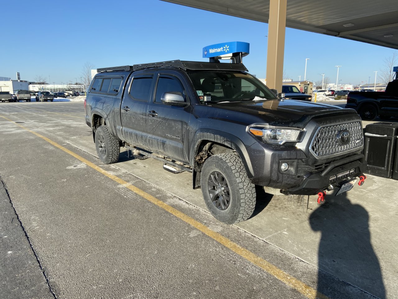

    We did mine a few weeks ago, but installed the swaybar relocation bracket and I have no clunks. The sway bar is the only thing I can think of that would make a noise like that...Skid plate is tight, shouldn't be making any contact with UCAs etc.
    If you did not get the sway bar relocation with the stage 2s reach out to Eibach, it should have been included.
    The other possible thing would be if you cranked them all the way up and are out of down travel, but that seems unlikely.

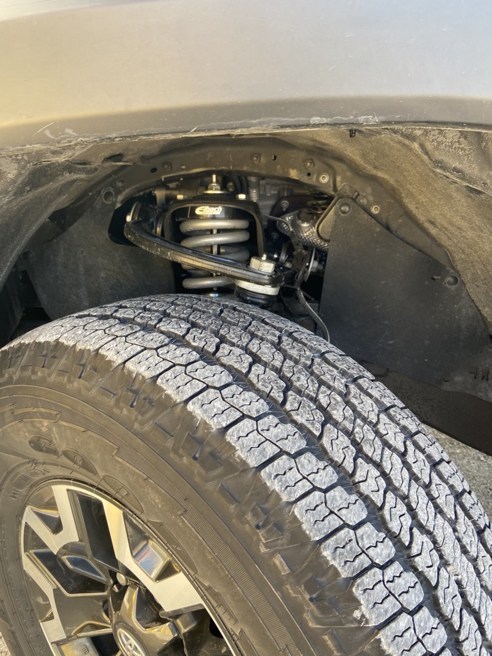

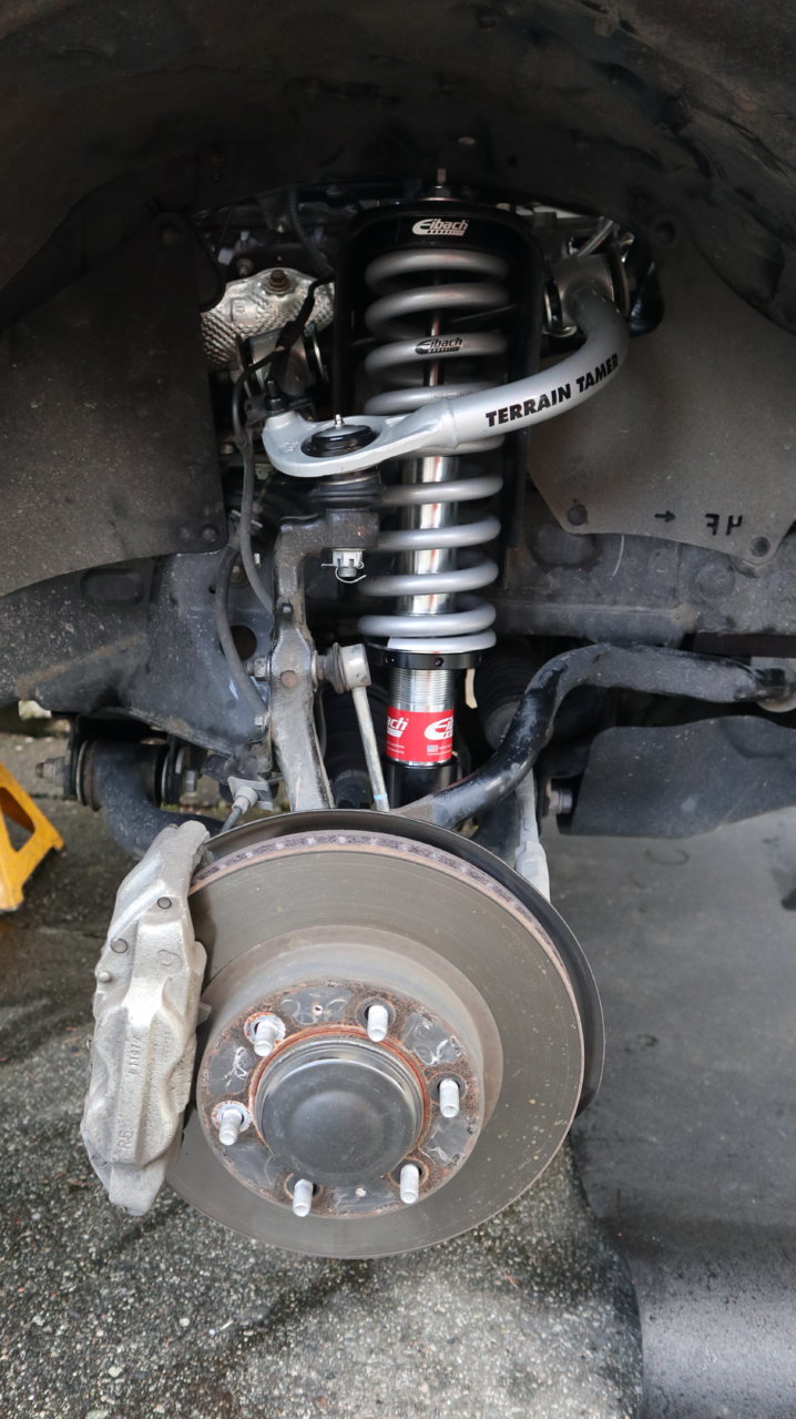

    I installed my kit on Wednesday/Thursday last week. I am really happy with it. No more jitters after hitting a bump from the factory Sport Hitachi shocks! The only noise I have is the front sway bar bushings groaning over larger bumps. I might remove it completely and see how it feels without it.20220302114248_IMG_0873.jpg 20220303142645_IMG_0898.jpg

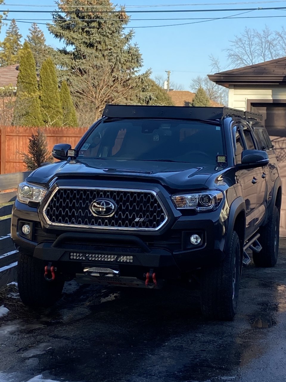

    Mine came in at about 1.8 inches.... that's where mine will stay. I am quite happy with it.

    Was that with the bumper and winch? I didn’t take pre-measurements but I’m around 22.25” center of hub to fender. Which I’m thinking is about the same 1.75” (slimline, 12k winch, light bar).

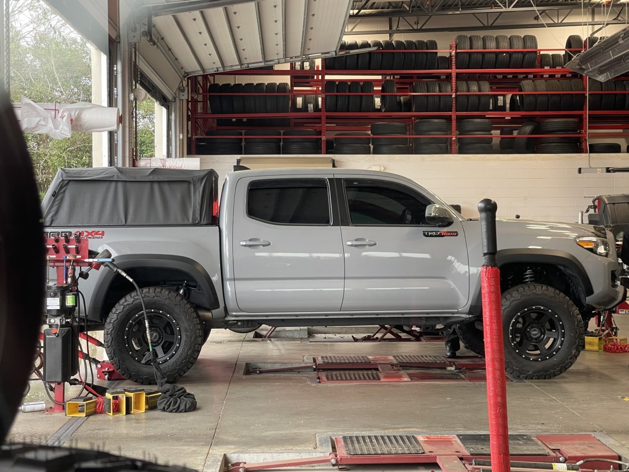

    Just got the new tires on finally, back for alignment hopefully I’ll be done messing with this lift and tire swap.

    Scratch shit still don’t driving right. Wheel wobble and worsens with speed. Got alignment after tires adjust the toe in it had and still there. They tried to feed me some bs about it not being alignment problem or tire is coming unglued…back to get balance checked again! This wouldn’t be a swaybar problem would it? I don’t think I would but idk people run it at hwy no issues

    Wobble is something not mounted correctly or something failing. The swaybar will have no effect on this. A tire separating could cause it. So could a hubcentric issue. I would be looking over all the rotating parts in the front end starting with the tires and move inwards to the hub and axles.
    Edit: Start with the basics... is the wheel mounted correctly to the hub?
