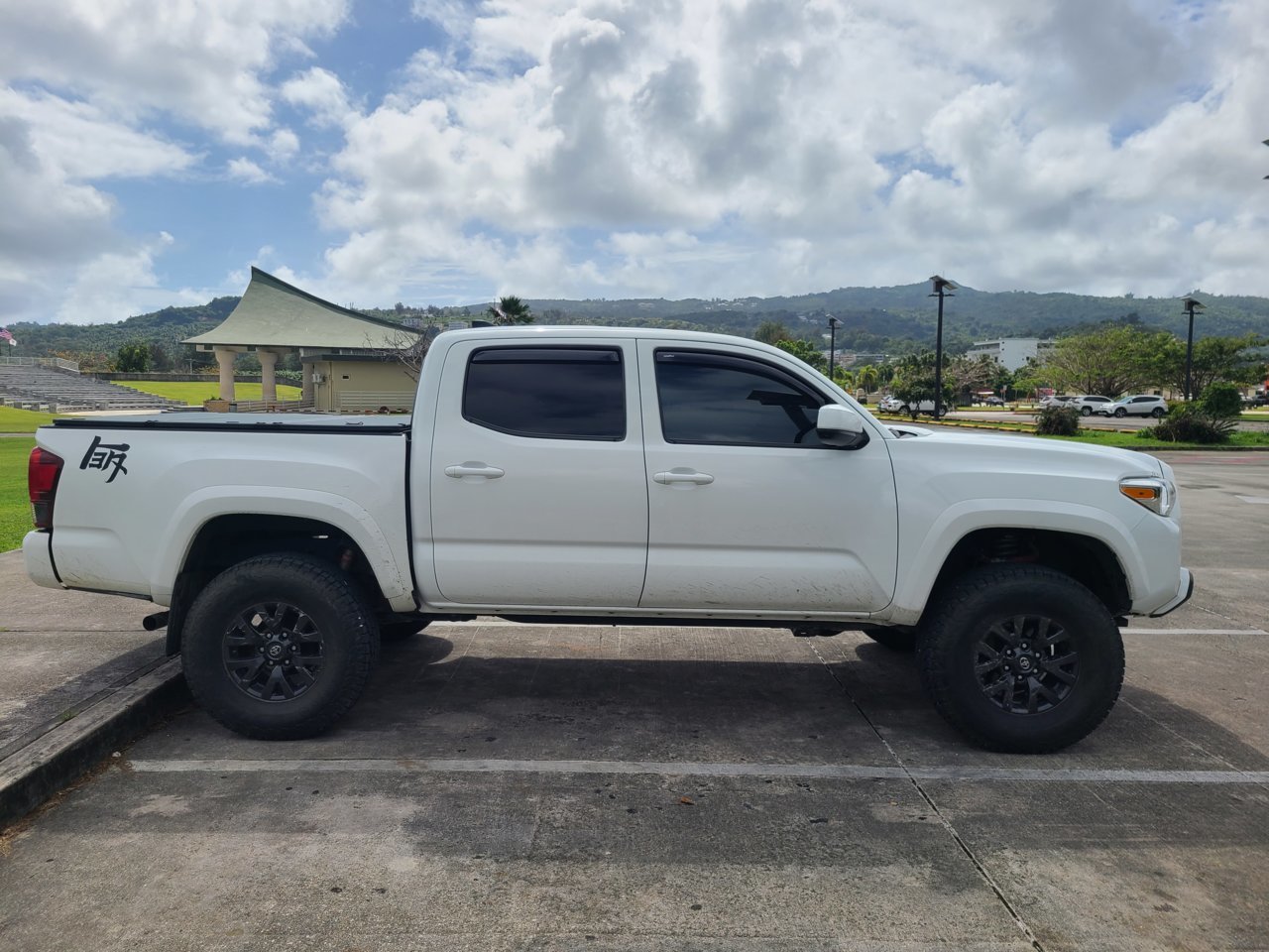

    Anyone topping out the stage 2 coilovers? Mine happens very often.. even when set at 2.5" of lift.

    Here's mine, 2.5" front
    2" rear with wheelers aal.
    I've dialed mine down since the first install, never went any higher.
    Even my buddy hadn't adjusted he's since the install and he tops out even going over big speed bumps.

    Looks good.

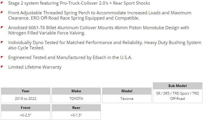

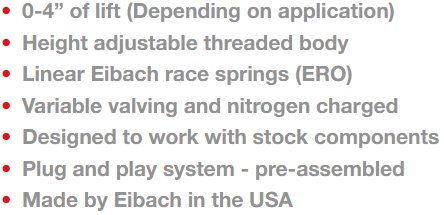

    WOW great pricing! Have a quick question as I've been waiting for improvements and additions to the 3rd gen Tacoma suspension market.
    The Pro 2.0 front and rear package states that it has a 4" ride height adjustability, but on the description inside the package details it states up to 2.5".
    My question is - for the Tacoma application - are the threads limited to 2.5" inches of adjustability or can you take it higher to 3-3.5" with the addition of a proper UCA? Also, the rear shocks for the 2.0 kit state they are also adjustable up to 1.5". Do these adjust the same as the front(haven't seen any pictures of the rear shocks), or does the height just depend on what springs/AAL/Block you have sitting in the rear?
