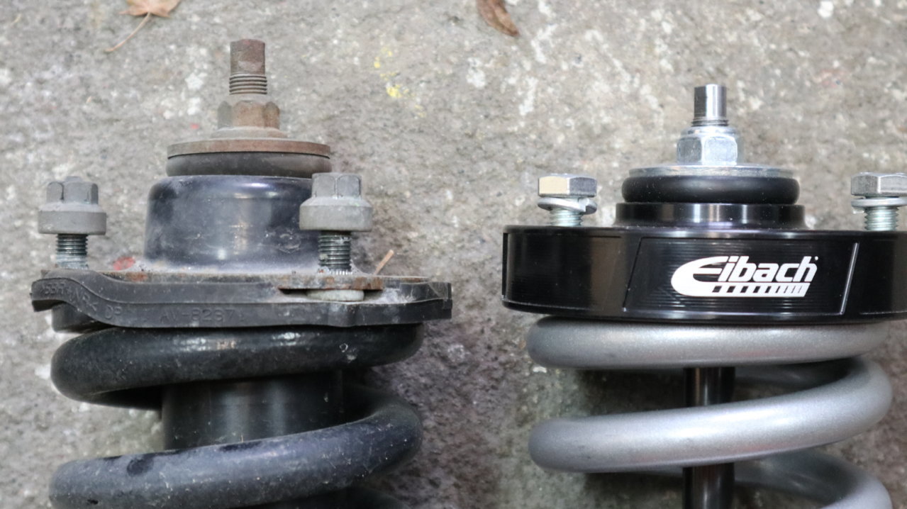

    They state 0-4" depending on application. Tacoma is not one of those applications. It states 0-2.5" for those applications. As for going higher... that isn't really recommended.. let me share a video with you...
    https://youtu.be/_68Hc8GtLko
    He also just put out an awesome video on UCA's that is well worth the watch.
    If you want more than 2.5" then really you should be looking at a drop bracket kit.

    In the world of IFS its amazing that a lot of the information and advice provided regarding suspensions stems from the typical SAS theories. This guy nails it right on and breaks it down perfectly specifically for IFS! I've added his Part 2, and he mentions a Toyota sway bar video going over the Toyota sway bars which also ties into IFS suspension changes that he mentions in his part 1 and part 2 videos. I'd link but not able to find it as I'm at work.
    4 Common Myths About IFS Lifts | Everything About Toyota IFS Part 2 - YouTube
    According to the information he explains it appears I'll be looking for a 2-2.5" suspension lift with a 1" body lift (previous idea) or (New idea based on the 2 part videos) a 1/2" top place spacer to achieve my goal of 3-3.5in lift, as long as I account for the amount of shock travel I have left at full bump to play with.
    I'm trying to avoid a drop bracket lift at all costs if possible. Top plate spacers look to be the cheaper and less labor-intense alternative to a body lift kit while achieving the same goal (I'm doing all labor/installs myself).

    Here is a picture, comparing the top mount of the factory shock vs. the Eibach.
    The upper mount of the shock is clearly lower than factory, so not sure how much wiggle room there would be for a spacer on top of that. A ½" might be fine though.
    I had the lower mount holes lined up for this photo. So this shows that the Eibach is an "Extended travel shock" even though the do not state in on thier website.

    That's a great comparison between stock and the Pro 2.0's. Wondering if Eibach will chime in and confirm / back the extended shock info - If they confirm this will more than likely be the route I end up taking for sure.
    @mark@eibach , @Ryan at Eibach
    The mount on the Eibach is fairly thick and the bolt lengths may not account for an additional 1/2" top plate given the shock travel allows it to be added to the setup. Might need longer bolts maybe? I'm formulating a plan of attack on purchases and this route so far seems to be the most valid while being a good choice dollar for dollar!
