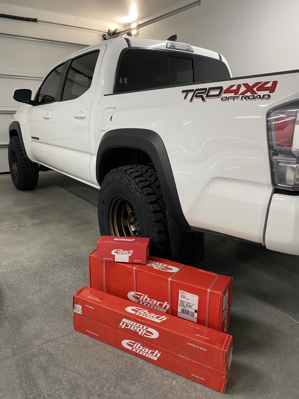

    Stage 2 kit with 1in rear block
  8. Jun 3, 2022 at 6:20 PM
    #808
    donttacoboutit
    donttacoboutit Well-Known Member
    Jan 31, 2022
    #388902
    106
    Jon
    South FL
    2022 4x4 TRD OR MT CSM
    Man this looks incredible! Did you set the front to anything in particular or put them on as is out of the box? Does it actually lift the front by 2.5 and rear by 1.5? Thanks for any info

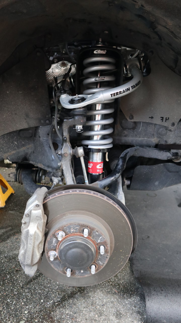

    Technically you don't need one. Toyota puts on a similar lift without changing the upper control arm. If you wanted one... then there are lots out there. I have a Terrain Tamer UCA which is a rebranded OME.20220303142645_IMG_0898.jpg
    If I were to do it again, I would probably skip the UCA.
