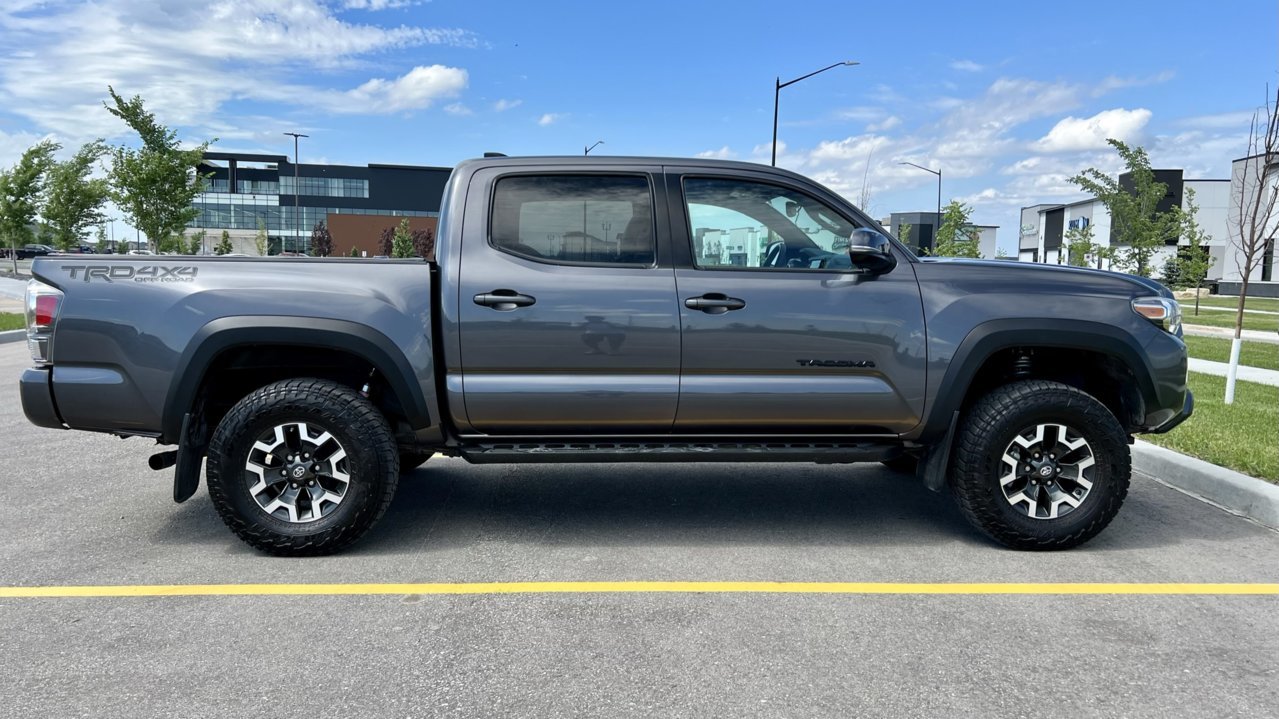

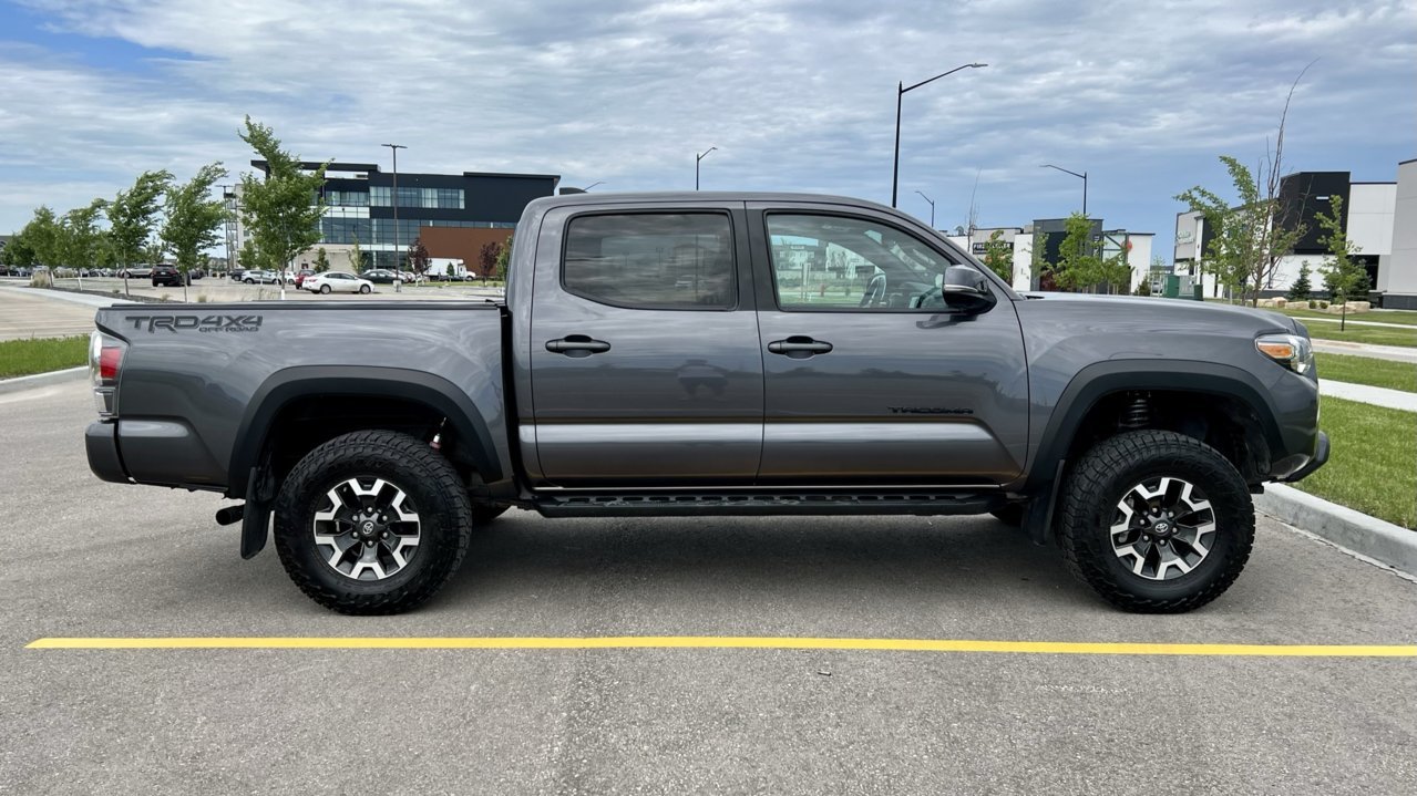

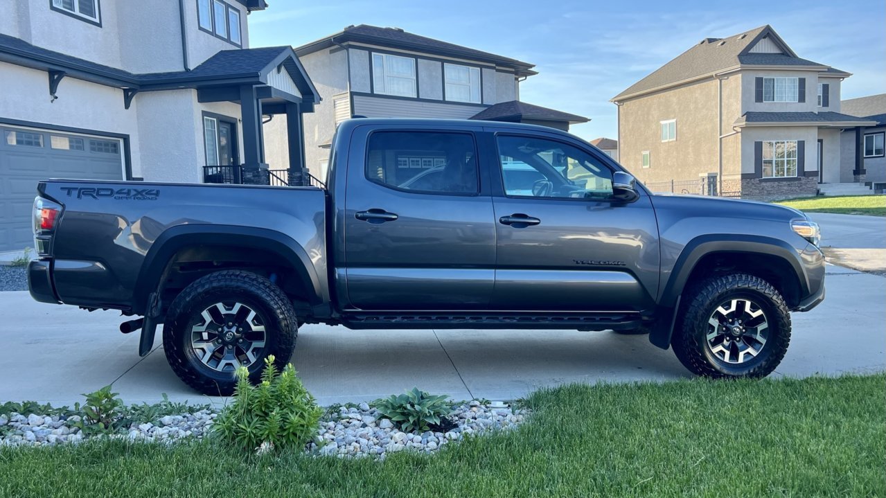

    So I got this kit on today, stock wheel size, no rear block, set to level which was just under 1.5" front lift. I'm happy with it and probably won't go any higher front or rear with stock tire size...i think it would look funny.
    I know the photos are not as impressive as the other ones on this thread but though I'd share in case anyone wants to see a front level with OE tire size.
    I did this install by dropping the LCA. To be honest it may be the same amount of work doing it by undoing UCA and tie rod. One way you have to keep an eye on your camber/caster (to keep it close enough to get the shop for alignment) and the other, you have to beat the crap out of your spindle to release joints. Pick your poison I guess.
    One thing that caught me off guards with the LCA method is the inner CV joint/spline axle popped out. Took me while to get it back in (due to my inexperience with it).
    I have nothing bad to say about this product. First drive today felt very good.
    @dcarcagno I beat you to it but thanks anyway!
    BEFORE (stock OR suspension)
    AFTER (Eibach Coilovers set to 1.5" lift)
    OUT OF THE BOX (Set by Eibach at about 2") - you can sort of see the front end higher than rear

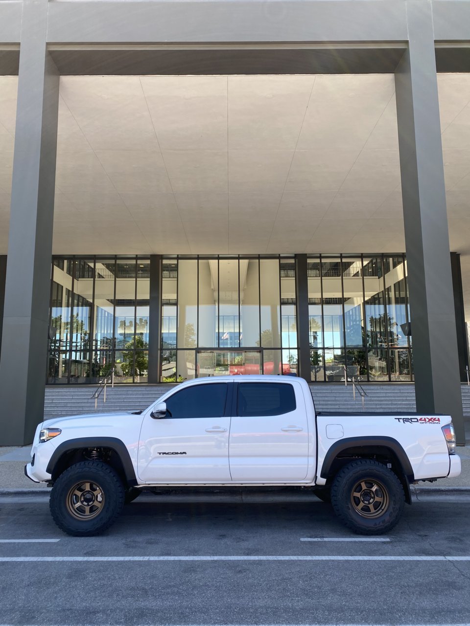

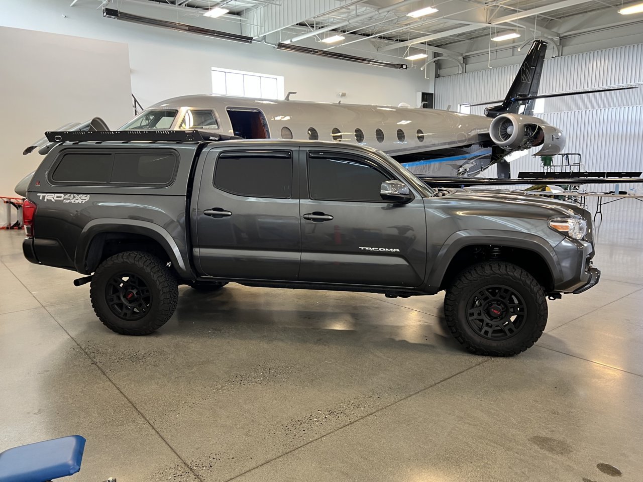

    Crap! Sorry! Haha. Here’s a pic with rxt on option 1 with eibachs set for 1” lift. E66A12CA-D617-42D5-A881-92F2553CB7E8.jpg
    next is rxt option 2 with eibachs set back to what they came as.
    FishnTx and DanishTaco like this.

    Wow, awesome photos. Truck looks great, and so does that jet.

    #318487
    27

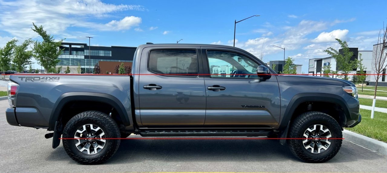

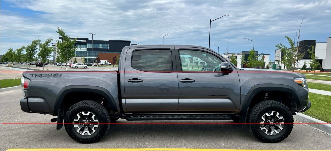

    Looked at my photos a bit more and I have to correct myself. My adjustments to 1.5" front lift equalizes the wheel well gaps but there's actually is a bit a rake left. Whereas Eibach's out of the box settings at 2-2.25" front lift puts the trucks body DEAD level (but with uneven wheel well gaps).
    You can see how the "level" line in the second photo lines up with the bed and windows. So, Eibach definitely has there out of box settings dialed in for level. I will still stick with 1.5" though.
    1.5" LIFT (still has slight rake)
    2-2.25" LIFT (body dead level)
