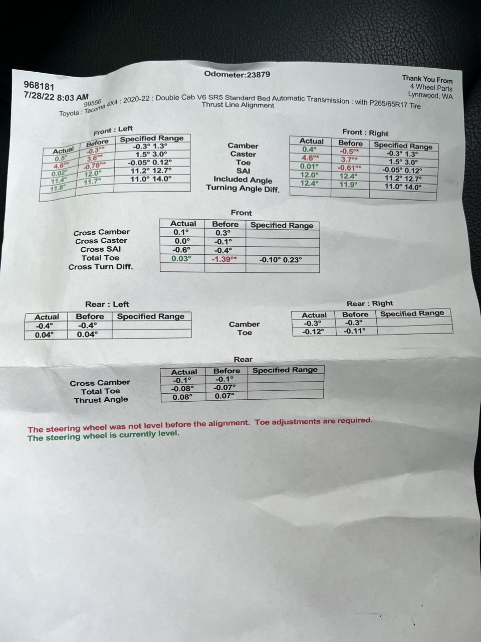

    How’s this look for an alignment? I’m getting some vibrations at around 65 ish. D53C7D6E-8534-4D64-8539-C7C31CCABC73.jpg

    Not bad, could be a lil better. Did you adjust the coils after installation?
    And that sounds more like a tire issue? New tires, not balance? Maybe you got aggressive mud terrains?

    I did adjust the coils down a bit. Started after new tires and uca. I have ko2s

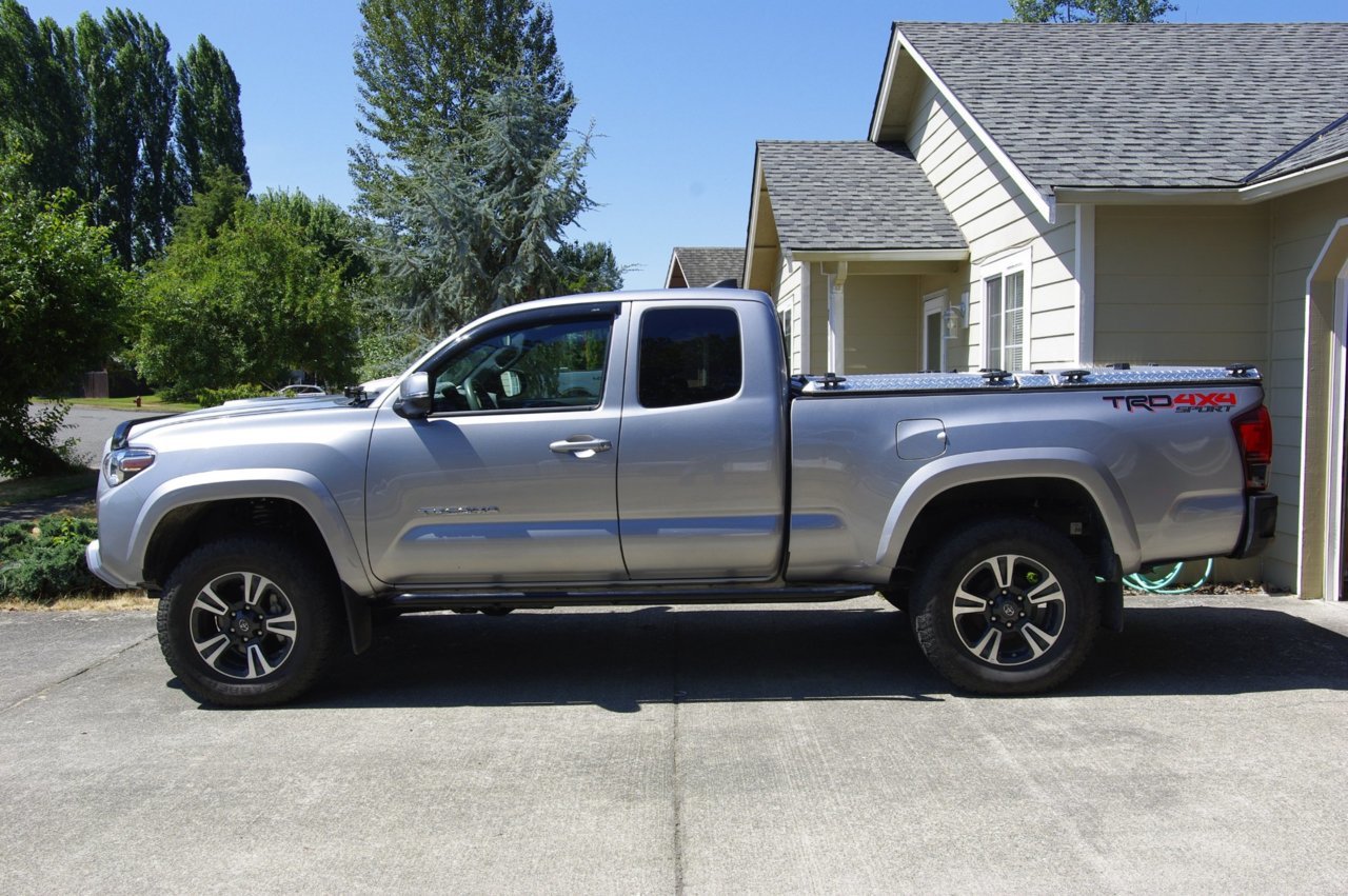

    So at just 9k miles on my truck I just got my new Pro Truck Coilover 2.0 Stage 2 kit installed and got it aligned and it rides SO much nicer now! I found myself looking for speed bumps because I couldn't believe they were completely absorbed...crazy smooth ride. I upgraded from factory suspension due to an RCI steel front bumper/winch combo on the way and needed to be able to adjust the ride height. I didn't know what I was doing so did not buy rear lift blocks and when I got it back it looked like a Calif cruiser with the front jacked way up and the rear squatting. Ugh.
    So I ordered and got the blocks and installed them myself (used a jack to lift the springs up to get the blocks in the hole) and it worked out great! Now it's level and I'm very happy. One thing though, I wish Eibach had made their spanner wrench even just one inch longer...it really does a job on the hands...(and yes, I finally figured out that I need to lift the cab before adjusting else they Won't Turn At All.)
    Driveway slopes slightly down to the left so it looks less level but it measures perfectly from hub to fender flare on each wheel.
