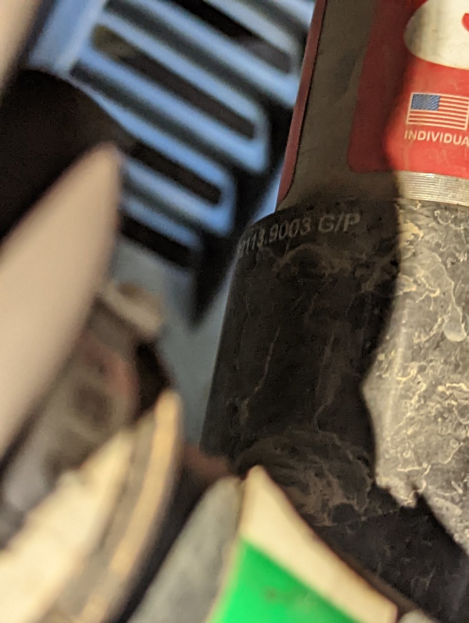

    @turner850 What's the two letters after the part number on the bottom of the black section of the strut assembly? Should be on the side facing the engine.
    Will be two sets of number, followed by a x/x letters. See example image.
    Please share the letters :)

    Mine say "H/Q"
    driver is 22" from center of the hub, passenger is 22 5/8"
    The rear is about 1" higher than the front after 5,000 miles. When I installed both coilovers it was perfectly level.
