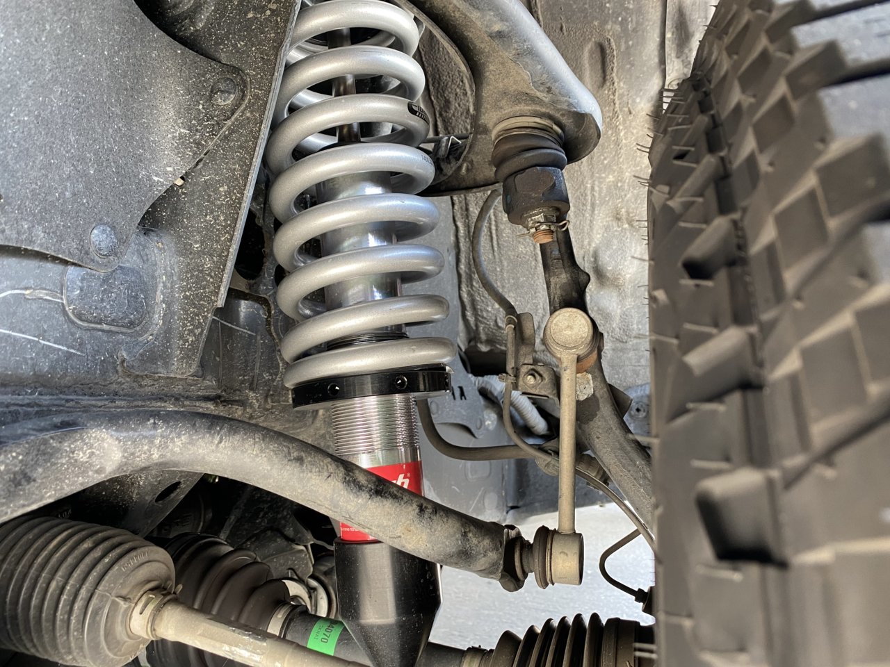

    Finally got them installed. The ride is a bit stiffer on the street but they take the bigger bumps well, feels more planted to the road on turns as well. I finished installing the front and back in under 4 hours at home so its easy to do with the right tools. Only pain in the ass is to find a competent alignment shop.

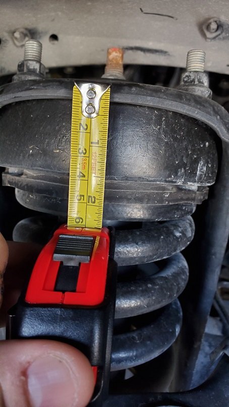

    This is my front spacer.
    question: It looks to be a 1.5 inch spacer, what lift did this give to my front end? I also have a 1.5 inch block in rear which im planning to leave in with new rear shocks for now.
    I believe the coilovers are set at 2inch lift from eibach, will that combined with the 1.5 inch rear block be level? or even better, provide a SLIGHT rake?
    Thanks for the help in advance.

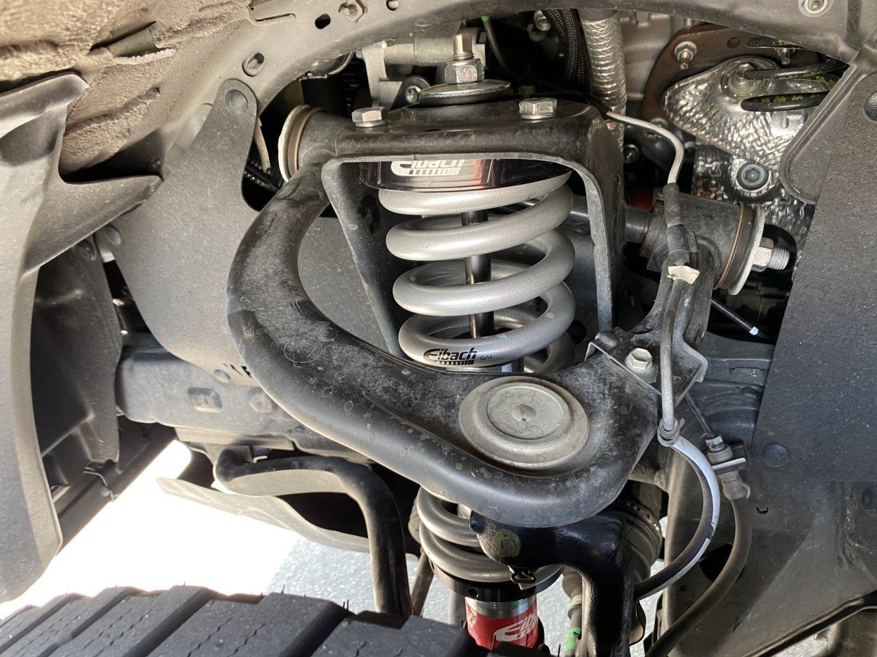

    Put this kit on the truck a couple of weeks ago including the rear shocks. Did wheels and tires at the same time. Love the feel, now I just need to sort the rear AAL or something also to level. Ft is slightly higher with out of box ft setting

    With a 1.5 block its going to give you a .5" of rake. Your rides going to be so much better with the coils compared to the spacer, you're going to love it. Make sure your your tires are not over inflated after install.
