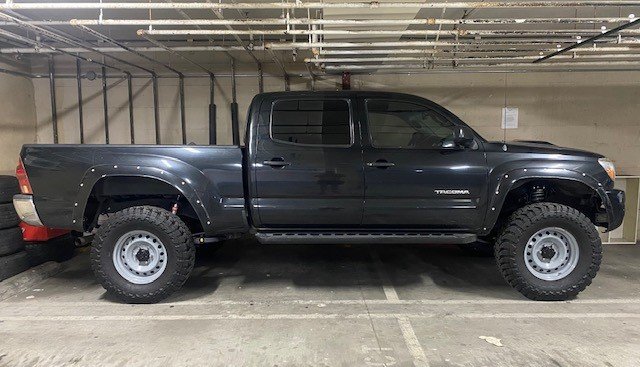

    Has anyone addressed the stiff ride when these are installed and a way to soften the ride? What spring rate are they? Do they eventually settle?
    This may be similar to a 3rd gen but I have these installed on my 2nd gen. Eibach's website doesn't say what the spring rate on these coilovers are. I feel every little nook and cranny on the road. It feels like the whole front end is going to fall off the truck when I go over speed bumps. Is there something I did wrong during installation? Seems pretty straight forward. Is it my wheel set up (FJ steelies on 35s toyo open country m/ts)? I heard the springs are meant for those with weight up front. It rides pretty smooth on the highway but on the street its pretty stiff. I am running OME medium leaf springs on the rear with the eibach shocks. I am planning on running a front bumper by the end of the month or mid january. Maybe the extra weight will help.
    Any insight on this set up would be appreciated.
    I have spoken to a rep at eibach and he said that though they are listed for 3rd gen tacoma, they will work for 2nd gens as well. The reason why they are not listed on the website for 2nd gens is cause they have not been tested for that generation. Maybe 2nd gens would run a different spring rate.
    pic of my turd.

    600lb spring rate. 3rd gen trucks are heavier so without any weight up front you might be over sprung causing the harsh ride. I have a slimline bumper and synth line winch up front on my 3rd gen and they feel firm but good and nearly a perfect ride for a truck. I could imagine them being a little stiff with 400lbs or so less weight on them...

    I figure the lack of weight is the issue. Good thing I am adding a bumper by mid January. Thanks for the feedback.

    The stiff ride will be more to do with the shock valving. These shocks are digressive and with your lighter curb weight that would make them feel stiffer.
    As for the spring, it supports the weight of the truck... if the spring rate was higher then it lifts the truck.. the spring rate really won't effect the ride unless the spring rate was really high.
