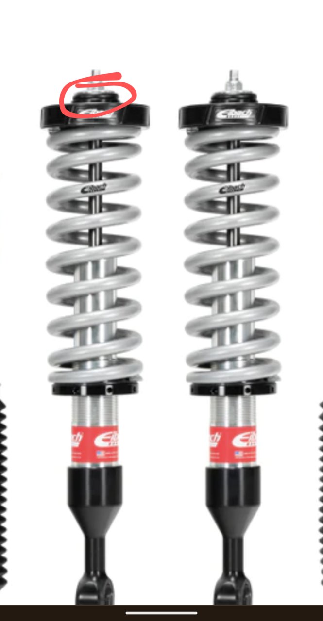

    FWIW I had a similar issue so this might be worth a try as a solution. The harsh bump noise may be similar to what was causing the same issue with my readylift 6112's. I have not had a close look at the eibahs in person but he top hats seem to be similar in setup. Alloy bracket sandwiched between 2 rubber isolators top and bottom.
    When there is not enough preload on the isolators the loading will reverse from the shaft pushing up from the shocks natural expansion to the spring compressing the top isolator with much more force. If there is not enough pre load in the isolators the bottom isolator will become slack resulting in a harsh noise/sensation, when the wheel switches direction again (pointes out in a video several pages back).
    Upon inspection everything always looked correct with the component assembly and retaining nut (isolators showing some preload buldge). As the nut bottoms out on a shoulder on the shock shaft, adding tigntness does nothing. I tried adding a couple washers to increase the preload on the isolators and all noise went away.

    Other than getting rid of the noise and harsh noise. No negative effects from it. When choosing a washer, just make sure it is large enough to clear the diameter of the shock shaft/shoulder (i reused some of the old suspension washers that came off in the install)

    This is the bushings that are part of the top hat assembly. This can (and should) be done with the vehicle on the ground. This will keep everything compressed when taking the nut off.

    Care to circle on an image where it is that you are adding the washer?

    Given your response I would assume you are referring to the highlighted nut, which yes is a bit risker then others.
    You just used a single washer for this? Tightening the nut wouldn't yield the same result?

    Yes I was referring to that circled but. There is typically a shoulder on the threads that will bottom out on and stop preloading the rubber bushings. The washers that are already on the shock may also bottom out and that would need checking too. How many washers and how tight? Have no spec other than "made them slightly pudgier than before".
