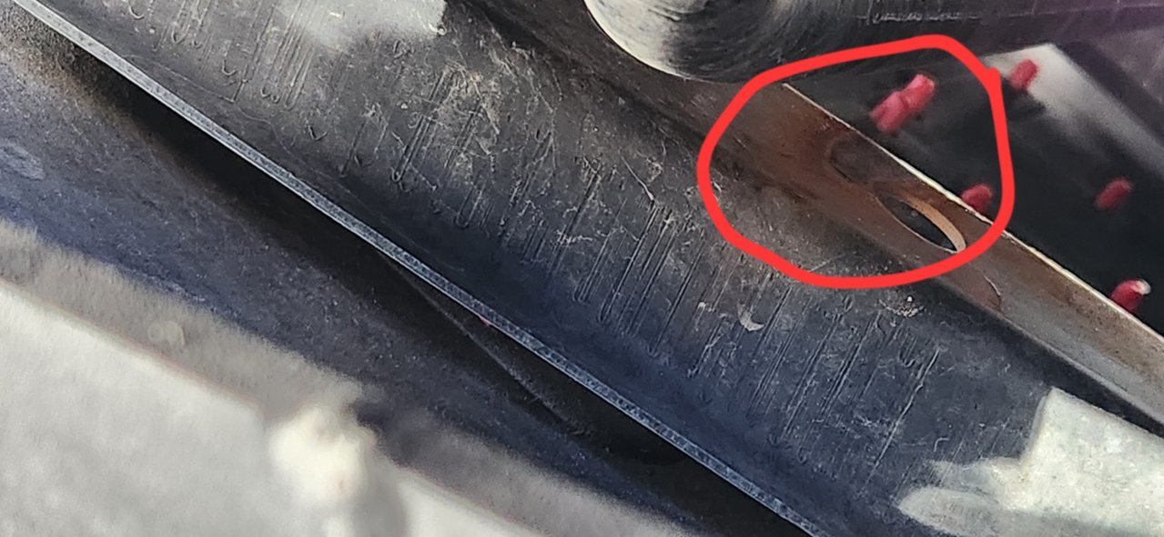

    I was changing over my winters to my allseasons today. I noticed something while inspecting for issues.... 20230315_110124.jpg
    The sway bar with the relocation bracket is selfclearancing itself against the crossmember support brackets. This might be the sway bar noise I experience going over speed bumps. I might have to remove my swaybar and see it this is the drop out hammering also but since I tried that once before, I am doubtful.

    moto.hermit likes this.

    I too have this issue, and I’m not buying the “too light for the suspension” reasoning. I’m a 3rd gen 4x4 with a steel bumper and winch and steel skids. Mine clunks over almost every bump like an old jaloppy. Fingers crossed they find something.

    It has to be a bad batch or something similar. I have a 3rd gen with RCI steel front bumper with full hoops and full steel under armor (front skid is TRD aluminum) and steel sliders. Lots of front end weight. I don't get any bumps or thuds and go 4-wheeling a lot. Perhaps I was just lucky? I ordered mine direct from Eibach on their website, if that matters.
    EDIT: also using factory UCA.

    Just installed mine. No clunking noise.
    Ran it with oem uca for about 1 week before upgrading to dirtking.
    Did the alignment and everything is smooth and good.
