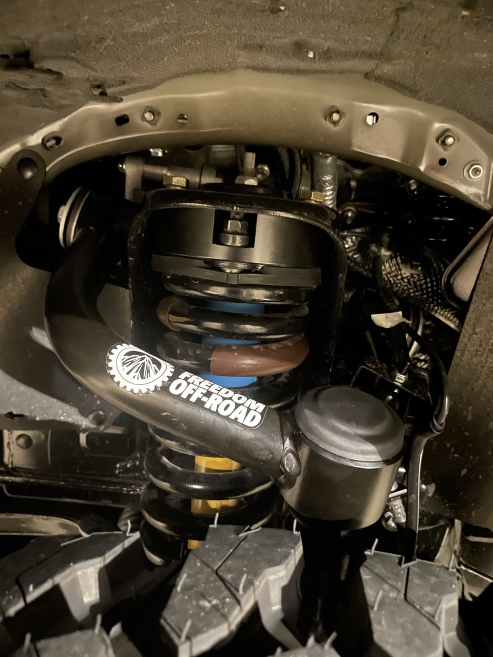

    I did. I only went up 2” And could not get caster into spec without aftermarket UCA’s which isn’t a big deal but I didn’t like the way it felt. So I added some UCA’s and all good. Perfect alignment all the way around.

  3. Apr 16, 2023 at 10:51 PM

    Eibach pro truck 2.0/2R lift kit 1.5" AAL OME/ARB UCA BFG KO2, 285/70-17 SCS Blaze 10, 17-8.5, -10 offset ECGS bushing needle bearing replacement Clutch accumulator disk delete Poor mans TRD intake, K&N 57 series intake tube, K&N high flow filter, TRD flow accelerator
    did the freedom uca change the caster at all or just give more travel?

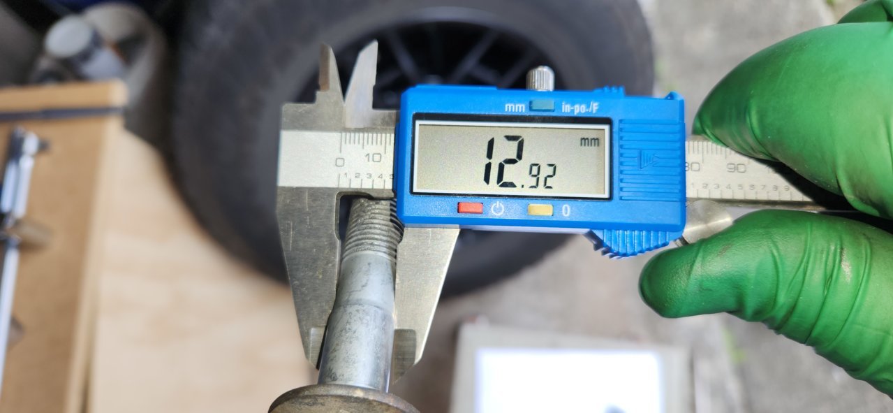

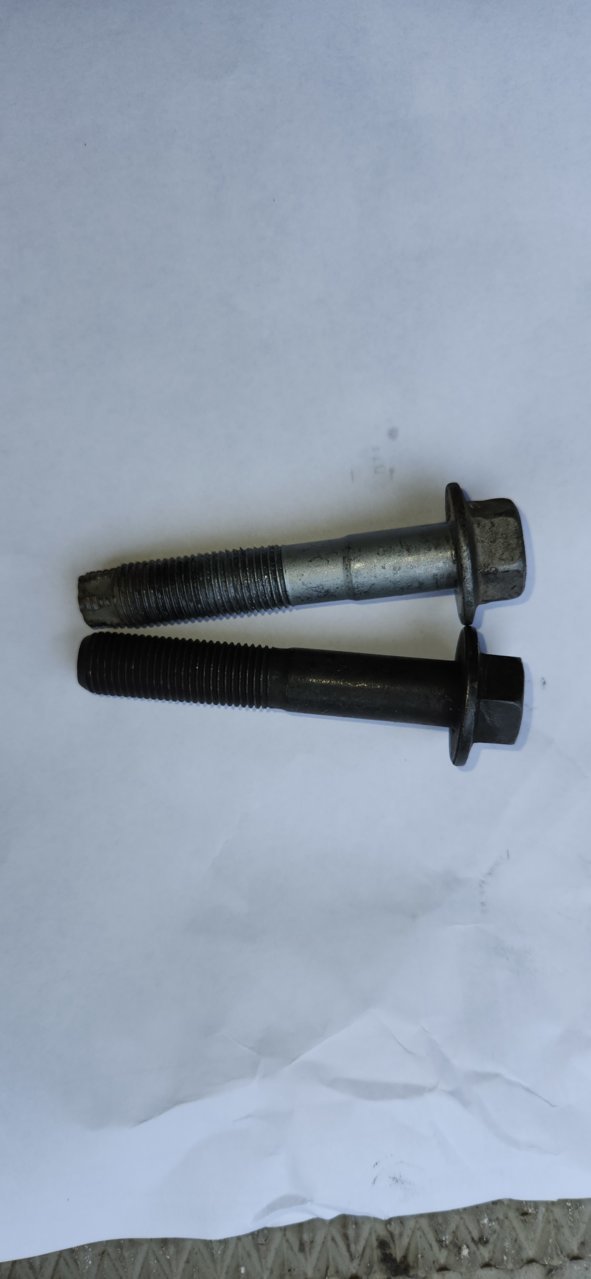

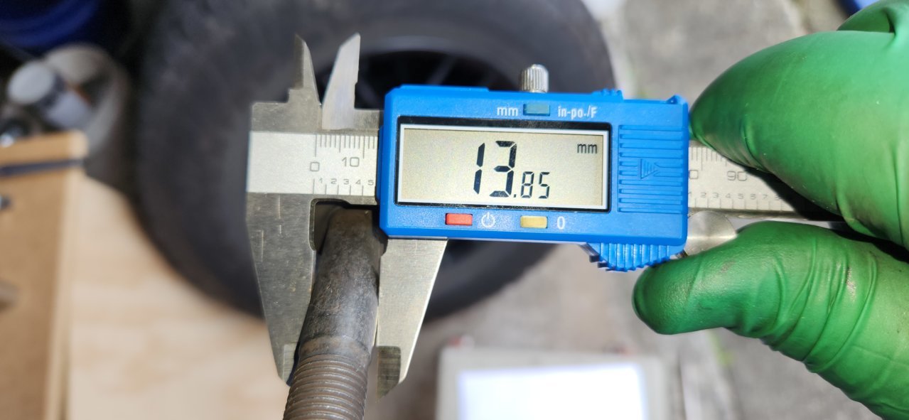

    I got under my truck today. I did 2 things, a swaybarectomy and swapped out the lower shock mount bolts.
    This is the new bolt vs. old bolt. You can see the step in the top bolt, which is the stock one.

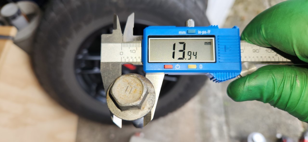

    These are the measurements of the stock bolt.
    This is the new bolt without the step.
    When I removed my stock bolts, I found no signs of movement in the bolt or bushing. I pried the lower shock out of the control arm and checked freeplay with each bolt in the bushing. I didn't see any big variations between the bolts. I installed the new bolts and torqued them to spec. I will drive it around and see if the clunk is still present. I will update later.
