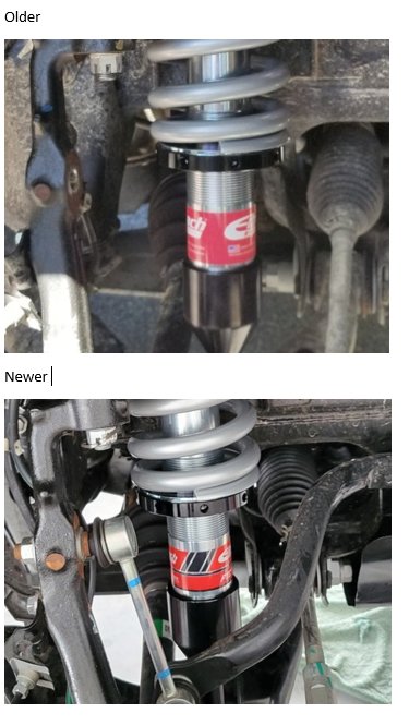

    Does this seem to be happening with the older version mostly?

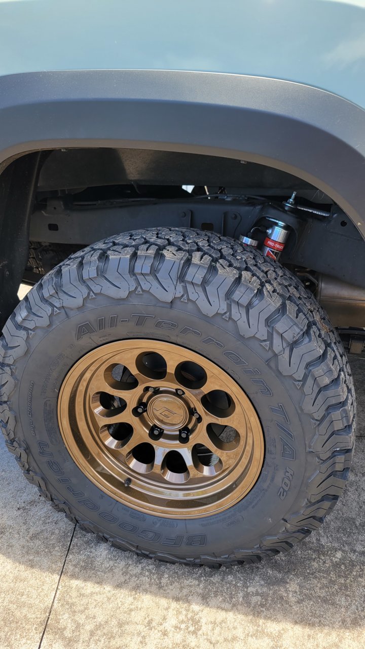

    This looks awesome! Nice work. Do you have the CMC done as well? I've been looking at this kit + aal and 285's. Just curious as to what all is required to run 285's.

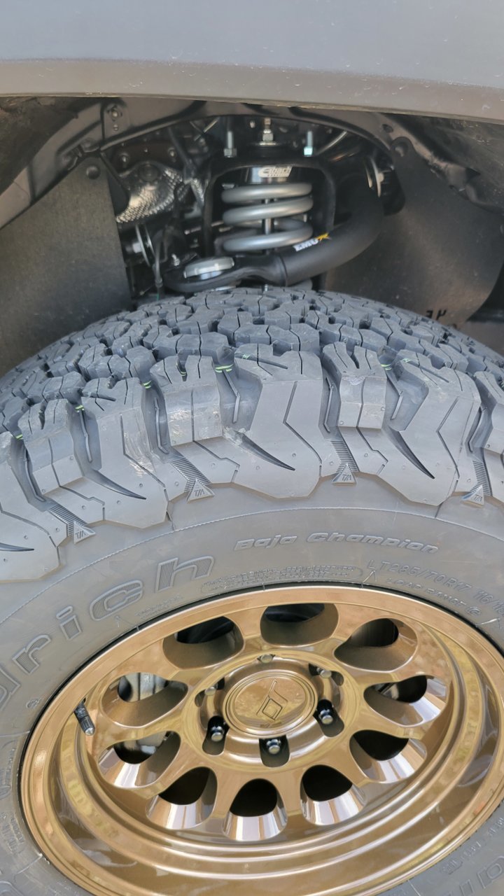

    FYI. I have this kit with icon rxt rear leafpack. Running 285’s. Zero rub on zero offset wheels 17x8.5.
    I only lifted it about 2.25” in the front as well

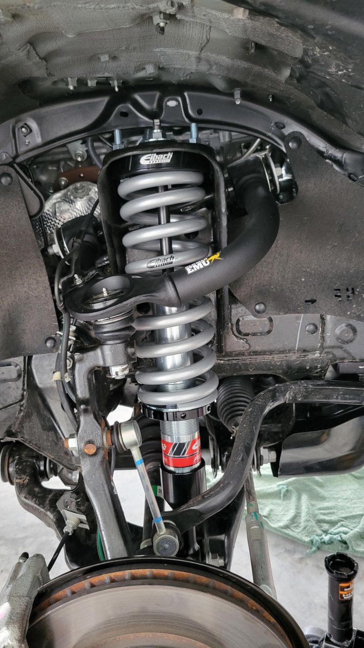

    Not sure. That first pic is of mine, and I dont have the issue. I think those stickers denote the stage 2 vs the stage 2R kits.

    Nice! This is what I'm looking for. Did you do the CMC? I have fifteen 52 16x8 zero off set as well. I'm looking at doing this kit with Icon 1.5" aal and Dirt King upper control arms. Did you have to add a diff drop kit?

    Not sure if the different stickers denote a newer version or not. I have the stage 2 front and 2R rear, but i actually bought the fronts and rears seperate because the full kit together was sold out. I have the newer looking stickers on mine, so i didn't buy it as a 2.0/R kit together

    I did not cut anything. I did remove the front tufskinz mud flaps but otherwise clear. I adjusted the coil overs 100x until I got them just right
    my wheels are wider than yours. You should be fine. Bfg and toyo run smaller than 32.7. Some tires run “true size” I believe. My BFG’s run 32” installed and clear fine

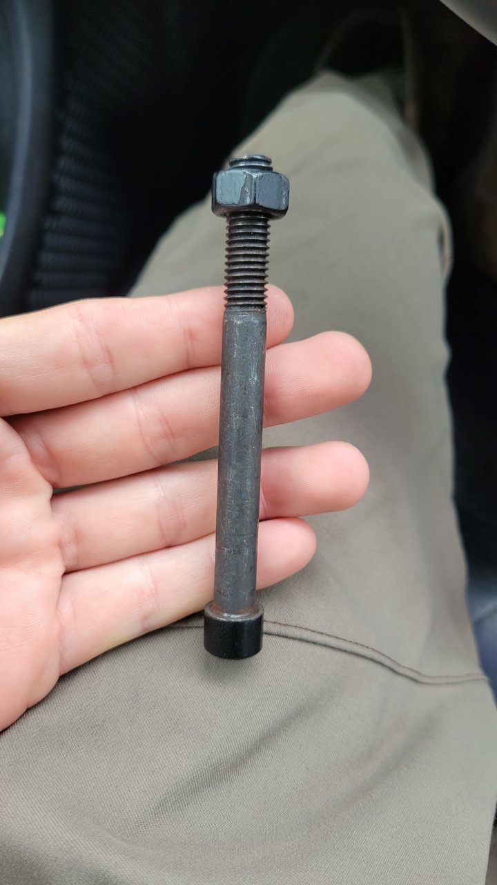

    Yea, i was surprised to get around 3" right out of the box. I actually went with a 1/4 spacer on the driver side for the taco lean instead of adjusting, that way i have the same amount of travel on both sides... that 1/4" spacer made both sides perfectly level without adjustment of the coilover
