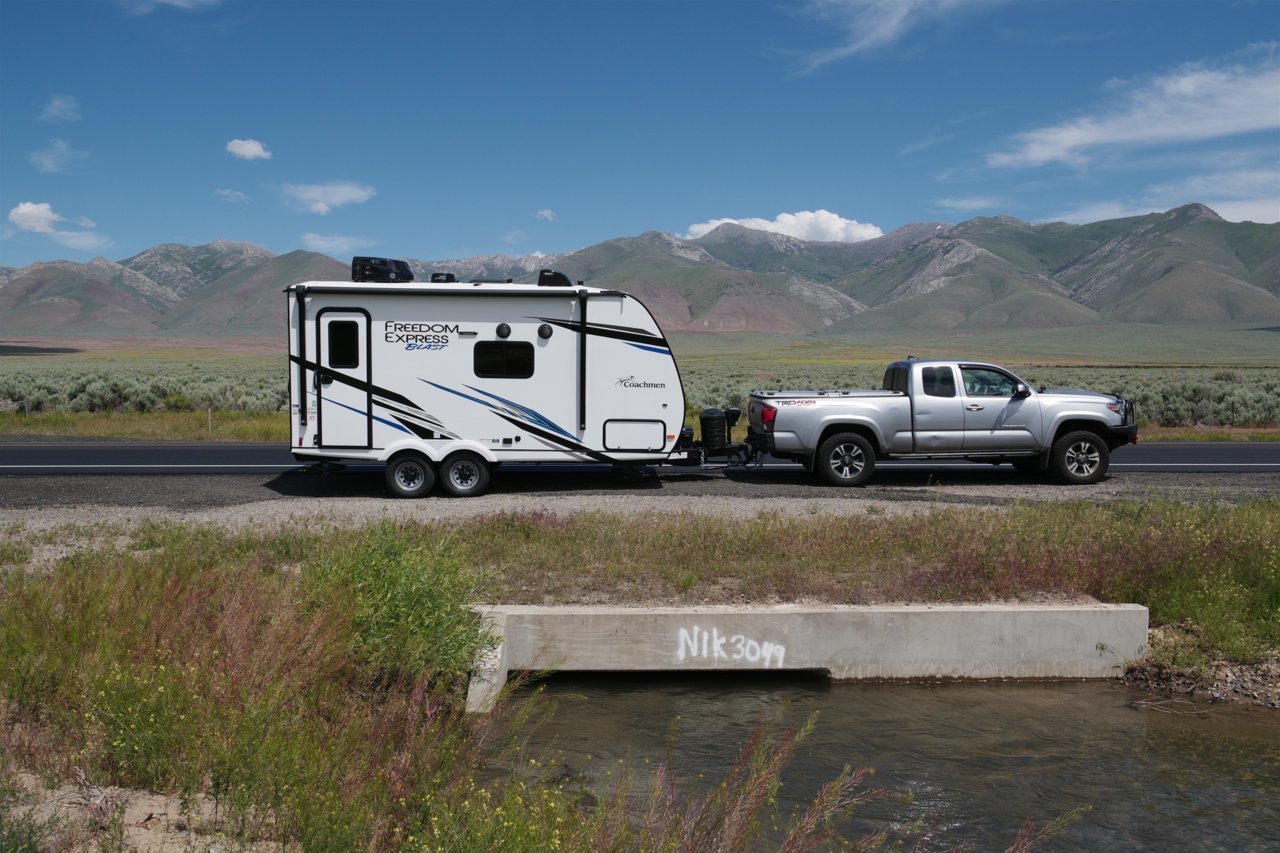

    Dropping a plug for how great this suspension is. Just got back from towing a trailer (with WDH) through WA-NV-AZ-NM-TX-CO. Was butting up to the GVWR for towing. The suspension showed barely any sag in the back and it absorbed all potholes and crappy roads the southwest threw at me! Some of the hits I took would have hurt my back really bad but it only bounced me hard--I'm sure the factory suspension would have left me in pain. I can't say enough nice things about this suspension setup and it is one of the best mods I've done to my truck. Sadly, the 3.6L leaves a bit to be desired, and yes I have a tune, and it is a manual so it could have been worse, but in all fairness I was pulling a parachute and going up into 7500' altitudes so it was expected. Got around 6-8MPG but I was pushing it hard.

    Just below GVWR for towing purposes with about 150lbs in the bed and full steel armor underneath with an Apogee Offroad steel rear bumper. That's a lot of extra weight back there...
    Note how there is very little sag in the rear. I have the Stage 2 system and did not add a leaf or use airbags. This is just the Eibach Stage 2 2.0 rear shocks and factory leaf springs doing their job.

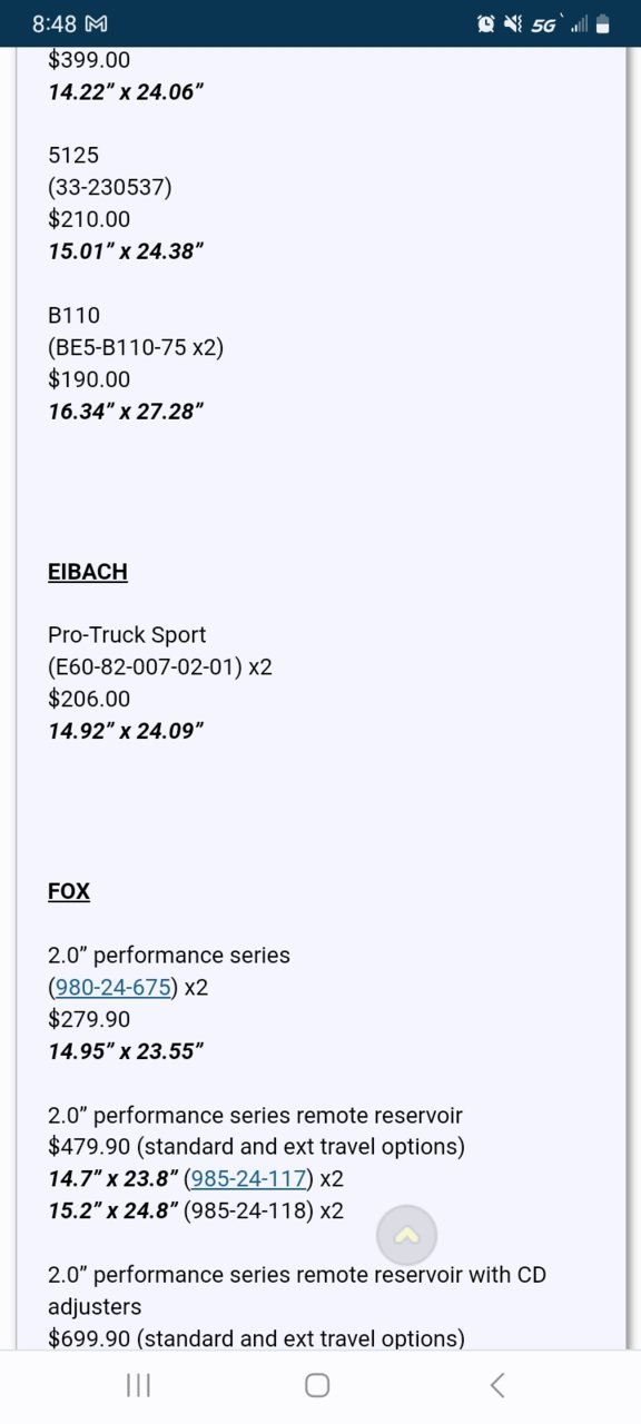

    59
    Does anyone know how much travel the rear shocks have stage 1 or stage 2? Seems eibach leaves out that information

    That's the stage one. I think stage two is the same travel but also has the resi
