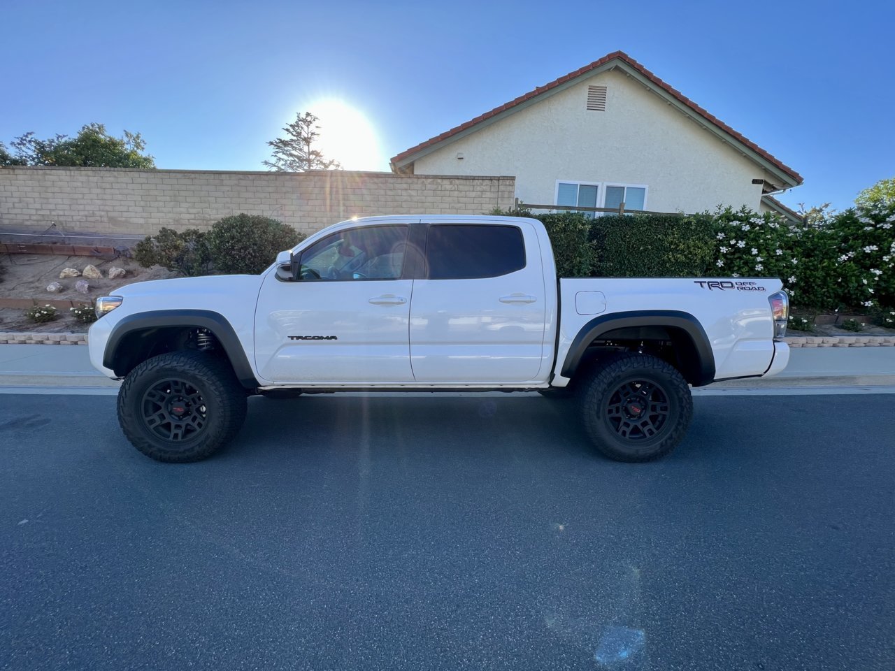

    Stage 2 installed today at a local shop.
    Kept it at 2” front and 1” block in rear.
    Center of hub to fender dead nuts at 33” all around. No clunk, feels great so far.upload_2023-8-25_18-11-19.jpg

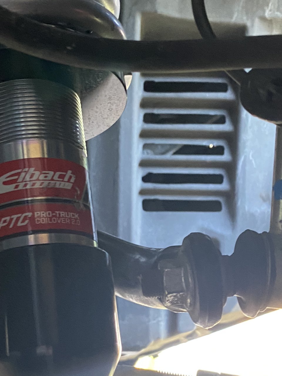

    Got my stage 2 kit installed and now have a clunk. Did anyone figure it out? I see a mark on the back of my coilover, is the sway bar hitting? We installed the relocation kit properly. IMG_6969.jpg
  8. Aug 26, 2023 at 2:13 PM
    #1328
    BaloneyPony
    BaloneyPony Member
    Aug 5, 2023
    #430602
    9
    Damn. Did mine yesterday and no issues so far. Are you getting clunk during normal street driving?

    Over speed bumps. Getting cmc tomorrow. Kind of annoyed with the clunk. I just loosened everything on sway bar and retorqued to spec. Haven’t driven around again yet to see if still there.

    So I paid to have a local shop take a look at everything (this shop installs a lot of eibach kits). They said everything was installed correctly, but they took off the relocation kit. The middle of the sway bar hits with the relo kit and it isn’t needed. This solved the “clank”… now onto the “thud”…
    The other noise I’m getting is from the eibach coilover thudding on full extension. Pretty loud, wife noticed it and cringed (she thinks it rides bad now). They said they don’t know why but almost all the eibach coilovers do this. Again, I didn’t adjust passenger at all, and only adjusted driver 2 turns or 1/4”. I’m still a tad front low with a 1.5” icon aal. I’m sure if I lowered the front even more it may help it not thud so easily, but then it kind of defeats the purpose of why I bought this kit. I should be right under the 2.5” they claim you can do on this kit.
    Eibach customer service wasn’t really great either. Maybe they would have eventually got to the solutions, but a week in and still answering things like what is my VIN.
    Anyway, hope this helps someone else and you don’t have to pay a shop like i did to remove the relocation kit. Honestly it was a badass shop though and I was happy to give them my money. Will be purchasing future upgrades from them for sure!
