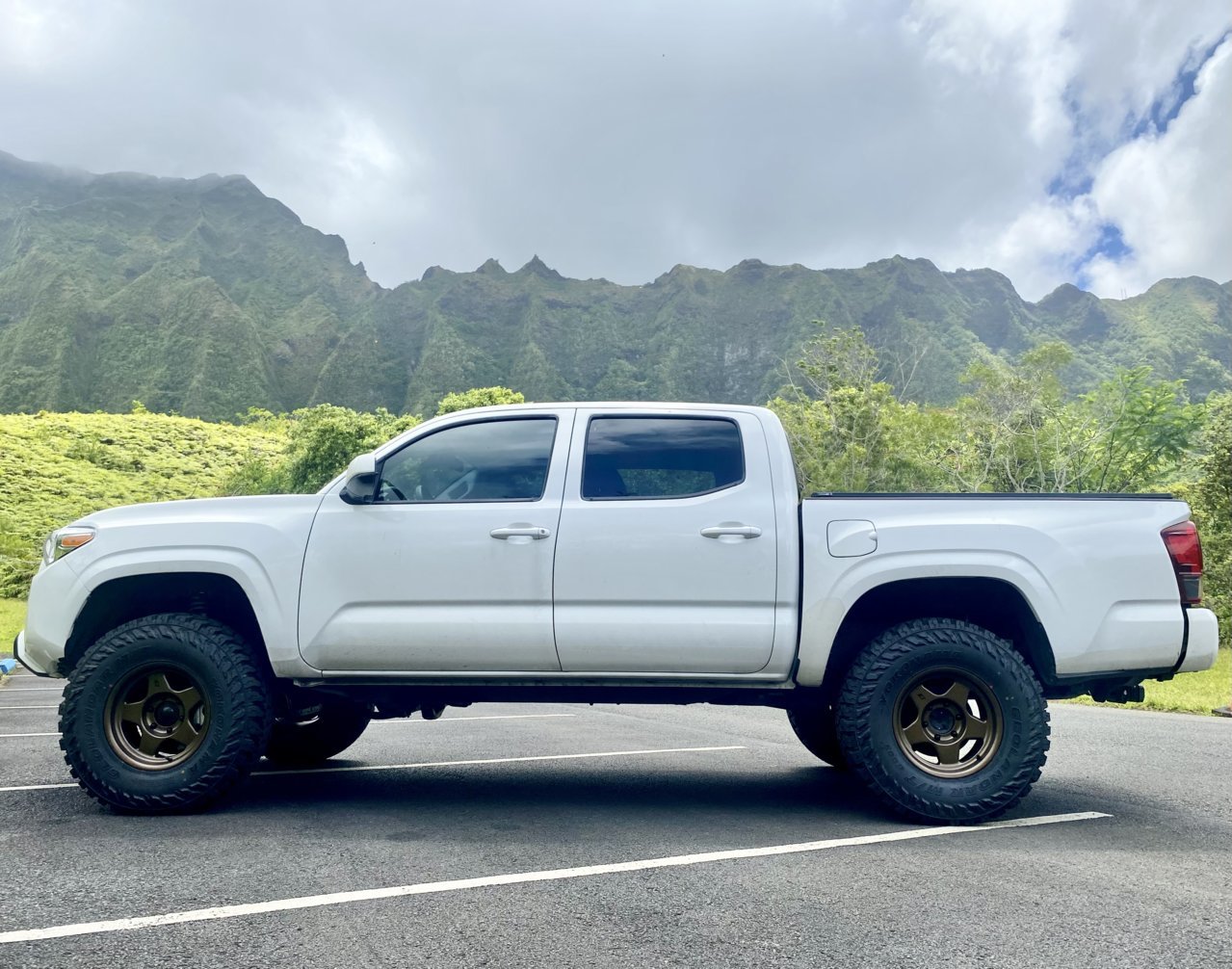

    I run 285/75/16 geolandar m/t on 0 offset scs wheels. My truck is a 4x4 SR which has no fender flares so should have a little more room, and I had to do CMC and trimming. I have SPC UCA and asked the alignment shop to move tires forward in wheel well.
    I do not see how you guys are running this size without cutting. Unless you’re just riding on road? If you go 33s in an M/T just go ahead and factor in the price of the cmc and trimming.

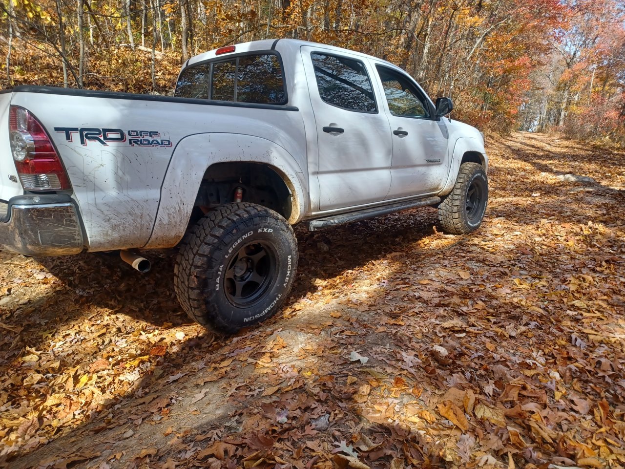

    I have done plastic cutting amd hammered the pinch weld but no cmc yet. I do want to because it does rub at times. Your upper control arms help make the rub not as bad. Some arms will make it worse actually.

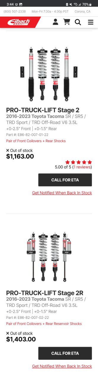

    So let me ask this before i do something foolish. Is this plug and play with no other parts needed? If so i can get this when it comes back in stock and have it installed. Ezpz...:fingerscrossed:
    I have a new 2023 trd sport stock suspension currently.
