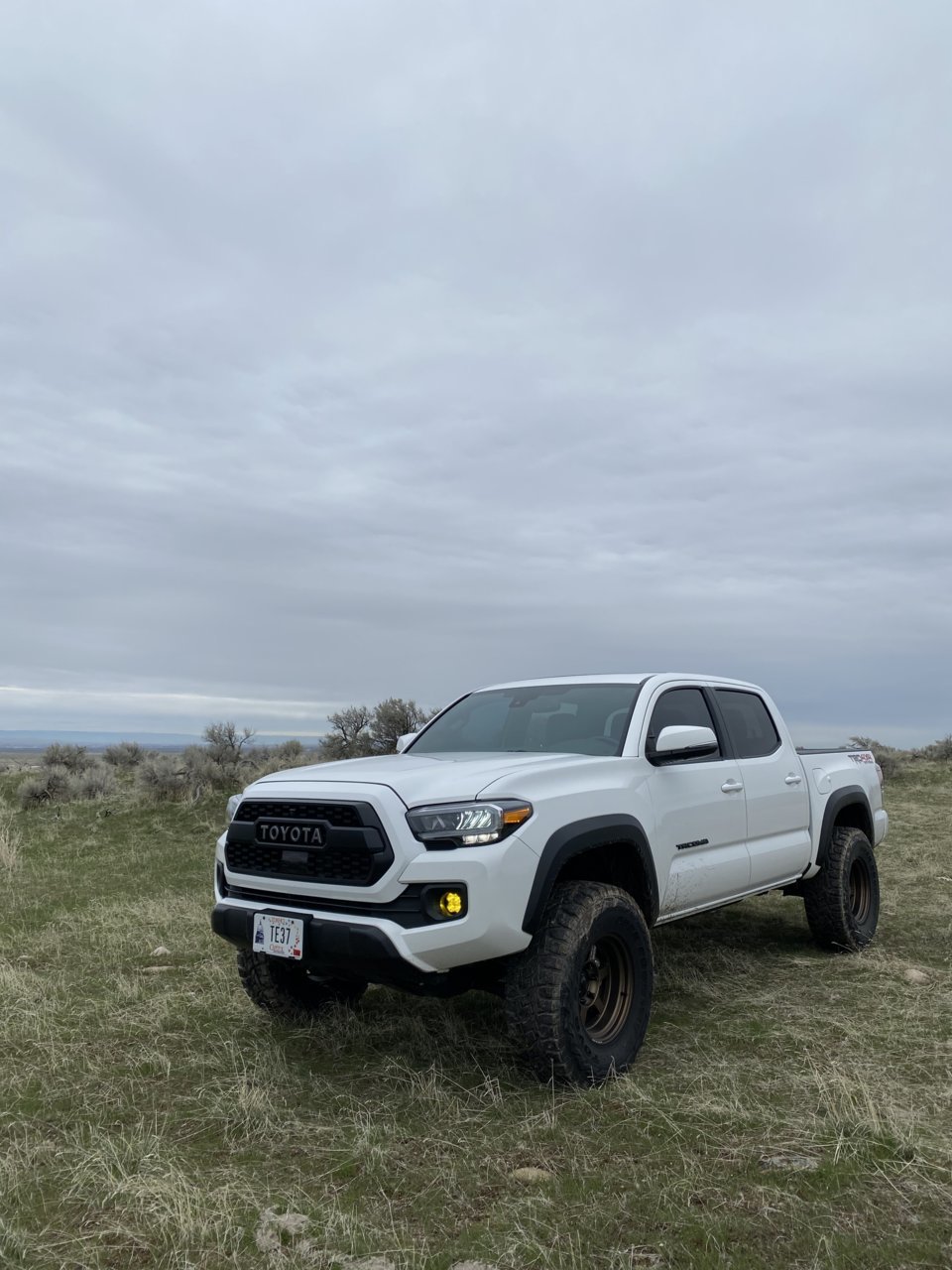

    If anyone is on the fence about this kit just get it. It’s a solid choice for an entry level suspension kit. It gets the job done both on and off road. I’m more than happy with mine.

    @Takosu what size wheel/tire combo is that? CMC?

    16x8 -20 on 285/75/16 Toyo R/T. I am on OEM UCA. No CMC. Installed coils at the pre-set height out of the box. No serious rubbing. Did minor plastic trimming.

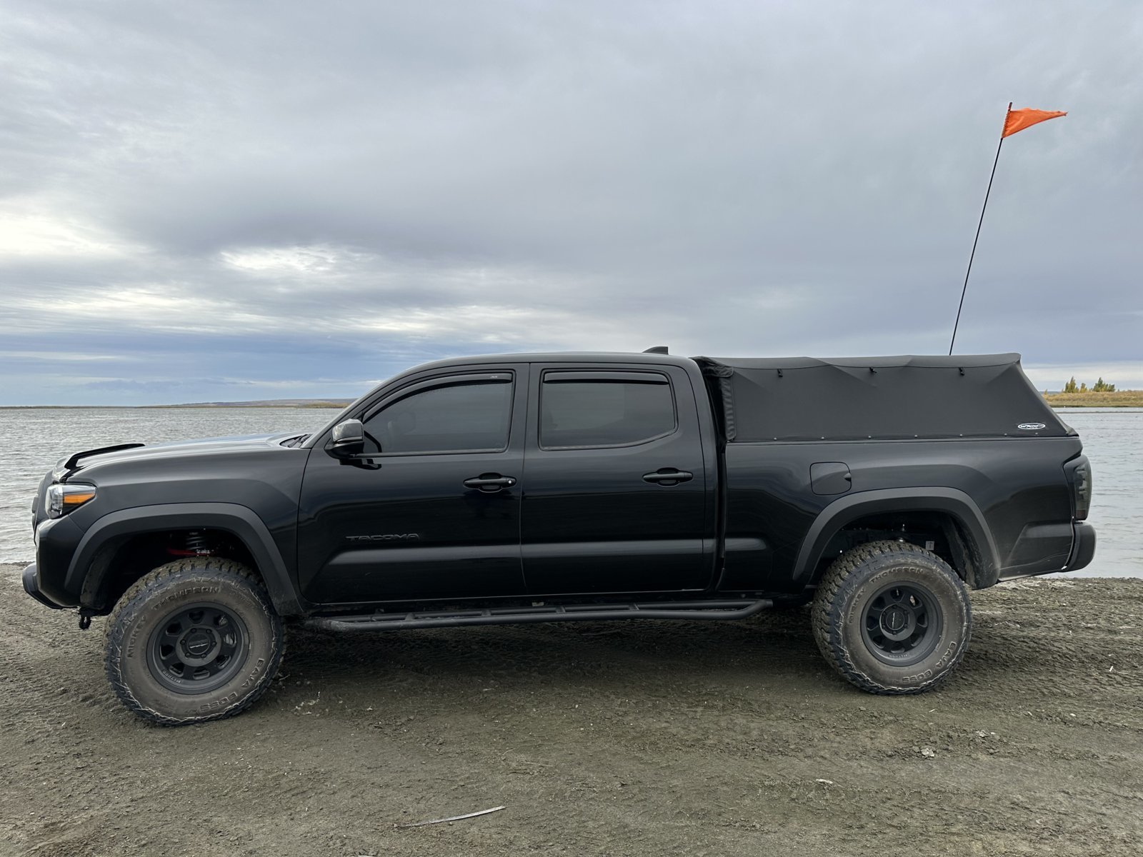

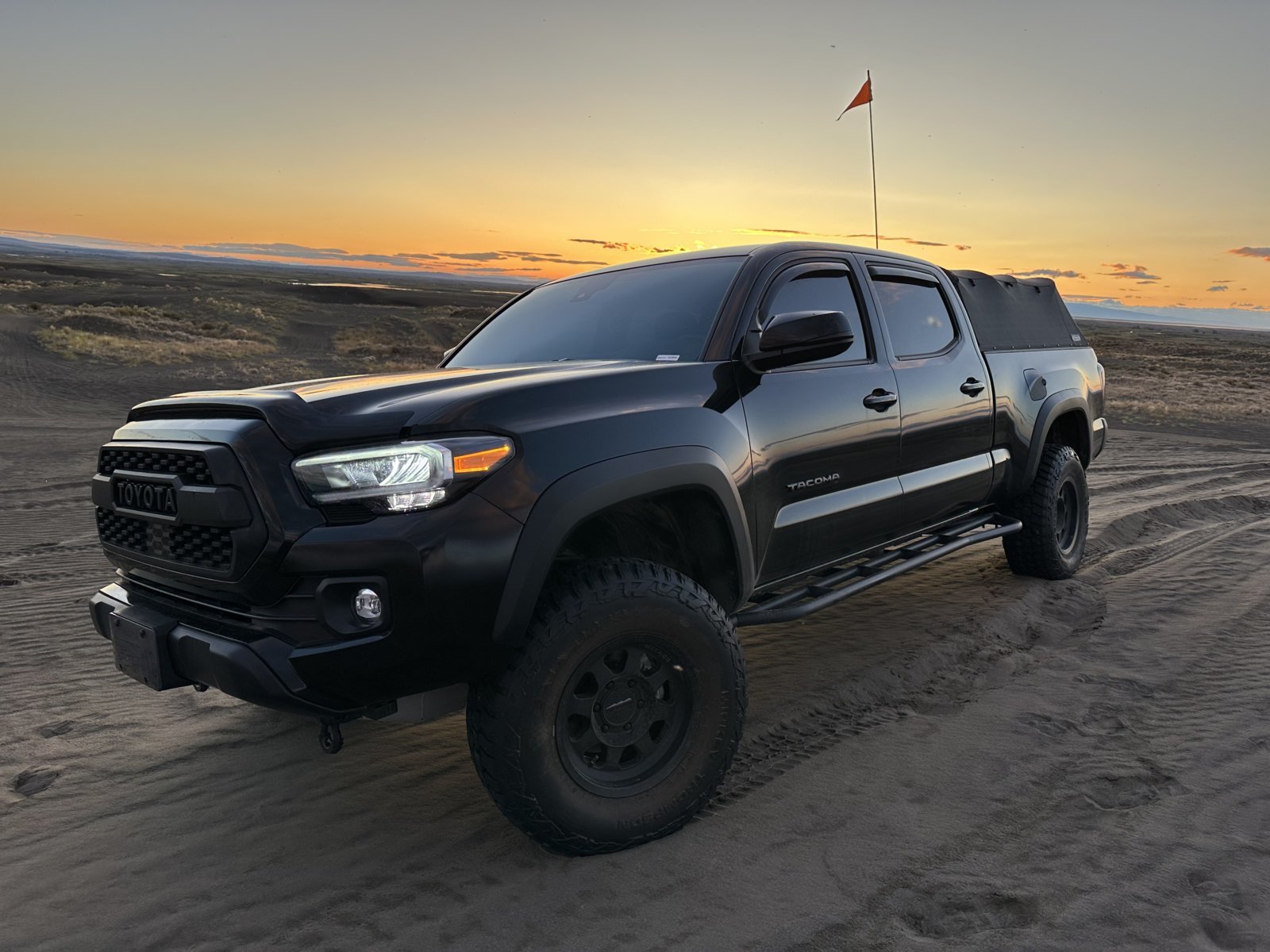

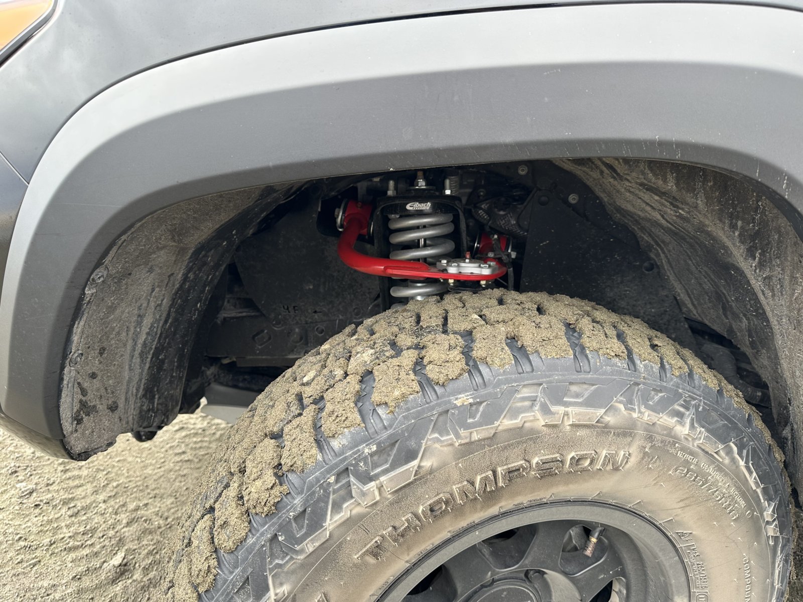

    I love mine! I have the stage 2r and glad I went with this over 6112/5160 because of the adjustability and have really bumpy sand dunes where I live and thought the 6112 would magnify the chatter! I go fast and have even gotten a bit of air! Love this setup! If you get the 2r with resi in back it is linear valved and feels amazing. Looking to upgrade sometime when I have money to 2.5 inch locked setup but honestly don’t need to this setup has been pounded and eats everything I throw at her. These are the best 2.0 money can buy! Eibach 2 3/4” front 1.5”rearIMG_1786.jpgIMG_1786.jpg IMG_1633.jpg
