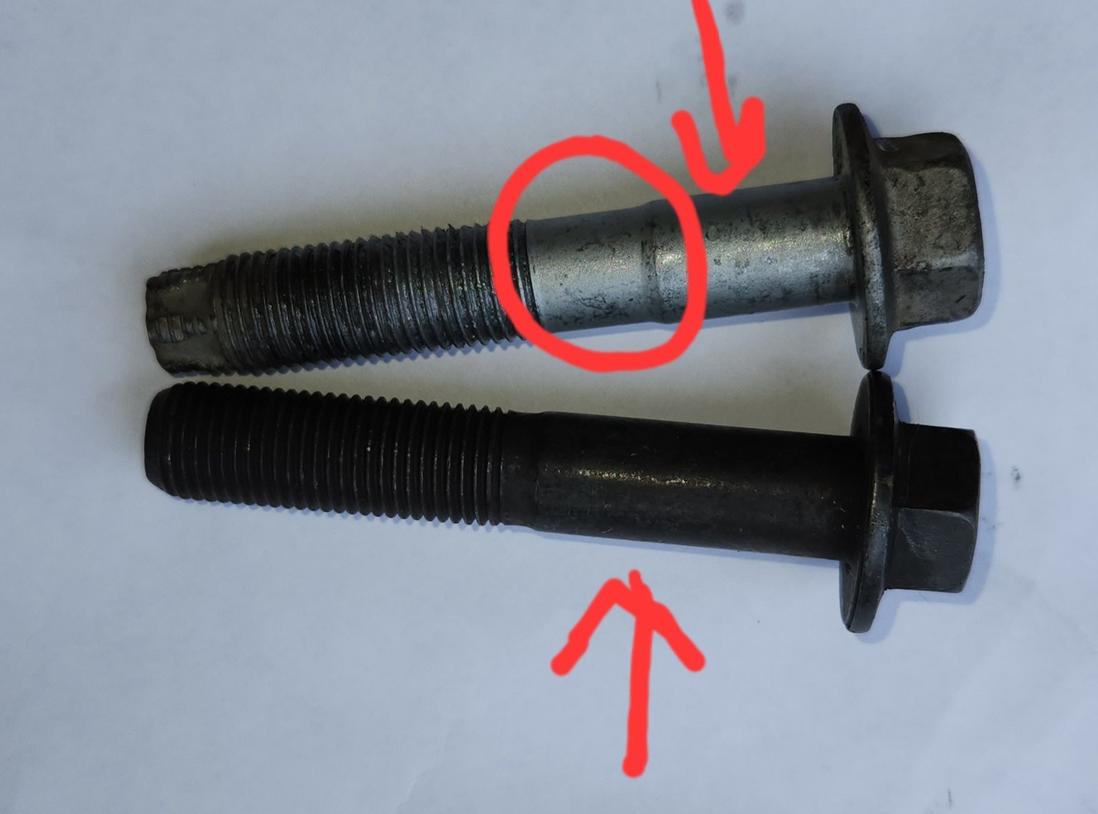

    Say, I got the kit during the cybersale and see these comments about replacing the lower shock bolts with 4R ones. Can someone explain WHY that is needed? I have a 2014 models and if the job requires a bolt upgrade might as well get it done. Thanks for the info.

    If you look at these two bolts...
    The top is the factory Tacoma bolt. The bottom is similar to the 4Runner bolt.
    The unthreaded portion of the lower bolt is thicker, longer before tapering down. There is a possibility that this can cause movement. Most likely from not being torqued correctly though. I did change my bolts but there was zero evidence of movement. And the clicking is still present.

    I installed this kit in April 2021 on my 2014 & didn't replace the lower shock bolts. I haven't had any clunking issues that others have complained about.
