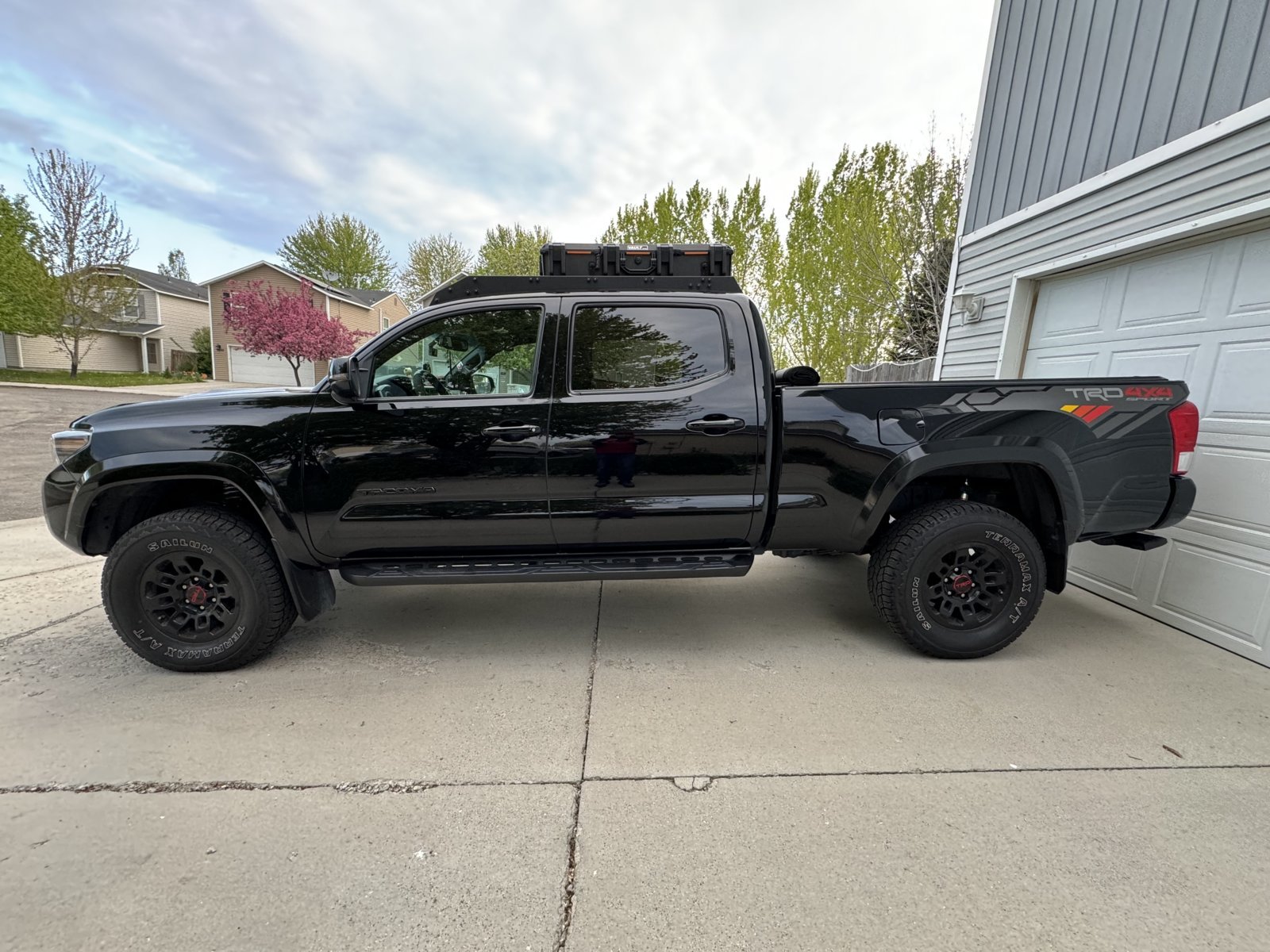

    Hello guys! I'm revisiting the whole clunking issue. Did you notice the clunking issue right away after the install or it took some time before it started the clunking? Just had mine installed yesterday and compared to my bouncy stock trd sport suspension this is a very significant improvement. I have not take it to offroading yet cause I want the suspension to settle in first. But so far I'm lovin' it.

    Here's the before and after pics.

    LOOKS GREAT WHAT SIZE TIRES ARE YOU RUNNING OR PLAN TO RUN

    @JBRAS2022OR Thanks! I'm still debating between KO2 and Wildpeak but leaning more towards the KO2. Any advice? TIA.

    I recently just got the new Wildpeak At4s, absolutely love them! Ride is smooth and quiet, I may be biased now but I also think they look much better than Ko2s, and cheaper! I dont know if this is actually true, but wildpeaks always seem oversized compared to Ko2s in a good way.

    @JBRAS2022OR nice! I will definitely have to check the wildpeak out. I still have plenty of threads left on my tire right now so I have a lot of time to think about it. LOL. Thanks!
