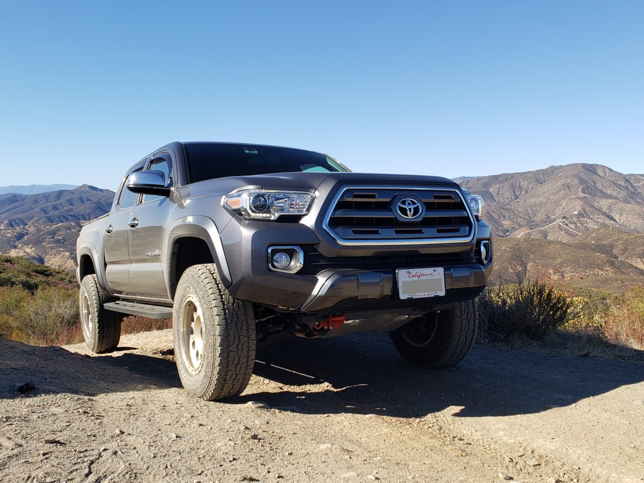

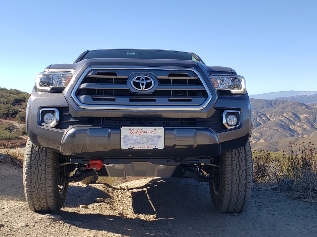

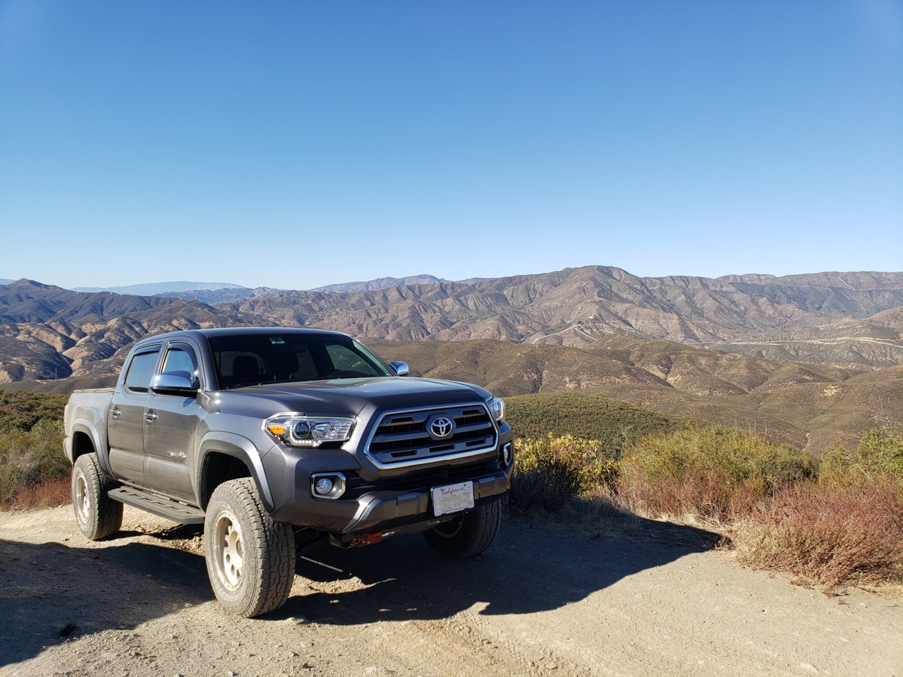

    Installation Complete: Eibach ProTruck coilovers (set at 1.5" over stock) and ProTruck rear shocks with 1.25" rear blocks (while I wait for the HeadStrong AAL to be available again). Rolling on Method 315 Machined wheels with Bridgestone Dueller AT Revo 3 265/70-17. I'm happy with the way it came out. I get my alignment on Tuesday and then I'll try it out on some trails. So far I like the ride on the street... an improvement over stock. Thanks to @PThy for use of his coilover adjustment tool!

    Did some trails today... The Coilovers paired with the 17" wheels and AT tires made a big difference IMO. Very happy with the setup!

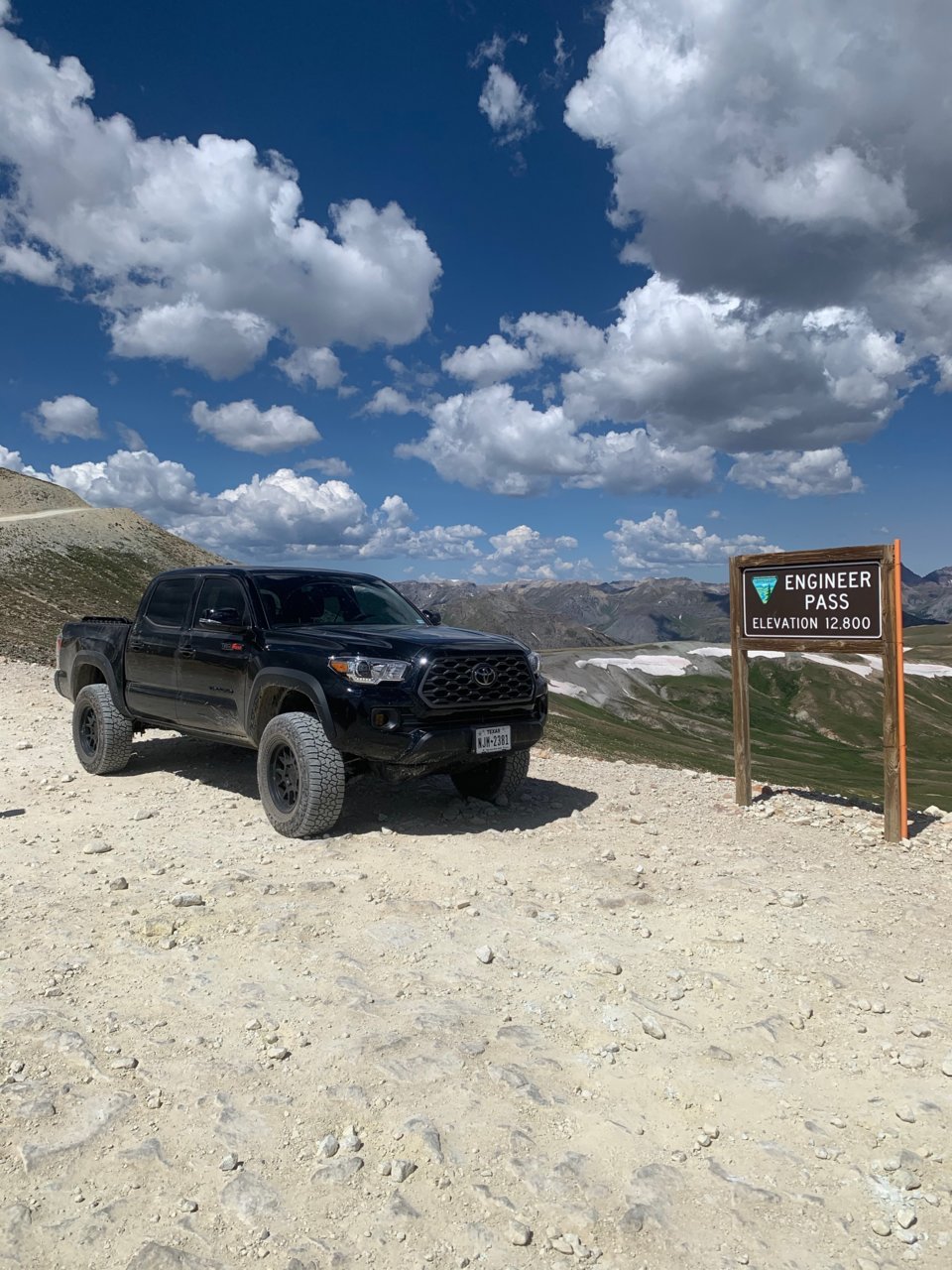

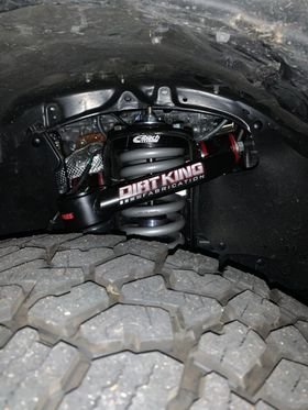

    I installed these back in June, I am running a 1" block in the rear and Dirt King UCA's, Tires are 265/70/17 Falken wildpeak. I have put about 11k Mile on these Coilovers and I am pleased with them so far. Completed a 5k mile trip from Houston to Colorado, New Mexico and Moab, Utah. They handled great on the highway making the 1k mile leg of that trip a breeze. They took the abuse of Colorado and Moab with stride and haven't had an issue with them.
