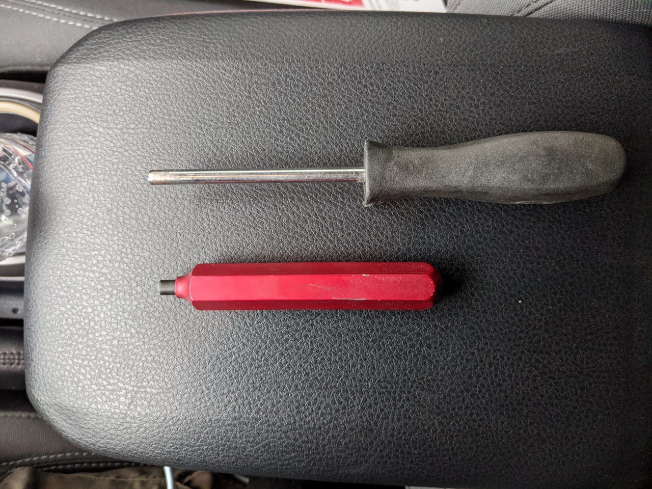

    However... The Eibach 4' tool for adjustment looks pretty and is anodized, however its terrible to use, if not impossible. I was completely unable to adjust the shocks w.o fear of destroying the tool (it is also very loose once inserted). I had to sacrifice a screwdriver so that I had two tools essentially, and used both at the same time to rotate the nut (front end was raised off the ground).
    I saw some pictures of a much longer tool, however that is not what I received.

    Reminds me, I still need to contact Eibach on getting the spanner wrench

    Just a lurker on here. Helped me purchase my 2.0 coilovers actually. It didn’t come with a spanner wrench and saw Mark post on here to contact him. Just got off the phone with him and asked for a spanner and he said they just received their new spanner wrenches and are ready to ship out.
    Only thing he requests is to email a proof of purchase of your order before he ships it out.
