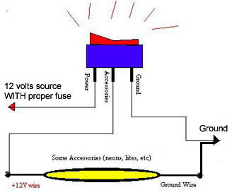

    Pulled the original switch out, looked at the wire diagram again, and got them to work. Coulda sworn I had them wired the same way before, but now it doesn't illuminate. (Using the pic below I have to use the middle pin-acc on that one- and the ground to get them to work. Power and ground lights the switch, but doesn't heat the mirrors. I think there's a resistor between power and acc on my switch so I'm not sure what that causes.)
    It's like this one with different labels for the pins. I hooked up the power and acc pins, but it doesn't light up. If I do the power pin it lights, but the mirrors don't work. Not something I want to leave as I'm afraid I'll leave them on (or the wife will). At least with a bright red light we'd be annoyed enough to remember to turn them off. I have it working for now without the illumination as I don't want to scrape the mirrors again in the morning, but I need to fix this soon.
    Edit:
    der.... :facepalm:
    So I need to run another ground wire. No big deal. Just do it this weekend or sometime this week when I have time.
    Ok, doing it like this might help: (and help others doing this)
