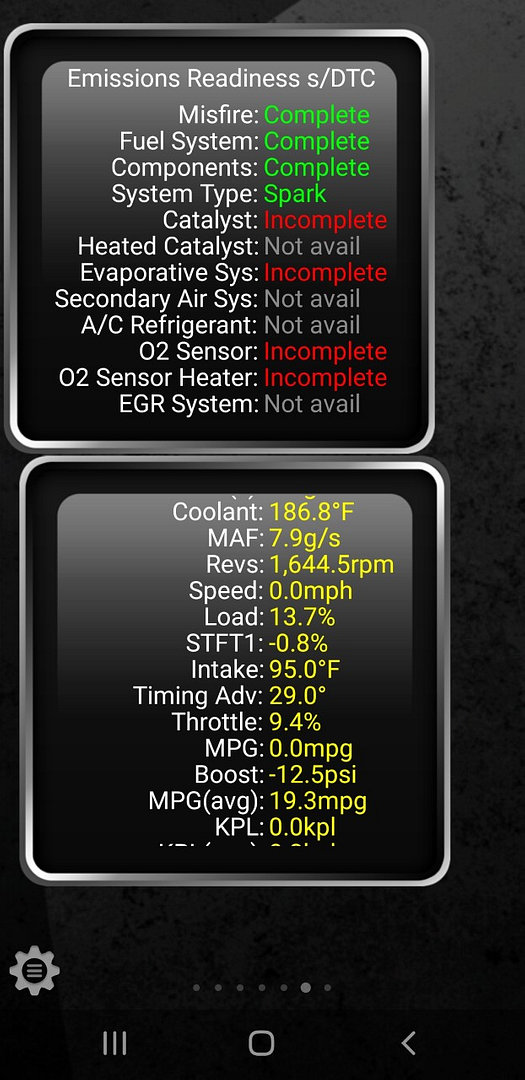

  5. Apr 14, 2020 at 4:47 PM
    #125
    j4roe
    j4roe [OP] Well-Known Member
    Mar 22, 2010
    #33731
    378
    Joe
    Phx, AZ
    1st Gen
    Solo Motorsports 3.5 with heimed tubular uppers, Total Chaos spindle gusset, King 8" CO, Glassworks 3'' front glass, tube bumper, 4 25w 1000L Bumper LED, 2 Rigid Pod lights, 35" Toyo Open Country AT, Fiberworx 3'' Bedsides, Deaver F55, Custom 9" Shackle, Bilstein 7100 14" 2.0 smooth body w/resi
    The two system checks that kept coming back incomplete on my Torque Pro app are CATALYST and I can't remember the other one. Both O2 sensors are checking ok on the OBD2. Now CATALYST says check ok so now it's just one system that says incomplete on start up. Previous to headers everything would come back as complete checks.
    My CEL did come on Easter Sunday on our way out to Sheep Bridge but I cleared the code on the fly and it never came back. I really feel like it's either a bad IAC, worn out throttle body or maybe a vacuum leak in my master/booster area.
    One other note: I have noticed that my MAF sometimes is reading 8 or 9 grams of air at idle and I believe I read somewhere that somebody said 5 grams would be high although previously my MAF usually reads 5 grams at idle...

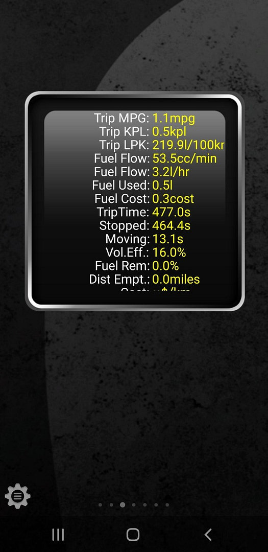

  10. Apr 14, 2020 at 5:38 PM
    #130
    j4roe
    Mar 22, 2010
    #33731
    378
    Joe
    Phx, AZ
    1st Gen

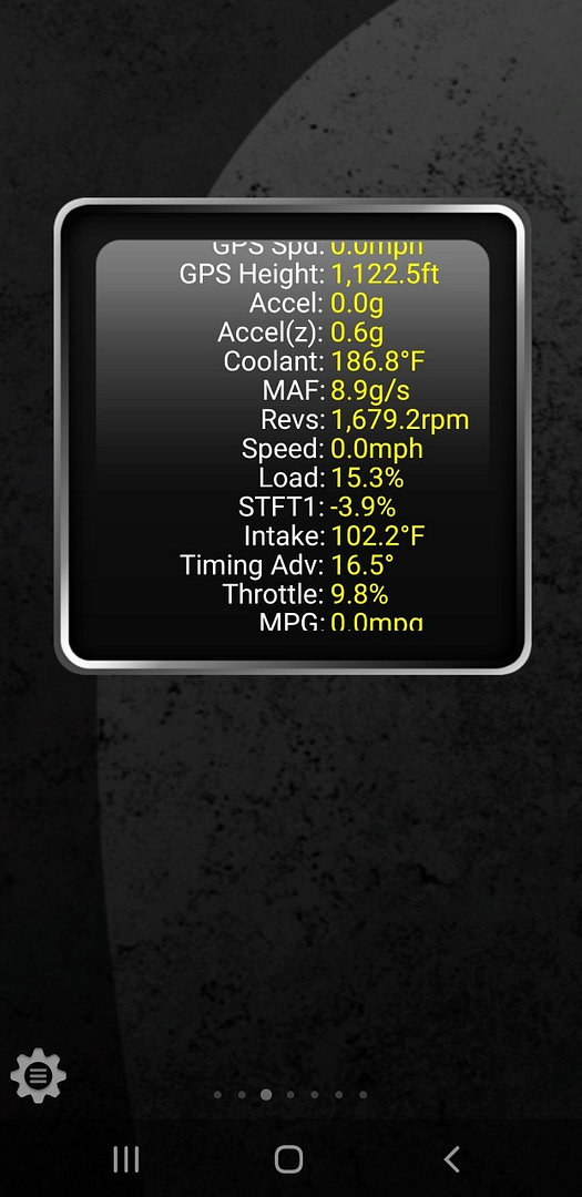

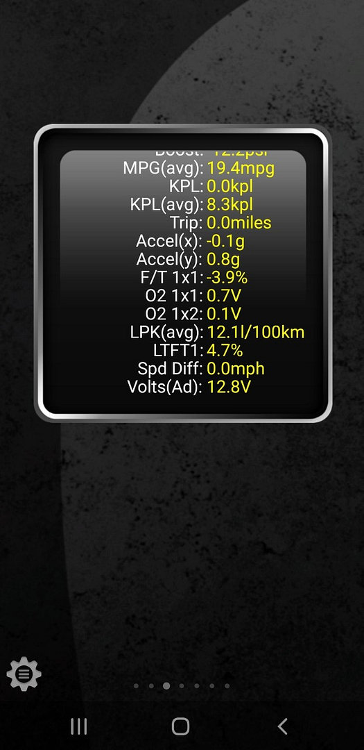

  11. Apr 14, 2020 at 5:39 PM
    #131
    j4roe
    Mar 22, 2010
    #33731
    378
    Joe
    Phx, AZ
    1st Gen
    This data is at idle on Saturday, 4/11

  20. Apr 21, 2020 at 11:47 AM
    #140
    j4roe
    Mar 22, 2010
    #33731
    378
    Joe
    Phx, AZ
    1st Gen
    MAF reading seems too high for idle. What do you guys think?
