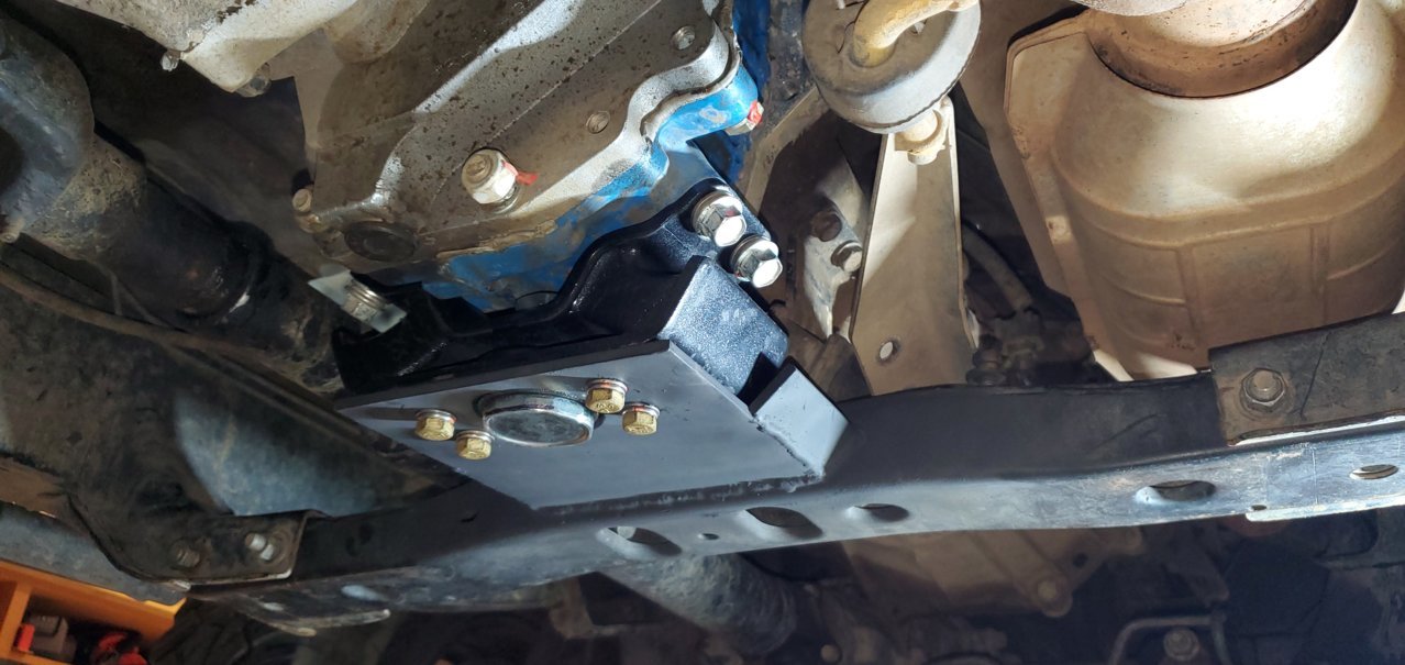

    I just built a transfer case mount off of the existing cross member. I'll post up a photo when I get done working

    I ran this for 5 years with zero issues. Took about 10 minutes of cardboard aided design and another 45 minutes to cut it then weld it up.

    I see... that looks pretty simple. The red mount, is that a manual trans mount?

    I'm pretty sure the plate you made looks like 1/4... is that correct?

    I tried both the marlin poly mount and tg bomb proof one. The Marlin one wasn't as bad, but still much more vibration than I wanted.
    Here's my mount. 3/16 was fine for me
