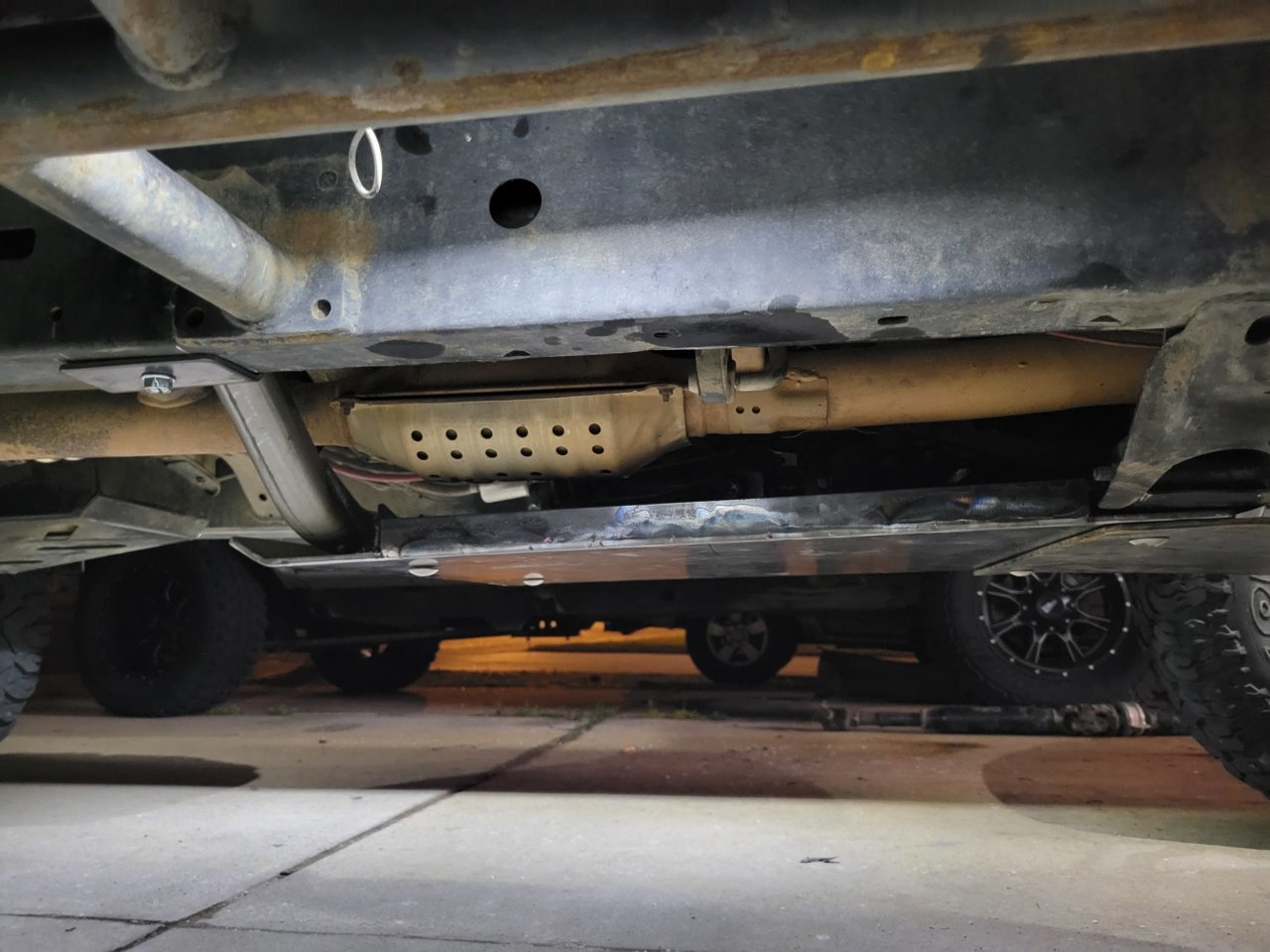

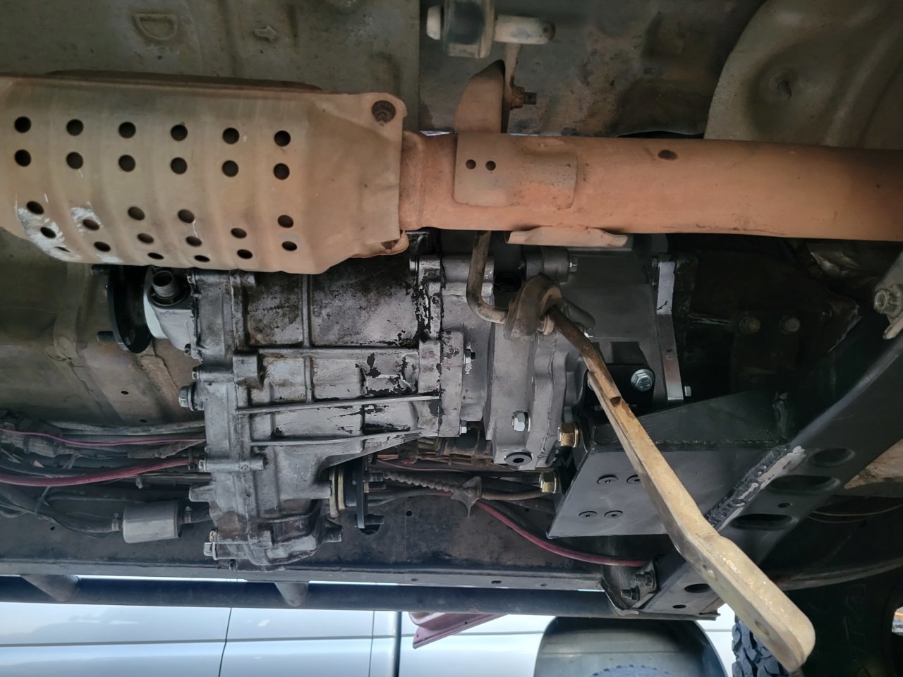

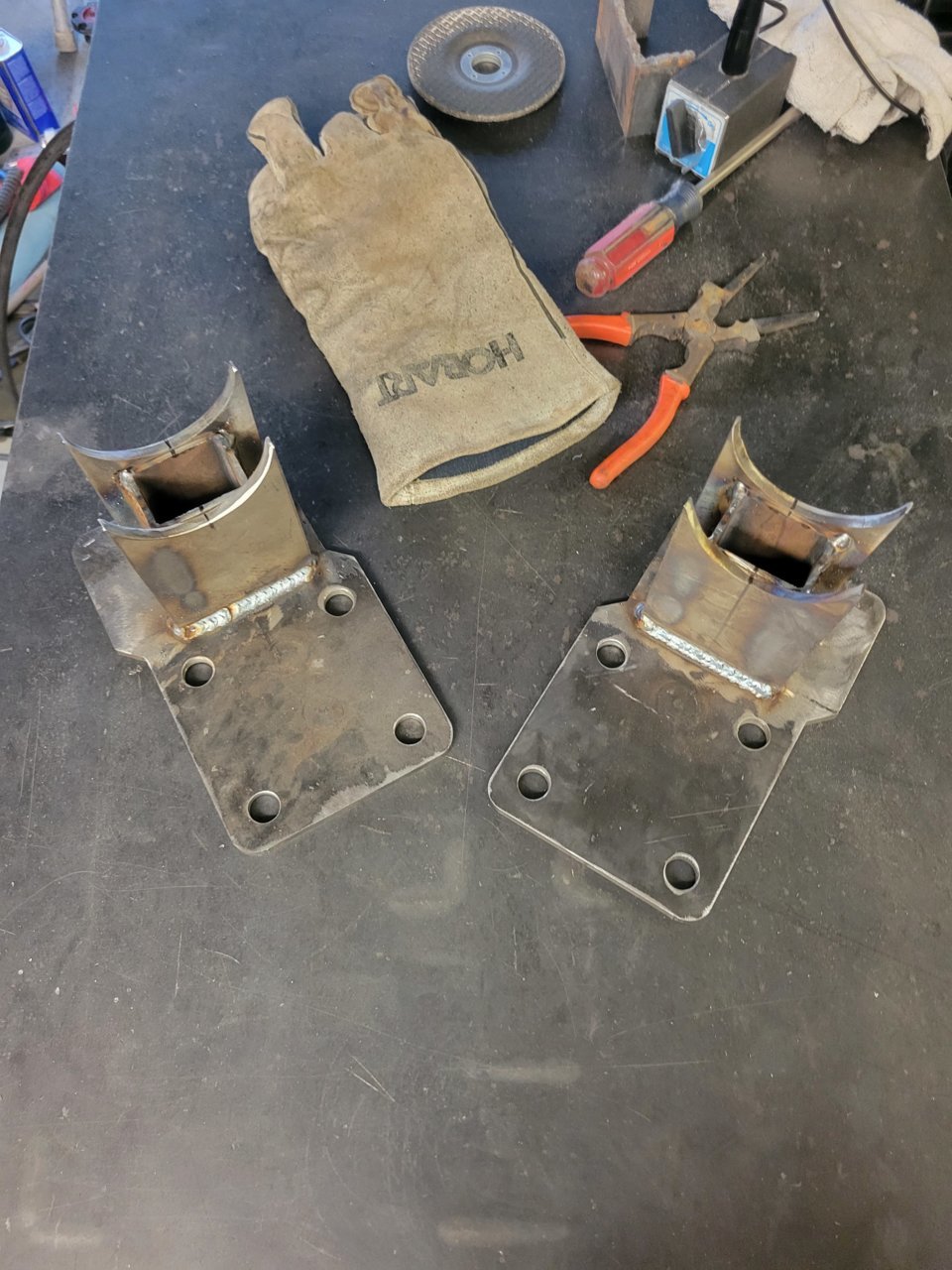

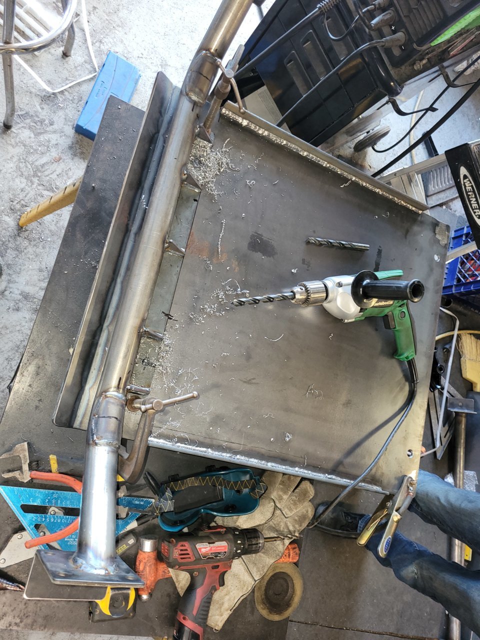

    I mocked them up and shaped the legs to fit before I welded them. They may take some fine tuning, but they are pretty well done.

    Final test fit complete. Just need to take everything off, and paint it.

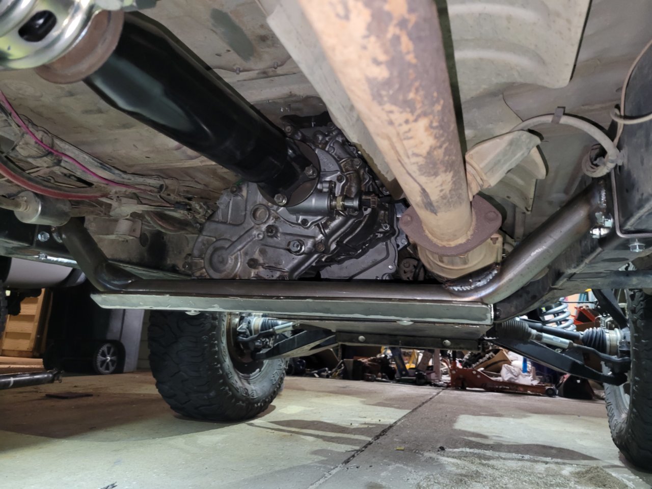

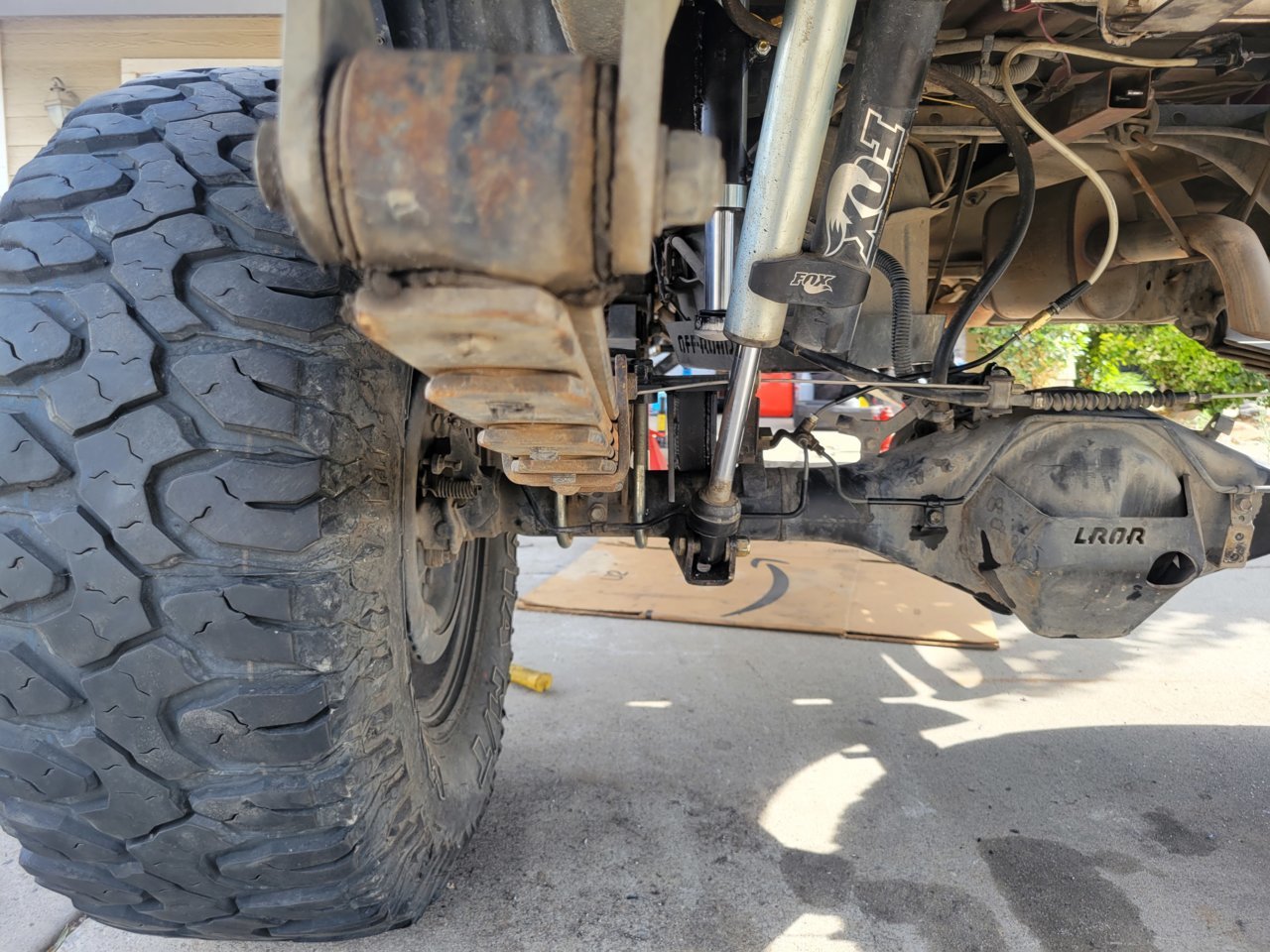

    Well, the back is under it's own weight again.

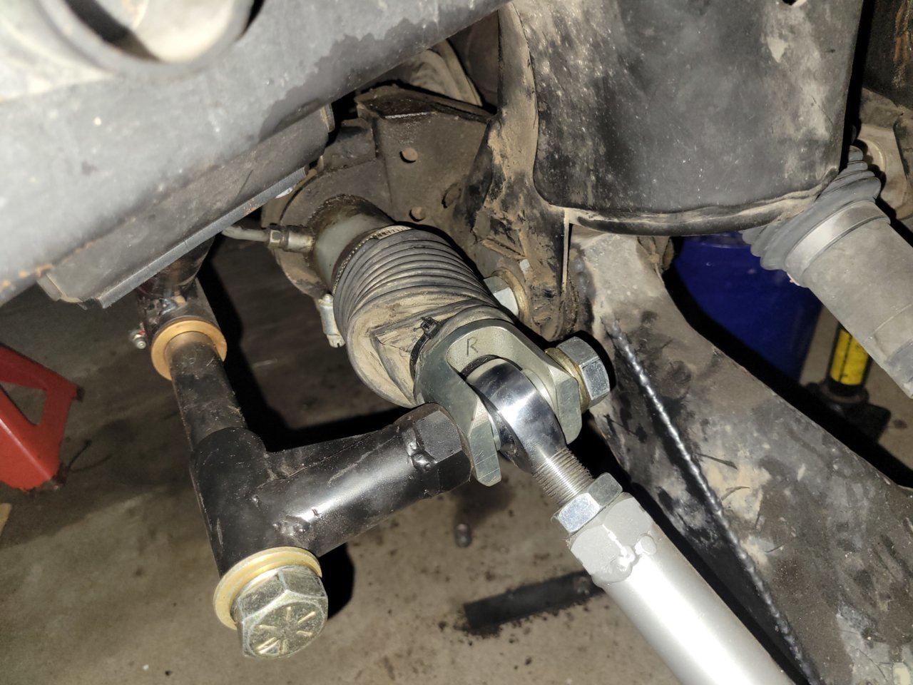

    Not exactly what I want. But the rack shaft has boots on it

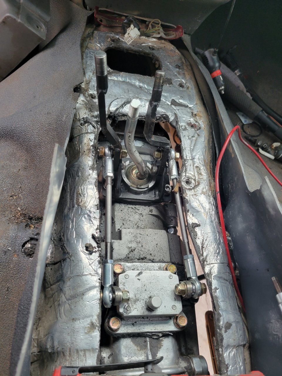

    Re-do shifter for front transfer case.

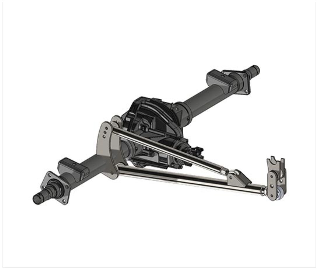

    He means something like this.
    And that is probably what I would use, actually.
    https://www.ruffstuffspecialties.com/R2300.html

    on Matt truck specifically I would say probably off his doubler skid plate
    if done right it could provide a little extra drive shaft protection if he came down onto his driveshaft and probably not give up any additional ground clearance
