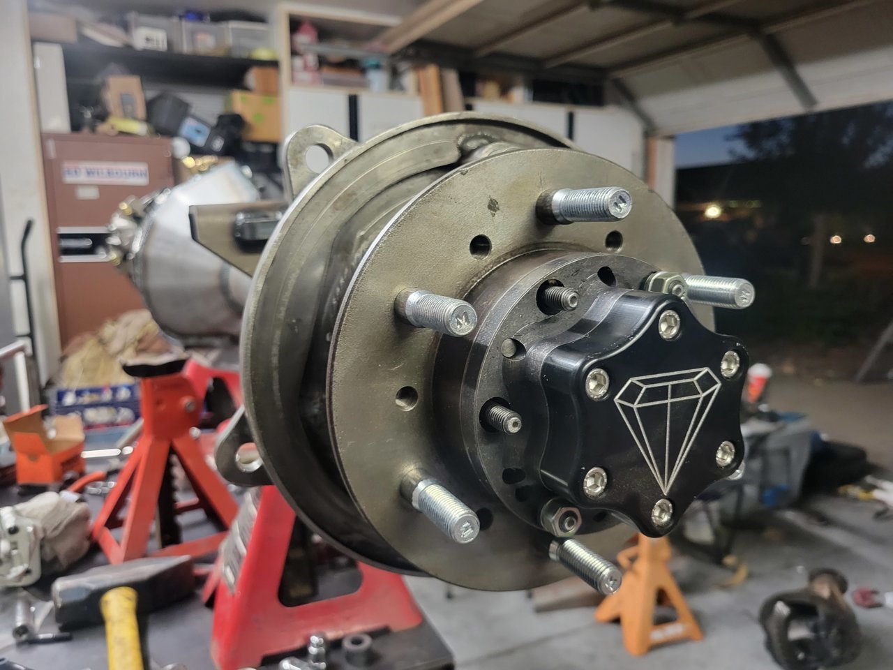

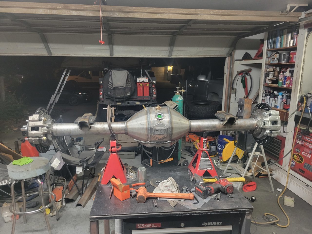

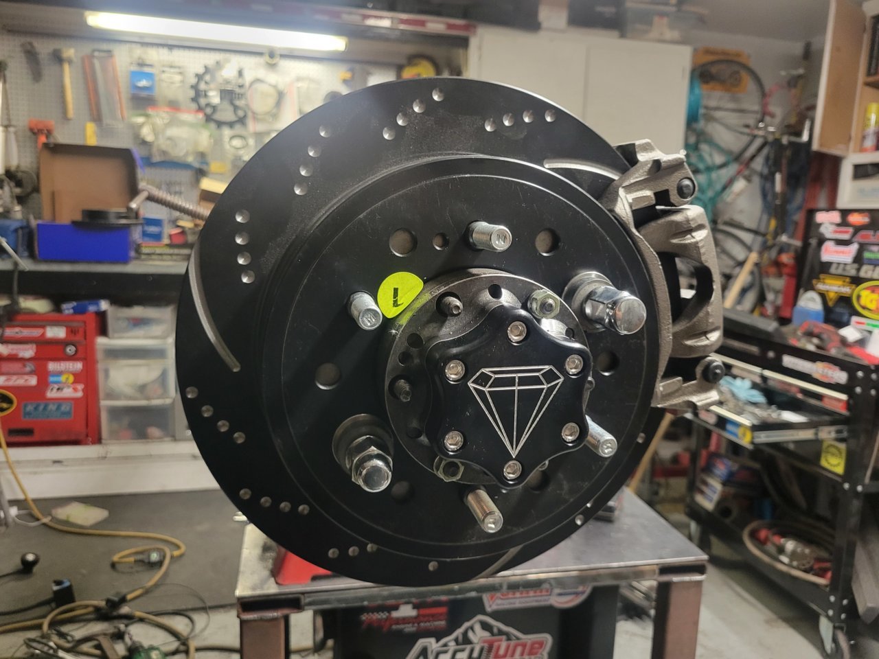

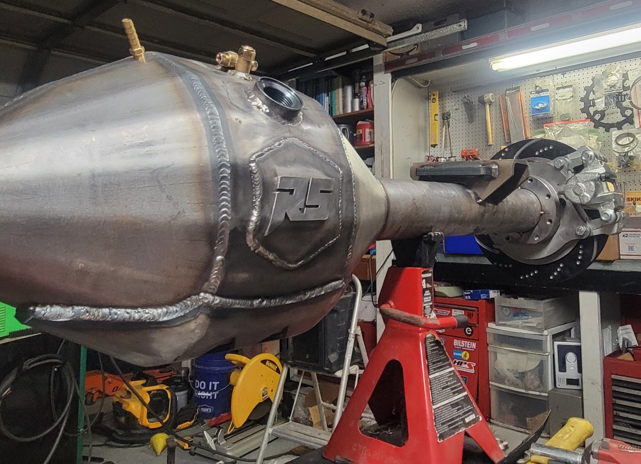

    Axle is dressed and ready to go to the shop tomorrow.
    Got more of the brake fixins. Ready to plumb them after the axle flanges, perches, and truss are welded.

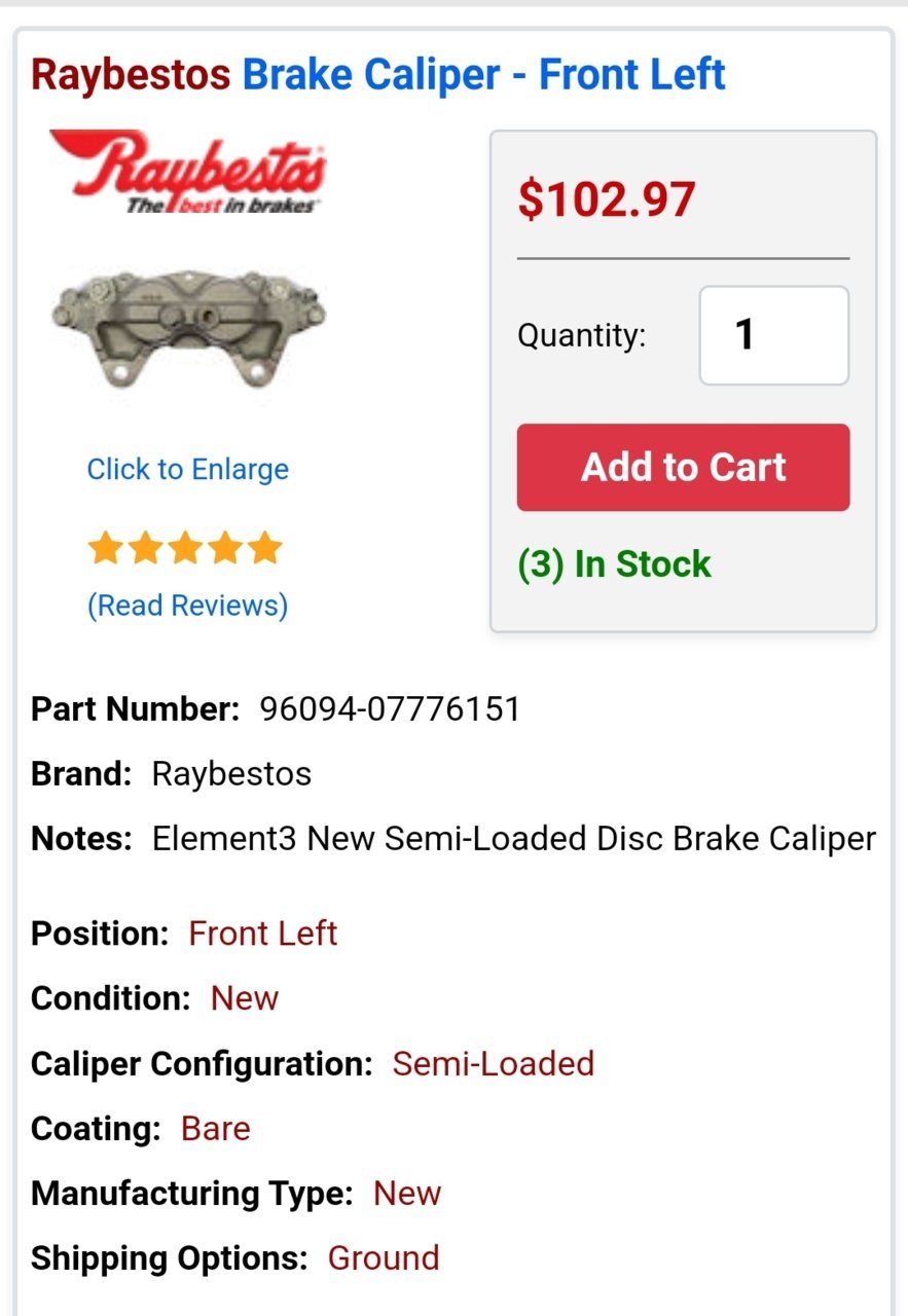

    Ordered GX460 front calipers (14WA). To upgrade over the Tundra brake upgrade.
    (Getting ready to paint the rear calipers, decided I wanted to get the fronts so I can paint them all at once).
    The combination of the Lexus front brakes and 4th Gen 4Runner rear disc should put me at the largest front/rear brakes Toyota has put out.

    Lexus front brakes huh.
    Don't hear about people using those for an upgrade in the front. How much bigger are they than the tundra ones?

    Common swap for GX470's
    The GX460 front brakes are the same as 5th Gen 4Runners (2010-2015 specific for the GX470 swap)

    The rear brakes are 4th Gen 4 Runner brakes. So I can have disc and still have the factory style ebrake (instead of a line lock or some other ebrake).
    I haven't gotten far enough to find out if I need to change the master cylinder yet. I figure I'll get all the brakes done and see how it feels. If it's needed, it will happen. I'll just need to figure out what MC I need to change to.

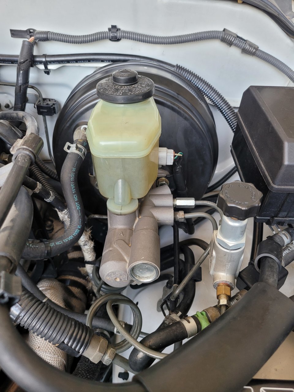

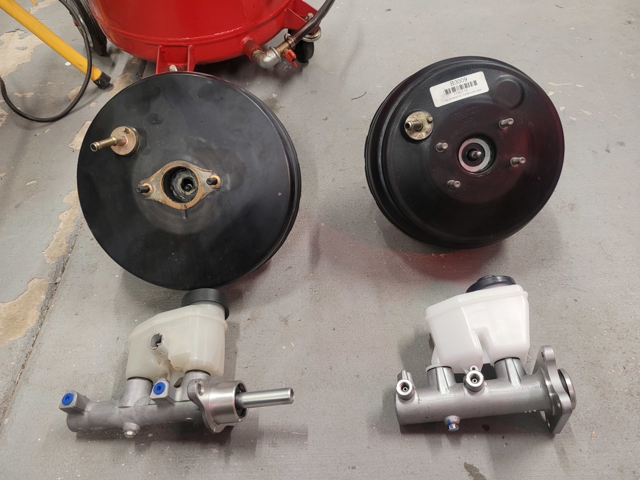

    So after all said and done, it's still a 1"? That's a huge waste of money for the SOS kit IMO. It's way cheaper (by a whole lot) to run a early first gen taco with a larger dual diaphragm brake booster with a 1" MC or even the slightly smaller 4R dual diaphragm brake booster and their 1" MC vs the hype SOS kit.
    Heck, I bought from a local Toyota scrap yard a complete 4R booster/1" MC for $40 and used it until I was able to source a used but larger, early first gen tacoma dual diaphragm and 1" MC for $65 shipped.
    Not to burst anyone's bubble about the so call SOS upgrade

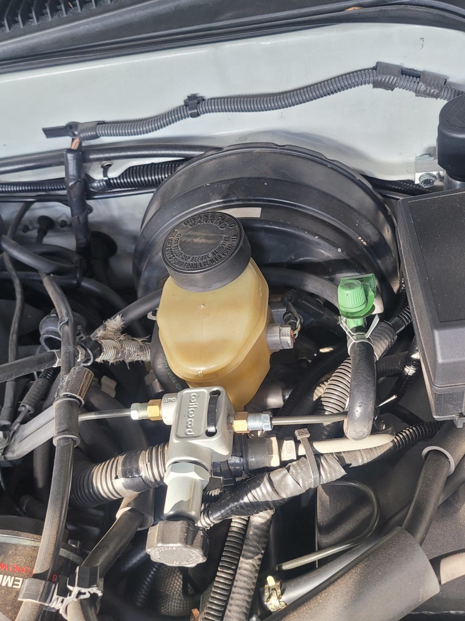

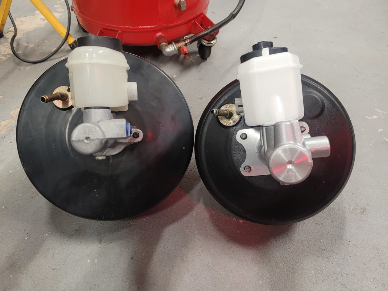

    I bought a 1t t100 booster/1" MC and returned it to purchase the 4R.
    Pic 1 & 2 - late 1st gen vs 1t t100
    Pic 3 - 4R setup in my truck
    Pic 4 - early 1st gen booster/mc in my truck
